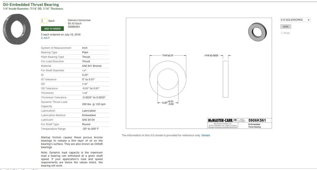

oliver2-44
@damon91  at the hardware store in all the little grey special parts drawers. You can find 2 little brash washers that are Hillman bronze bushing 68087. You can tap 2 of these in the recess at the top of the housing where the throttle shaft comes through. Test the throttle shaft fit. If it is a lillle tight take a 1/4” drill bit and use it as a hand reamer
Kohler also makes a special repair bushing to drive in this recess kohler part #  2515802-5 But they always seem to be out of stock when I try to order them
sorry I countdown find the numbers for my earlier reply
  • Like 2
tunahead72
@oliver2-44 I hate to be a pest, but in the interest of getting the right information out there, can you check the two part numbers you posted?  Fixing a couple of loose throttle shafts is also on one of my lists, so I looked up both these numbers, and they don't look quite right to me...
I searched the Hillman web site for part no. 68087, and didn't find anything.  They do have a 58087, which is a 1/4" i.d. x 7/16" o.d. x 1/16" thick bronze thrust bearing.  Is that the part you meant?
And I believe the Kohler part you meant is 2515802-S, correct?  They are currently in stock at RepairClinic.com, and probably other online places as well.  They're pricey though, about $10 a piece.
