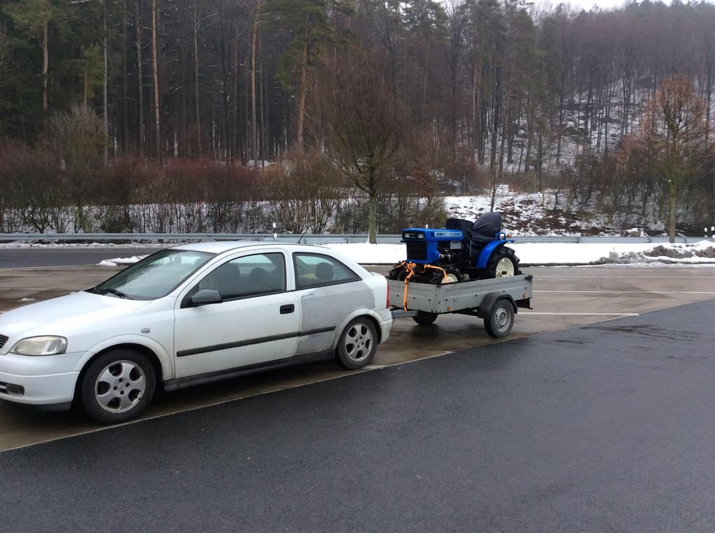

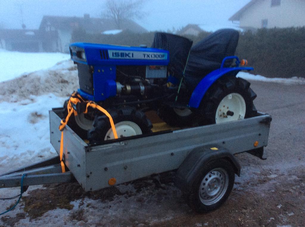

Tractorhead 9,217 #3 Posted February 1, 2019 (edited) About 40-50cm.. did a short Visit for my new "supporter". She is in best Surrounding yeah that.. She is a Made in 1978, complete refurbished and one year warranty. Very good condition, quick start Glowplugs, brandnew Seat whole Gearboxes are checked for wear, needed Parts are changed, new Clutch, all screws are changed... doing today my first Testdrive with her. Dont ask, what Kati, my wife looks- but She knows me.... Edited February 1, 2019 by Tractorhead 1 Share this post Link to post Share on other sites
elcamino/wheelhorse 9,363 #4 Posted February 1, 2019 We can't wait to see your new toy . Share this post Link to post Share on other sites
Tractorhead 9,217 #5 Posted February 2, 2019 Coffeebrake at a "Diner" 3 1 Share this post Link to post Share on other sites

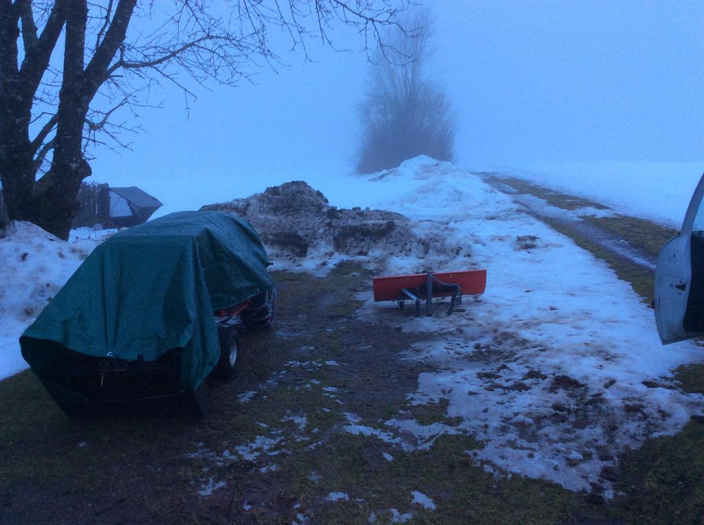

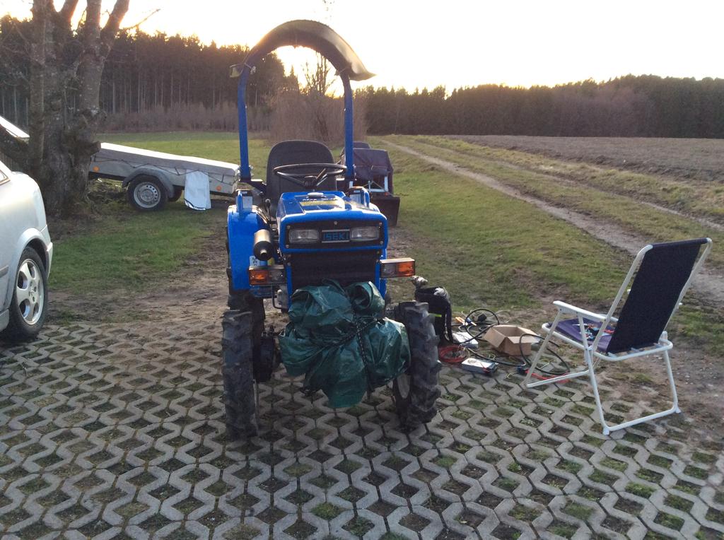

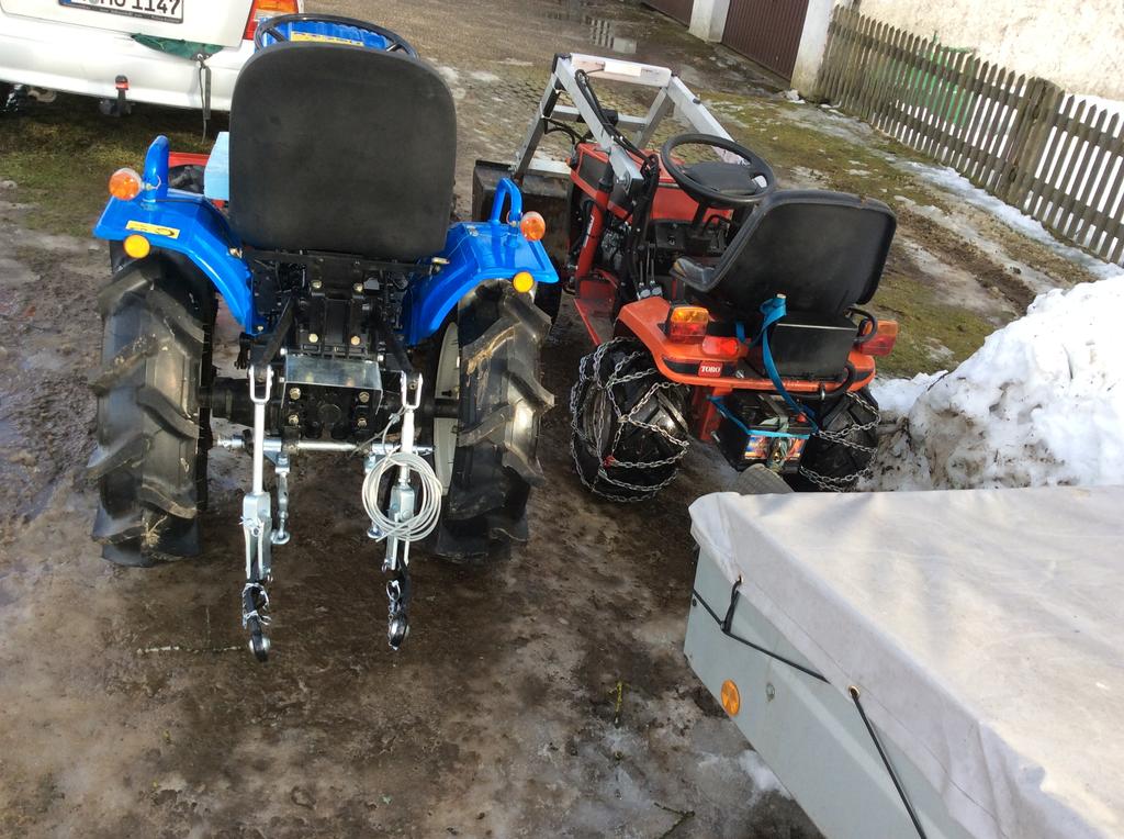

Tractorhead 9,217 #6 Posted February 2, 2019 (edited) Home sweet Home... here we are, the Beauty's and the Beast.. Honestly sorry, i forgot who are the Beautie and who's the Beast.. Plow Shield prepared, but actual no mounting Hitch. maybe i build tomorrow, otherwise my Workhorse is still Covered and also wait for Action and Seat- Time. Still in Parking lot. Fog comes up, temps are falling... Edited February 2, 2019 by Tractorhead Added text below pic 2 1 Share this post Link to post Share on other sites
Stormin 9,988 #7 Posted February 2, 2019 Very nice. Good for another 40 years now. 1 Share this post Link to post Share on other sites
Tractorhead 9,217 #8 Posted February 2, 2019 Yap, save the horse for Work it was build for. Nevertheless it have to do it's work. FEL will still being kept for some easier purposes, like lift Leaf- collector over the fence and similar. Share this post Link to post Share on other sites

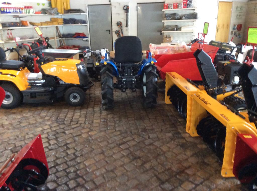

Pullstart 71,142 #9 Posted February 2, 2019 I'm glad You got it home safely, Stefan! How about some side by side comparison shots between your Iseki and your Horse? 1 Share this post Link to post Share on other sites
Tractorhead 9,217 #10 Posted February 2, 2019 I will do tomorrow, now it's bit too dark.. 😎 I'm so exciting about my little Machines. 1 Share this post Link to post Share on other sites

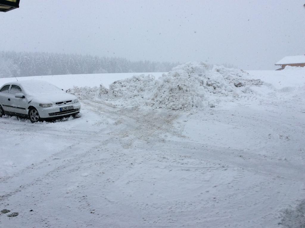

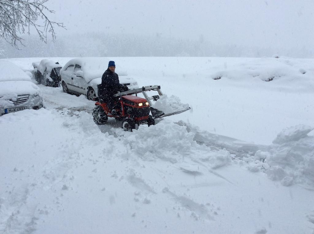

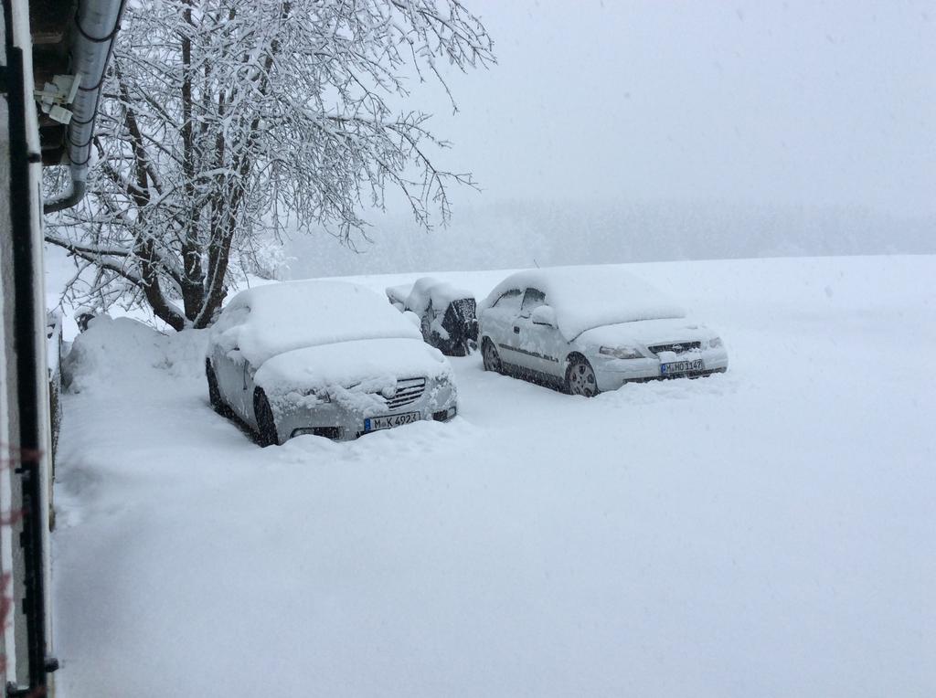

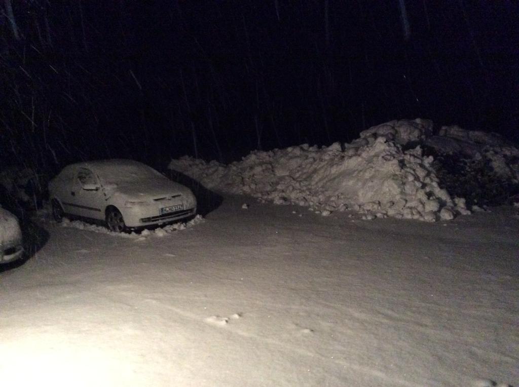

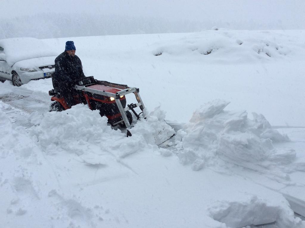

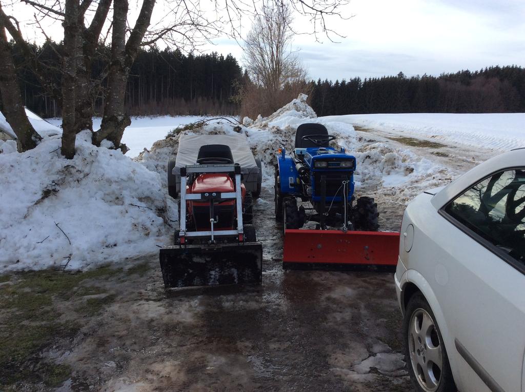

Tractorhead 9,217 #15 Posted February 3, 2019 Let's plow a bit... after a small Breakfast we have a look outside... ok, just a bit Snow..😎 Kati tries to shovel but it was wet Heavy Snow. The max. She can pull the Shovel... let's start the Engine... aaaaaaand Plow with the FEL... did i told you fellas, i love my Wheelhorse. here you can see it in Action.. finaly my Horse made it's job as usual. after space running out, the Neighbour comes with his huge Fendt and cleans my Mountains, but my smyll FEL builds immediately new.. today's count 40 Shovels until now, and it still snows continousely. 5 4 Share this post Link to post Share on other sites
ztnoo 2,302 #16 Posted February 3, 2019 How much snow did you get? What does it measure in height? Share this post Link to post Share on other sites
Tractorhead 9,217 #17 Posted February 3, 2019 First plow in the morning was about 30cm second plow about noon ca.15 cm another plow actual another 15 cm and it still snows... Interrupt to count how many shovels i moved... but it was much.. Several Trees lost several big branches, the snow is too heavy.. 1 Share this post Link to post Share on other sites

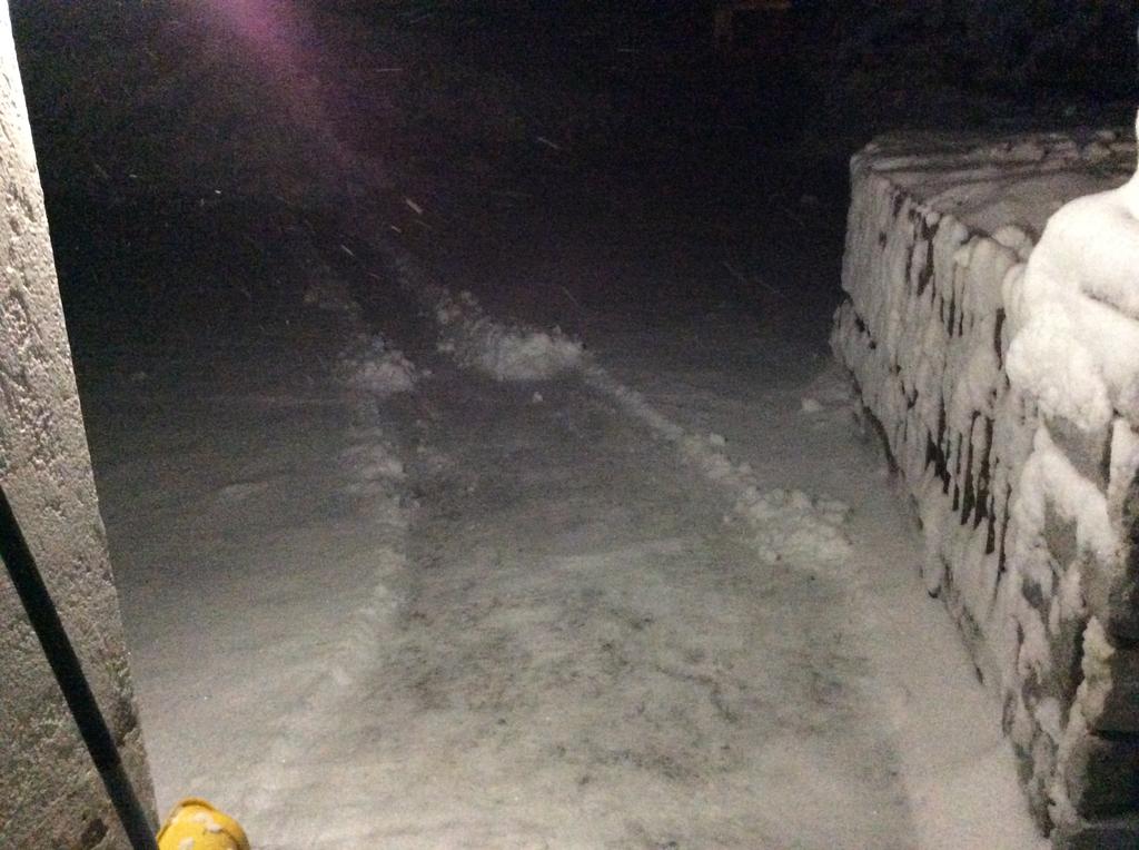

Tractorhead 9,217 #18 Posted February 3, 2019 After 50min.... 1 Share this post Link to post Share on other sites

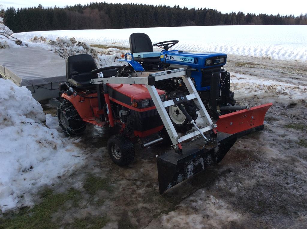

Tractorhead 9,217 #19 Posted February 4, 2019 Theoretically it was time for a Pic. yes in theorie, but i forgot to Fill some Diesel in my Supporter, firstly it do a small testride in the Fields, to look how it goes into deep Snow without Chains. I was amazed, 4WD and diff lock is absolutely amazing.. but short befor i was back, it runns out of Fuel.. 😎🙄 i must recover it from an unpleasure Stay. if i finished, it was to dark to make a Pic. Have to put it beside, because our Neighbour wants to move the mass of Snow further in the Fields and he was take care not to hurt my loved Machines with his Big "Monster" Honestly it was sure a funny Pic with the small Horse pulls the bigger supporter... It's not moving fast, like more a "try to dig" with it on Hook but finally my little Horse Managed it. i'm proud of my Horse and the Engineswap was a perfect decision. ok, tomorrow i must kept some Fuel, once Diesel for the supporter and Once Super for the Horse... - have bad taste about bleed the Diesel... damn.. 🙄🚜😢🤔 3 Share this post Link to post Share on other sites

Tractorhead 9,217 #23 Posted February 11, 2019 (edited) Did first time a "Plow- Job" with the Beast... ok, honestly my quick and dirty solution does not last long at that little Monster. Today my Snow- Plow was the Dead for the quick and dirty mount... Because i'm in a hurry, i didn't take a photo today from that, but one thing is absolutely clear: I have to massive improove the whole shovelmount and need at least 2 Garage door springs to keep the Shield in Place. i stiffed the Shovel with 2 angle irons with 3mm thickness and 30by30mm - They now bent...😳 I plow the whole Snow out in the Fields to the Other Snow. This beast scrap down until ground, a force i didn't realize, it will happen that strong. changed 3 Times the Steelrope i misused to lift the Shovel (ripforce garanted 300Kilo) 😳 Because the spring was to weak and the rope was the spring for the shovel to prevent break. On my last Test today, i pressing the Snow with full force, to the other on my Field until all Tyres begins to dig. i wanna see what Power that Beast really has. Let me say that way - it was more than enough.. The whole mountpoint in the Front i misused was from a MAN Truck a Fuel Tank mount from Steel, that lasts, but the rest looks like a funny installation by an artist. After that test 2 things was clear, 1.) the new FEL will be made of Steel, definitely. 2.) i have to retink some things i planed, to make more solid. Edited February 11, 2019 by Tractorhead Addons 2 Share this post Link to post Share on other sites

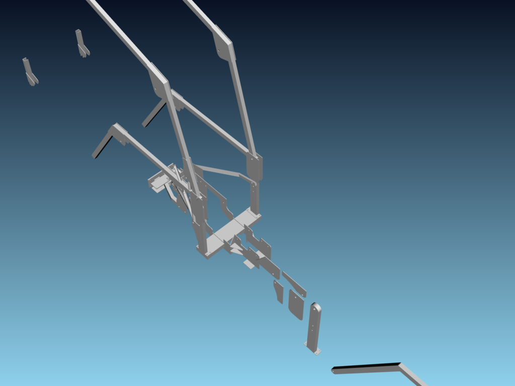

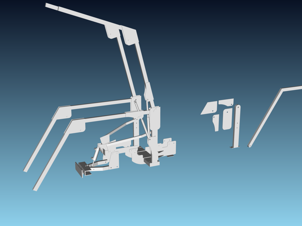

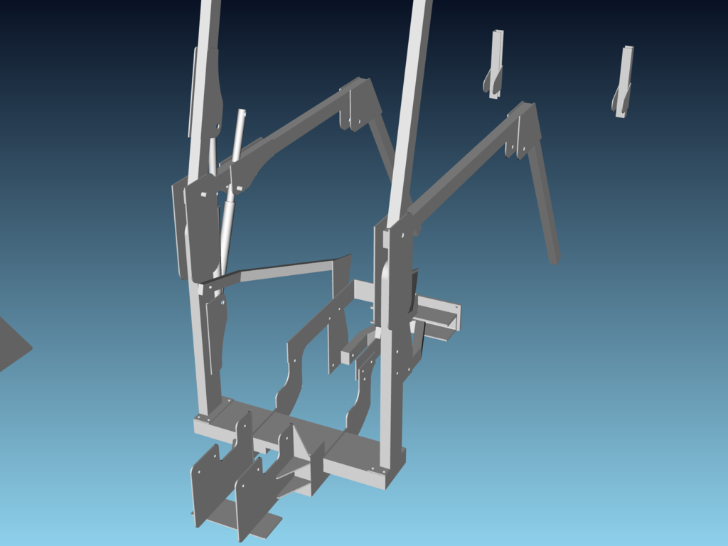

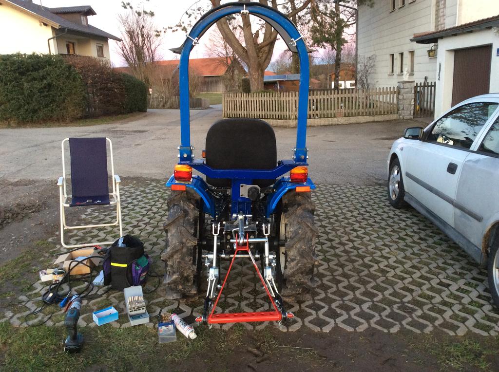

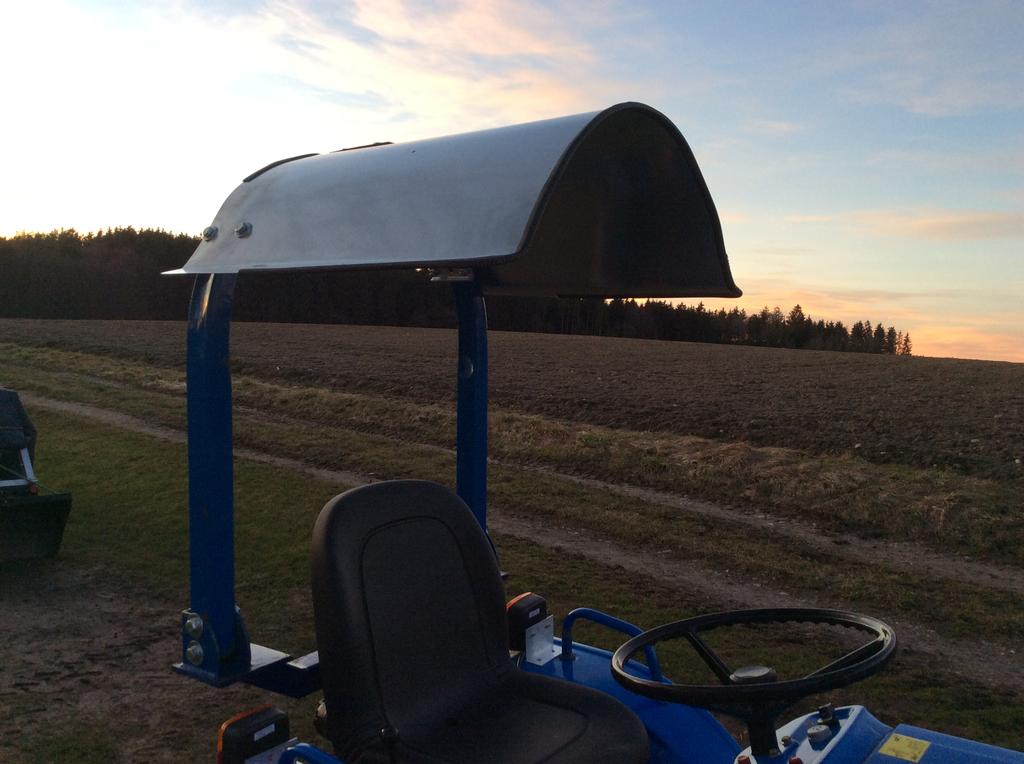

Tractorhead 9,217 #24 Posted March 9, 2019 (edited) So, an update... my Plans for the new FEL are nearly finished. Actual i have few troubles with my Back, so i can't continousely work on my Supporter. CT shows, i have a light rip in my spinal column, nowbody knows where it came from. No accident was happen, witch can causes that, so i'm curious about. Let's see the Doctor on Monday, and find out, how we can solve that issue simple. Operation was absolute no option for me. On the other hand i was strong in business the last weeks for 2 Fall's and didn't have much spare time. i collect some Material for the Build and do a lot of calculations ahead for the dimensioning I also spend the Supporter a R.O.P.S. Because i don't want to roll over with This Tractor by 530kilos. This is still on the Way. The Arms will be made of Carbonsteel in 60x50mm 4mm thick. The MountBracket arms will be made of Steel in 80x50mm 5mm thick The mount Bracket to the Tractor self will be made of Steel 6mm thick. the tension Struts will be made of Steel in 40x20 4mm thick. Additional there will be a support to the rear Axle, to release and enhance the Clutch Case. This will be all in all a damn Heavy Beast when it is finished The angleimproovements and Mountingpoints will be made of 5mm Steel with sleevings. Here i still waiting for my ordered Steelplates 5mm and 6mm, a fiend has ordered. But while i'm not i. A hurry i can save some Money. Diameter of the Mountingpoints is actual set to 19mm Diameter but will maybe enhanced to 25mm. not while i fear it wan't work or last, just while 25mm parts are easier to get. It is more than oversized i know, but i want to build it just once for eternity. The whole concept is now precalculated for a max Weight with 300Kilos on the Shovelmountpoint. The Hydraulic cylinder i'm try to implementing, will be recalculated, if the Mount Bracket and the fork self is finished. i'm thinkering about single or doubleactions for the Lift. Additionally i think about an Quick changer Front end. but this bring also some additional weight... about the Steering i thinkering for a 4 Way doubleaction system, so that i can also use several hydraulic addons. 2 more spare hydraulic circles with quickmount ports seems a good idea to me. So i can also use them for a hydraulic Snowplow with hydraulic Anglesteering. another idea was a changeable Hedge trimmer, with a hydraulic steering (Hydraulicmotor for the blade and Angleswitch) Oh, forgot here's a Pic to give you an idea, what i planing.. Edited March 9, 2019 by Tractorhead Added pict 2 Share this post Link to post Share on other sites

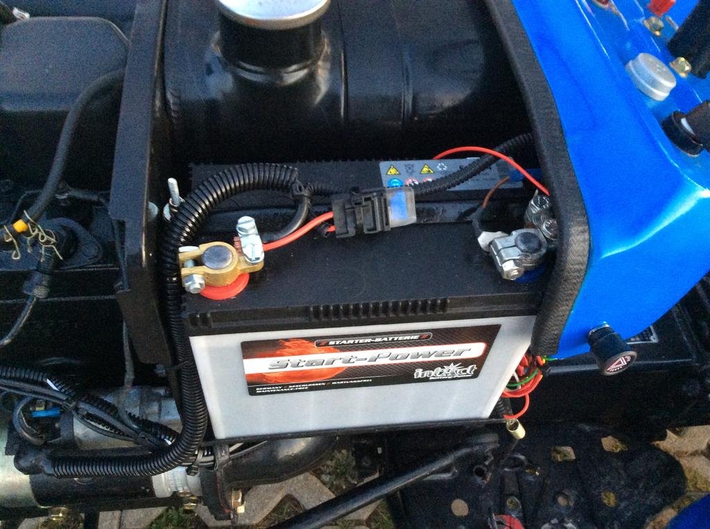

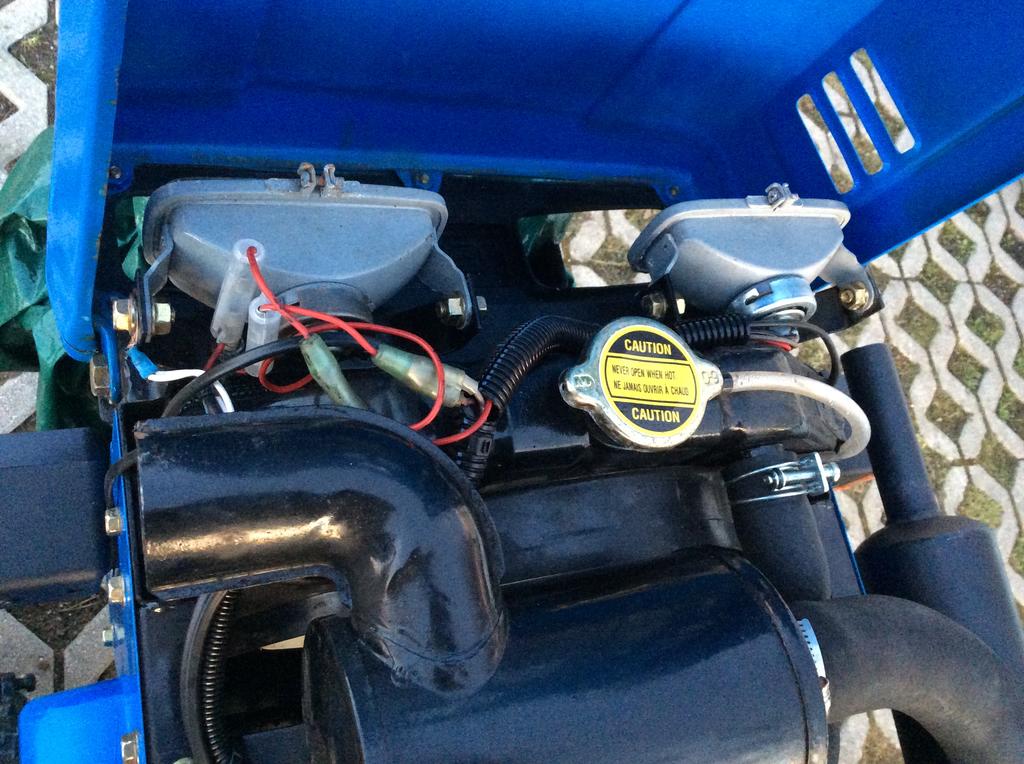

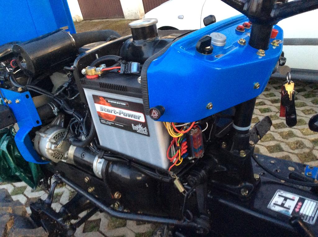

Tractorhead 9,217 #25 Posted March 16, 2019 Today, the first sunny day for a long while, was useful to work outside.😎 So while some Material for FEL is still missing, i do some more Measurements with templates. Think i will rework my Idea, because i got a R.O.P.S. for rear mounting. It was a very simple Bow with a Mounting hitch, that weight about 30-40Kg. To take Care of my Back, my little Workhorse is used to Lift the Parts in Place with his FEL, what a lovely thing to have. So first i painted it a bit but with a different color i allready have, just to hide some scratches. After that, i rework the complete Electric and improove it with some fuses. Original there was just 2 Fuses used, an Issue, i want not dealing with. Installed Warning flasher and a Connector for trailer use. 2 New Frontlights (position lights and Flash lights combined) are required to become Road Legal. At now on, all Wires for Lights and Flashers are fused separately Even ignition and a separate 15Amp fuse for the Hazard lights. Also a inwire Mainfuse (50A ) brings me now more safety, to protect the whole Electric for shorts. I hate to see loosen unbound Cables, so i build allmost a new Wireharness. The actual only unfused Cable is the Main Starter Wire itself. Then i added a Switch for the Hazard Lights. The red cable right behind Battery was the C2 line for Contollight by Trailer use, what is actual not connected, have tomorrow find a nice place, where i put the controllight in. Also the brown "ground steal cable" will be tomorrow reworked- that's a nogo.😱 All in all i removed 1,2meter senseless Plus Wire, what was routed nearly thru the half tractor unfused... 🙄🤔 Finally i found a 1m x 0,8m square Aluminum 2mm thick in my Barn, what seem perfect for a small Roof. Ok, it looks a bit strange but it seems useful. aaah, you wanna Pics, ok here you are... But don't laugh... My Wheelhorse behind "under cover" So far a good day, lot of things are done, tomorrow i hope the Weather is also fine, that i can finish the Electric. 3 1 Share this post Link to post Share on other sites
