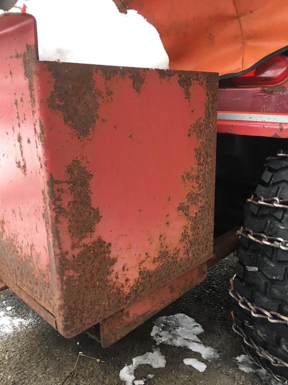

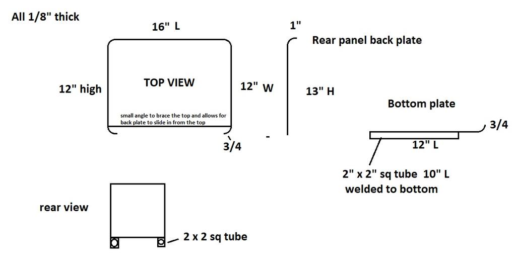

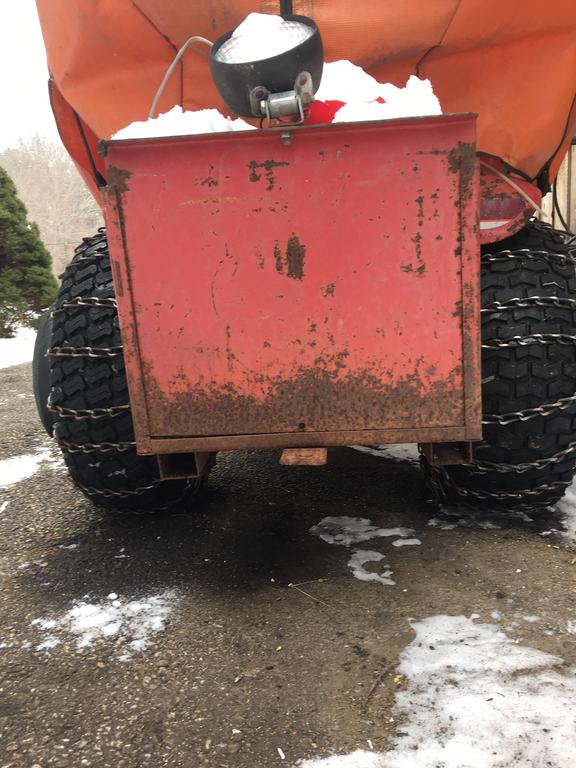

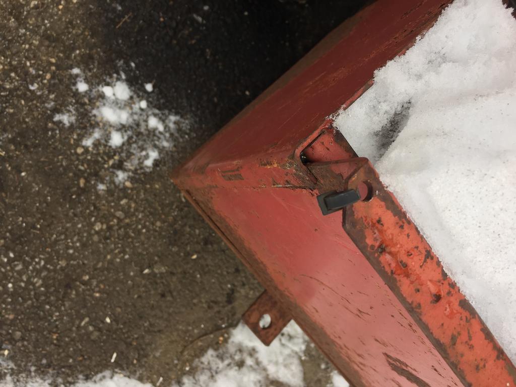

wallfish 17,141 #6 Posted February 3, 2019 Another member had asked me about the weight box dimensions so just adding this. 1 Share this post Link to post Share on other sites
