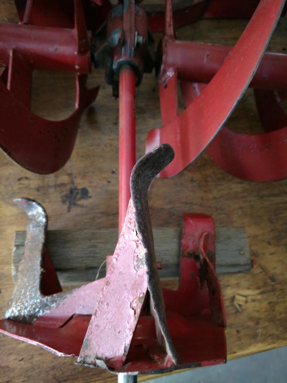

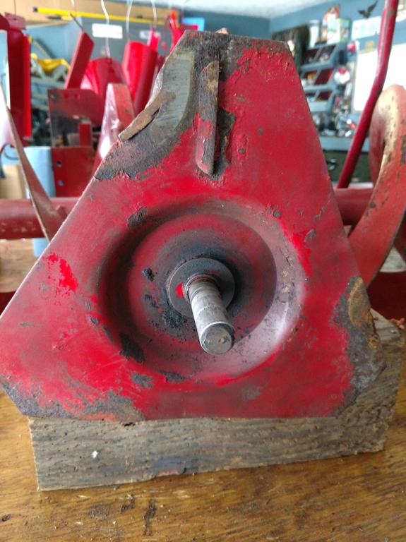

Hi Guys.
Just wondering if anyone has had a problem with the impeller(blowed) on their 44” 2-Stage Snowblower bending on breaking? If so, did you repair it to the same specs or modify it to be stronger and less susceptible to damage?
Also, is there another make/model or aftermarket impeller that will fit into this blower?
Thanks as always for your great advice and input.
Cheers,
John
Essex, MA
WHMan2012

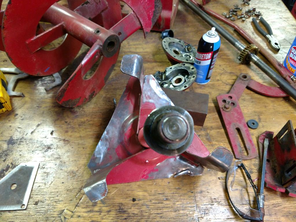

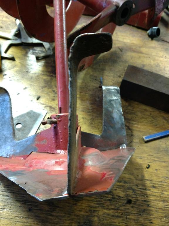

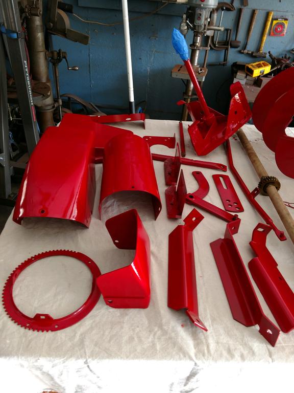

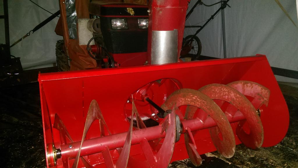

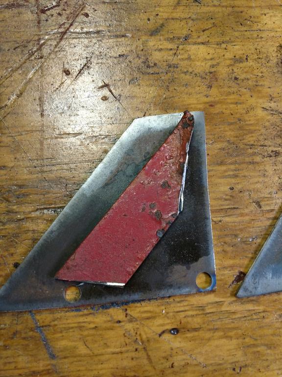

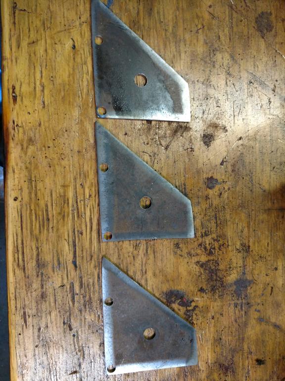

This Is What Mine Looked Like And What I Did To Fix It And It Works Great, No Vibration What So Ever . Hope This Helps.IMG_20181008_121148898.jpg.c915d08f7a298e880fcf2610441fc0b1.jpgIMG_20181008_121139291.jpg.2f8583e62749851b3bc99944a8958330.jpgIMG_20181009_174820308.jpg.7aa7a1864fa4d94ed15a772766d40082.jpgIMG_20181009_173927466.jpg.3cffa6af1bd1e3499808826e96b38de6.jpgIMG_20181011_135538188.jpg.40963f13e1182e722b2766ebaee667fe.jpgIMG_20181009_173939187.jpg.e942517cab410c14af93cddd9e8b4dd5.jpgIMG_20181025_134439551.jpg.268acd57aa3f76df78042235251f0a9c.jpg

WVHillbilly520H
It's not necessarily that the impeller is "weak" as technically the only thing that is supposed to be getting in there is snow or snow/ice combo, the shear pins on the auger are supposed to break when something (such as a brick or cinder block) gets in the way and ate by the auger...yes mine was bent rather badly as well I straightened it as best I could ground down all the rough areas sand blasted then painted it as well as added an impeller paddle extensions kit to "zero" the clearance between the impeller and drum, so far so good.

Fun times. Had chunks of asphalt from the DOT snow plow banks get wedged in there, newspapers from the idiot who keeps throwing them in the driveway before it snows, ect. ect. Bent but not damaged like yours is. It's a pain because the whole thing needs to come apart to get it out. Next time it's getting "beefed up". I'd rather burn and or snap a belt as those are MUCH easier to change.

Redisbest
I've  done this a few times myself...my original impeller had 4 flights with hd gussets (p/n -3). Now you can only get - 1 impeller...not near as strong and don't throw material as well. I use 2 522xi for commercial snowblowing.,.made welding fixture to replace flights and gussets.....and I hard face the leading edge.

r1jakecfd
These pics are so helpful! Thanks a million!
I wish the steel on the flights was a heavier gauge so they weren’t as apt to bend. Also, it would be nice have bolt-on replaceable flights like they have for tillers👍.
