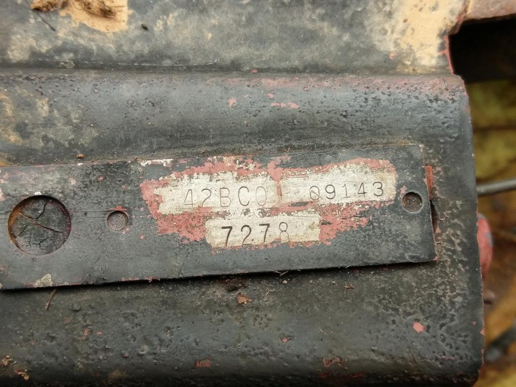

New Wheelhorse owner living in the Northeast. There is a snow blade for sale but dont know if it will fit my 1989 252H. The  id tag is reading 96-42BC01-06389 on the phot sent to me. The Toro site states I need a 06-42BK01.

I do know that the BC in the first set means it was built for B and C series horizontal shaft garden tractors (like the tag on my frame)...and that a 252H is a vertical shaft lawn tractors and the blades and they way they mount are entirely different.
First 2 digits on this last one are 86-42BC01. Once you know what they are you can see them. Don't rub too hard. The 86- was printed on the plate so easily worn off.
