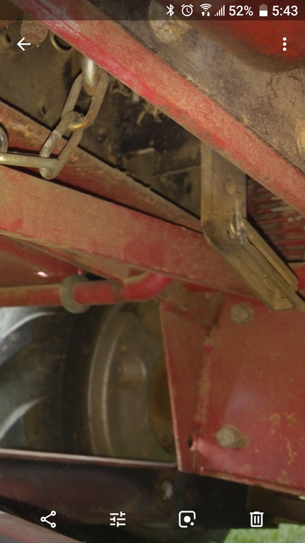

It goes in the black rockshaft hole above the rear hitch cable clevis I have pictured, Jeff.
cleat
This might help show the correct hole to install the lift flag into.

Okay I think it's good to go. I mounted the lift flag thru the top hole on the I believe it's called the rockshaft , which points down towards the ground. Actually it's been a couple years since I installed the blower on a tractor. I have no idea how I bent the flag in the first place. Thanks everyone for your help.
cleat
That will be the best bet for the easiest lift.
Mid hole will lift higher but will require more effort to do so.
The only way I can think of to bend the flag would be to run over something and hit the lift bar.
