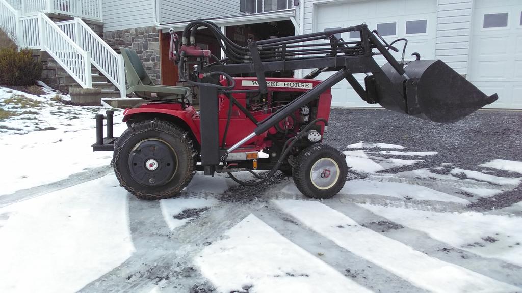

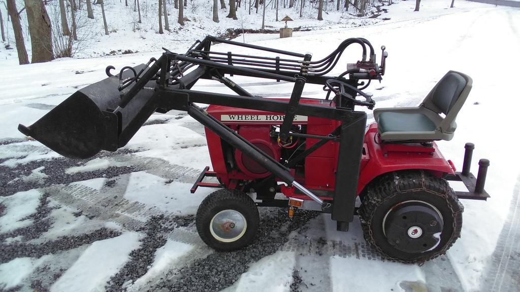

stuppy62 58 #1 Posted January 19, 2019 I recently picked this tractor and loader up, haven't got to do much with it because of the weather. I bought it for the loader, I've been wanting one for a long time I even considered building one. I plan on putting the loader on my 520H (I'm currently waiting on a hydro pedal from Matt), this should be a nice set-up! The tractor it's on is a C-141 I was told, it's not a big enough tractor for a loader, the front axle's are already toed out and I can barely steer it and that's with nothing in the bucket. Does anyone recognize this loader, what brand? It seems well built and is self leveling. 3 6 Share this post Link to post Share on other sites
953 nut 62,975 #2 Posted January 19, 2019 Can't remember what brand it is, but have seen ones like it. Very cool feature is that the bucket will continue to be at the same angle as it is lifted. Share this post Link to post Share on other sites
stuppy62 58 #3 Posted January 19, 2019 3 minutes ago, 953 nut said: Can't remember what brand it is, but have seen ones like it. Very cool feature is that the bucket will continue to be at the same angle as it is lifted. I've been google searching and I believe it's a Sears loader from the 70's. 1 Share this post Link to post Share on other sites
roadapples 6,985 #4 Posted January 19, 2019 That 141 frame is as big as the 520 with the exception of the one inch spindles. Easy upgrade... 5 Share this post Link to post Share on other sites
elliot ness 1,916 #5 Posted January 19, 2019 I think it is a Simpson, or Sampson loader, they were made in Canada. they were made for Sears tractors, I have had a few of them, they are great loader, they lift real high and are strong as a bull. Share this post Link to post Share on other sites
elliot ness 1,916 #6 Posted January 19, 2019 9 minutes ago, elliot ness said: I think it is a Simpson, or Sampson loader, they were made in Canada. they were made for Sears tractors, I have had a few of them, they are great loader, they lift real high and are strong as a bull. Sorry I was wrong, It is a Kwick / Way loader, I found a picture of one I had 10 years ago. 3 Share this post Link to post Share on other sites
stuppy62 58 #7 Posted January 19, 2019 I believe your right it is a kwick/way, on Sears tractors they mention Kwick/way, I'm sure Sears didn't actually make loaders. It's incouraging to hear they're good loaders, I thought it looked well built. I'm going to pull all the pivot pins out and grease them, there are no grease zerks. Someday I might make a bigger bucket, the one on it is only 36". Share this post Link to post Share on other sites
stuppy62 58 #8 Posted January 19, 2019 roadapples, your right about the frame size, but the 520 has a bigger stance, it's taller, 4" wider and 4" longer( because of the swept forward axle). 1 Share this post Link to post Share on other sites
WVHillbilly520H 10,376 #9 Posted January 19, 2019 30 minutes ago, stuppy62 said: roadapples, your right about the frame size, but the 520 has a bigger stance, it's taller, 4" wider and 4" longer( because of the swept forward axle). But that very same swept forward front axle can be fitted to your 141 ,even the gear reduction steering eBay and even @A-Z Tractor has the parts you would want/need. 1 2 Share this post Link to post Share on other sites
roadapples 6,985 #10 Posted January 20, 2019 I put the swept forward axle and gear reduction steering on my 160. Also trailer hubs and wheels and tires. The tires are 6ply and hold 70psi, which helped steering almost as much as the gear reduction. I highly recommend on any loader tractor.... 1 1 Share this post Link to post Share on other sites

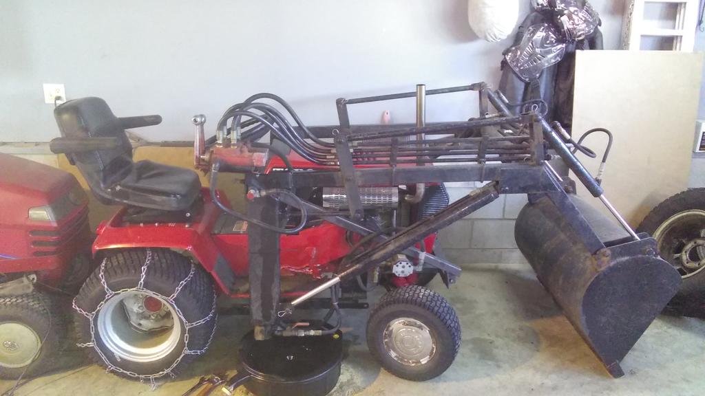

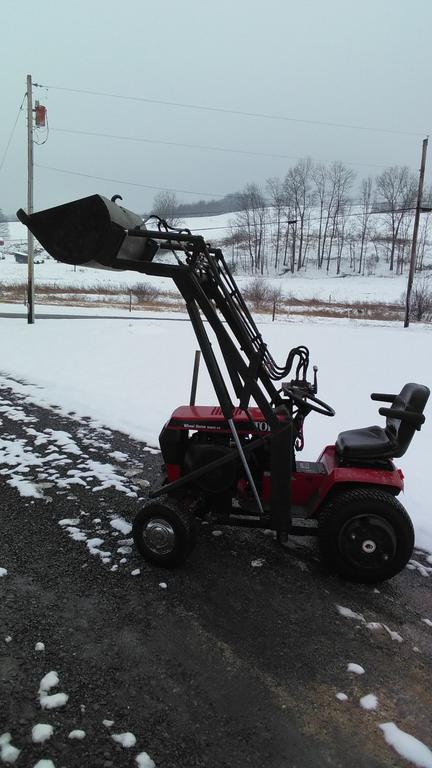

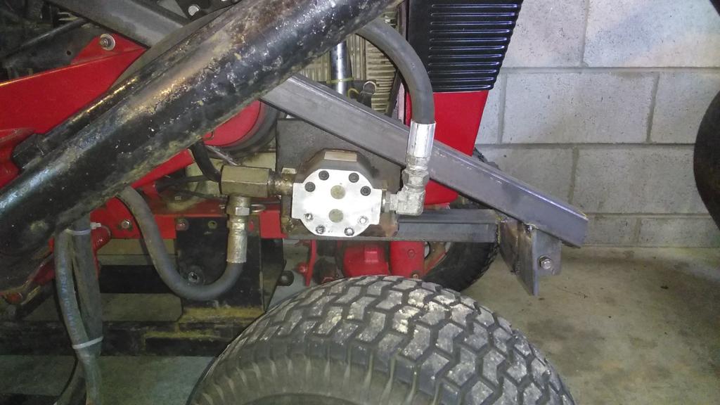

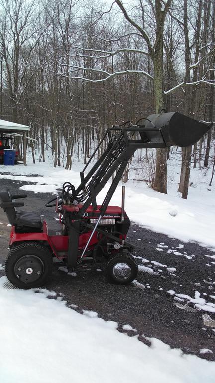

stuppy62 58 #11 Posted March 4, 2019 I got my project complete 520H, Matt's hydro pedal and front end loader! Got to use it in the last snow and it worked great! I had to change the hydraulic lines around the controls worked backwards to what I'm used to, but the was no big deal. I can't wait to use it this spring on different projects. 5 2 Share this post Link to post Share on other sites
