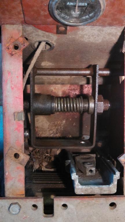

I have a couple of questions about my 875.   Should it have a brake pedal that kicks trans back to neutral?   Mine does not.                 Also the lever to operate hydro is very sloppy.   Does anyone make a kit to rebuild these ?

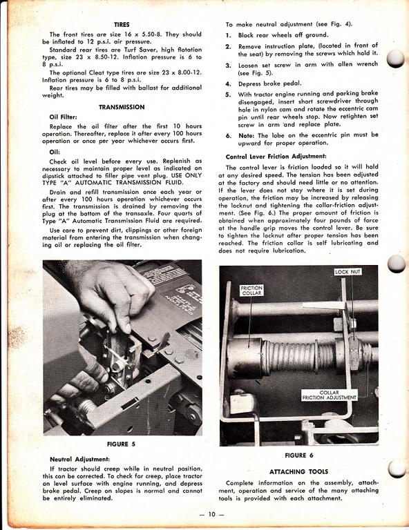

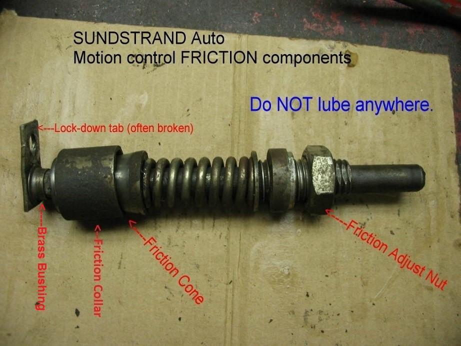

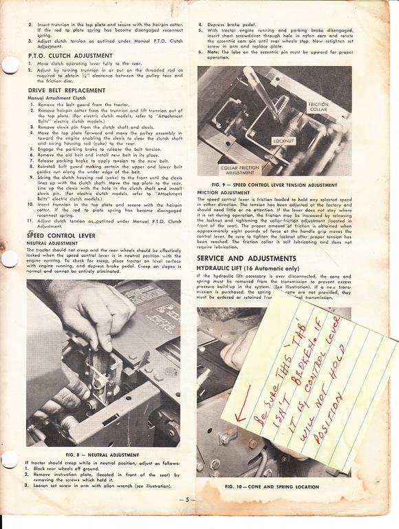

Your Sundstrand trans is model 3100077...like a 1276 or charger 12.  Linkages are the same too.  There is a tension adjustment for these..under the tunnel cover (2nd pic).  Try the adjustment 1st and check the up/down motion of the NYLON plate...it should NOT be sloppy in the channel.  CHECK THIS too...  may be a broken tab on the shaft as in the last pic.
The answer is YES!    With some missing parts in the shift area you probably will need to replace all of the missing parts to make it right. Give Lincoln at A-Z Tractor a call, he should have what you need, great fellow to work with.

Yes I think I am missing some parts.   Mine doesn't look like those pictures.     I have dealt with A-Z before.   Yes vey nice to work with.       Thanks for the input
