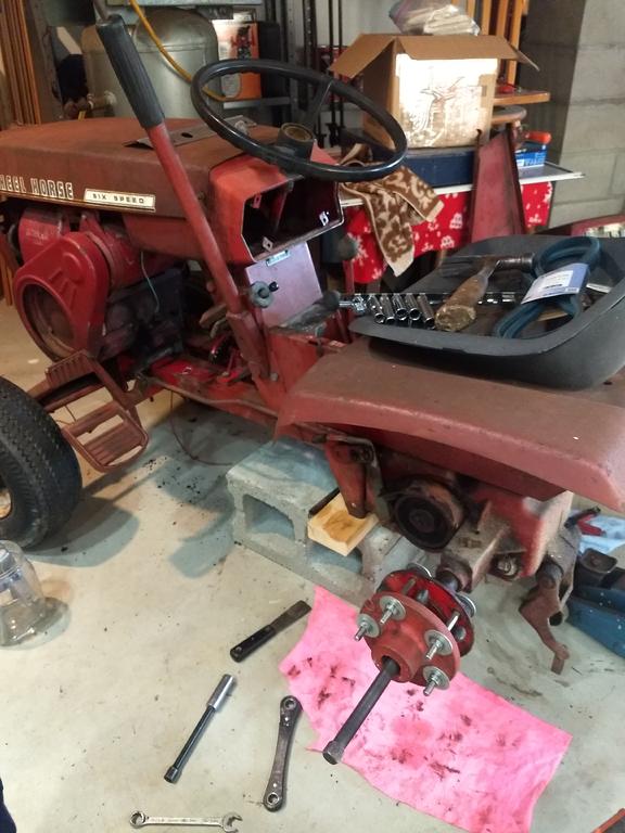

953 nut 57,762 #2 Posted January 9, 2019 Don't know what his puller was, but I just built one like this one and it is great. 3 1 Share this post Link to post Share on other sites
ebinmaine 70,573 #3 Posted January 9, 2019 Jim I can't search that one either but what I do is use a large 3 jaw puller and remove the Jaws and put 5 bolts between two Wheelhorse hubs. One on the tractor. One off the tractor. Still takes a fair amount of patience and it doesn't work 100% of the time because I do not always have that fair amount of patience. 3 1 1 Share this post Link to post Share on other sites
