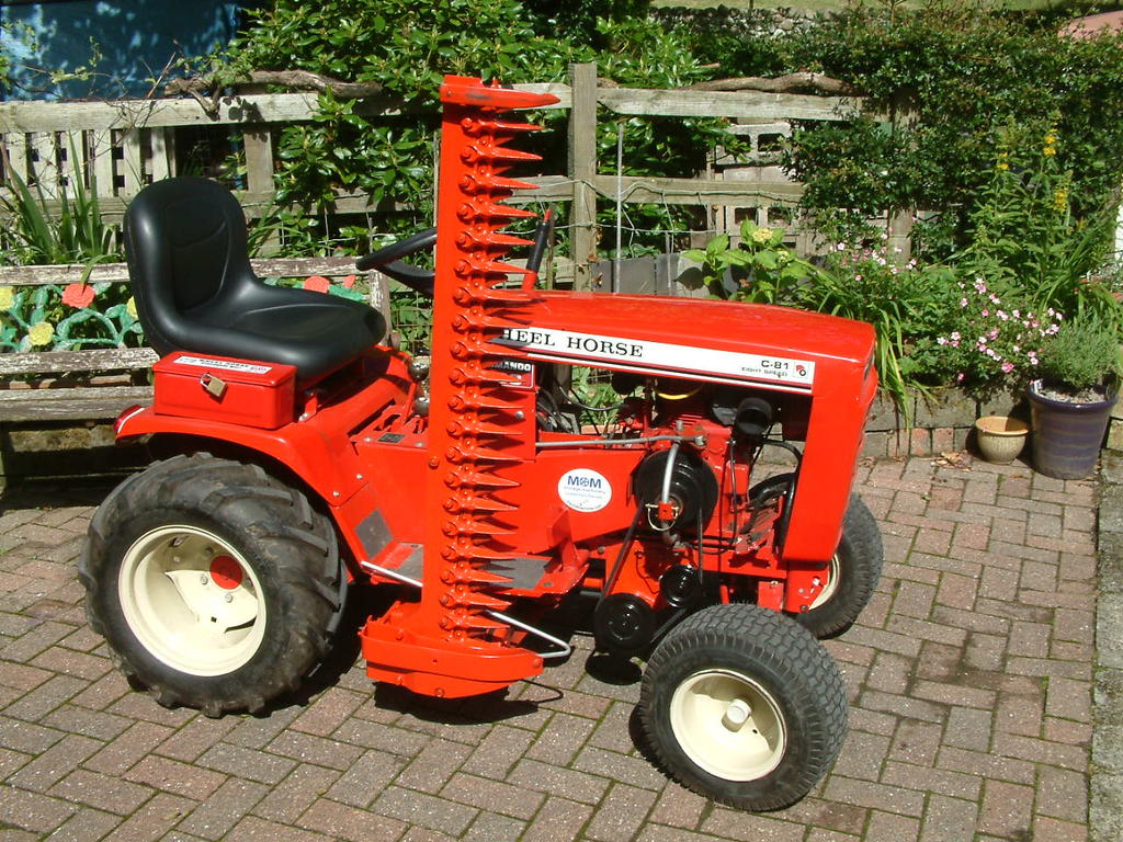

 I've fitted a '63 sickle mower to my '79 C-81.
 I had to make the mule drive and plates. The rod you mention was not altered. The mounting plates were made to suit.
 There is a thread on the work on our sister site myoldmachine. Step by step restoration. October 10th 2015. Maybe someone more clued up than me can put on a link.

Of course! Need to get a 2.5" drive pulley for the engine, currently using an old C-160 pulley which is about 4" and spins a bit too quick. Certainly not as fun or easy to mount then the other implements, but I look forward to running it. Always wanted one of these things.

Nothing really to it, just a simple 2.5" OD, 1 1/8" bore V pulley. Nothing fancy.

If you don't need the four bolt holes to mount a PTO you could get a cheap pulley off fleabay.

Yes, the 4 holes aren't needed. I just happened to have the pulley around from when the C-160 was dismantled. This unit works like the earlier tractors. It doesn't use the PTO 'clutch' it uses the old short frame foot-pedal PTO system. When it was new, and by the book, you would remove your PTO clutch and disc and slide on the smaller pulley, like say an 854 would have. Basically.
