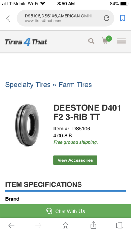

Just wanted to see if anyone had any experience with these tires. How they hold up etc. thinking of putting them on my c 160 plow project. Reading over the specs it said the section width is 4.2 with a rim width of 3. That’s a lot narrower than the stock rim width. I have seen videos of people cutting the rims to narrow or widen them, but that seems like a pia. Not sure what other rim options I have.  I’m also thinking of filling them, and having a weight bracket off the front.

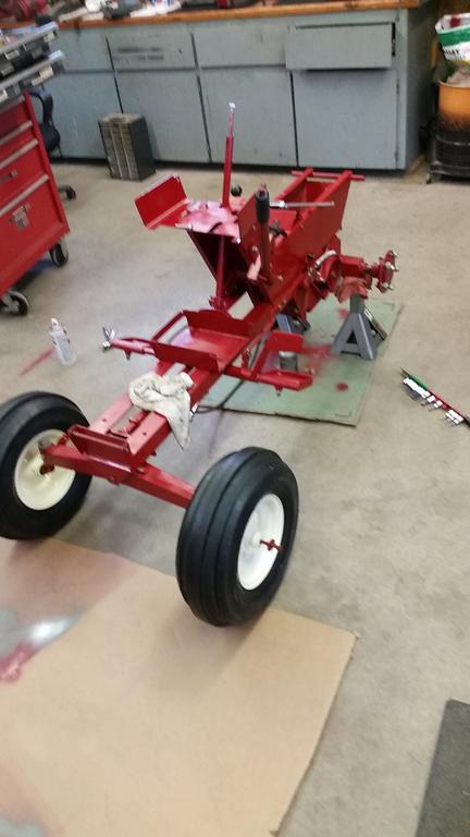

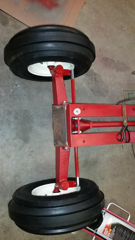

I just put a set on my 312 on 3" wide rims. I like them makes steering a lot easer. I also used the 312 spindles for the 6" rims .I had reinforced them a couple years back. I have  25 x 900 x 12  All trail II on the back that I raised the fender bracket, gas tank, and rear fender. The front rim were WH trailer rims I had to take 3/4" width off the hub to make them fit. I chose to take it off the out side to make a wider stance.

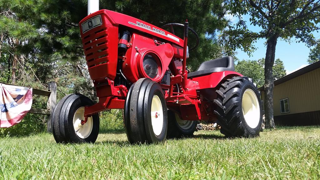

I have deestone tri ribs on a 1076 and I think they are great. They really look good and work well, makes steering much easier. They won't work on those wide C160 rims, but firestone does make a tri rib in the correct size, it's just very expensive. You can get a set of the narrow wheel horse rims fairly cheap and swap spindles with an older machine if you want to go a cheaper route.

Achto

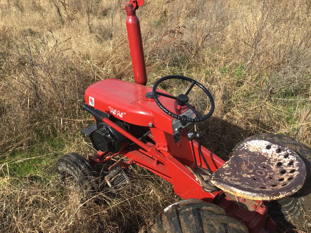

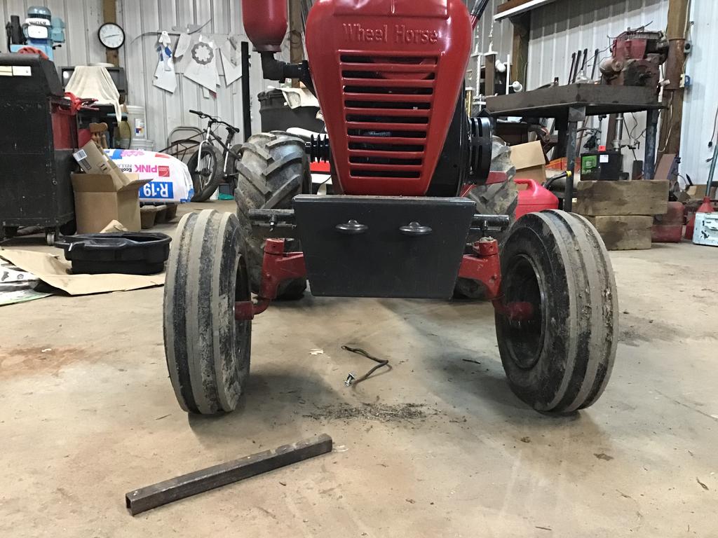

I'm running those on my plow tractor with the stock rims.
I’ve got them on Putt Putt, Deestones front and rear.

They were 3/4" ID  bushings in the rims I changed to 3/4" bearings. The hubs were 4 1/2" long we chucked them in the lathe and took off 3/4" to make them 3 3/4" long to fit on the 312 spindles.The 312 came wirh the little 6" rims and smaller tires. The 4 1/2" and 3 3/4" measurements were taken with the bearings installed to the out side of the bearings.

Achto that is exactly what I’m looking to do with mine, and that look

Mike is correct on the wider rims they will work but look goofy. He is spot on about the Firestones and is the only thing I would put on a beast of a C160 dang the cost.
Miller tire is the only place you can get them and they are quite proud of them. In fact darn near the only place you can get a 16/6.50-8 tire these days is Miller.
http://www.millertire.com/products/lawn-garden-tires/16x6-50-8/16x6-50-8-firestone-3-rib-front-4-ply/
I got these used for a little less than Miller from a fellow member. they are mounted on standard rims and look a little balloonish  but not bad.
I do have the Dees on my regular plow rig just like Dan's above with good results.
