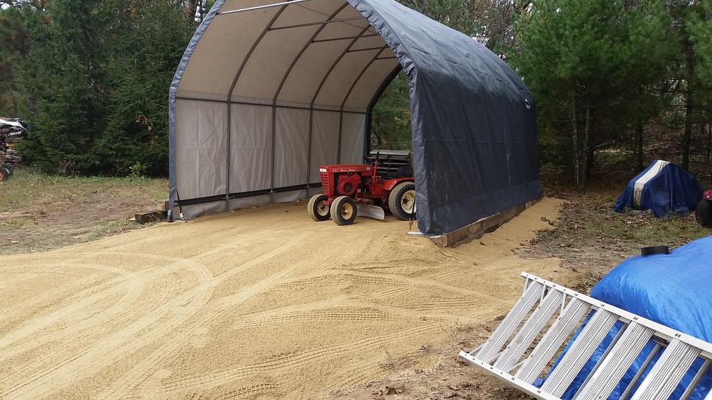

WHX?? 48,776 #4 Posted January 2, 2019 (edited) Quite a few of us have them. The biggest problem we see is how they will hold up to the uv rays of the sun. Mine is less that a year old so time will tell. I used 3/8 driveway gravel under mine but if drainage is a problem you could elevate it a tad and use a larger stone for the base. This one was put up on a foot or better drop in grade in 13 ft so I used landscape timbers I had lying around to level it out. It's a Shelter Logic from Northern Tool ...20 x 13 I believe and holds a dozen + or - tractors given size of tractor. Edited January 2, 2019 by WHX21 6 1 Share this post Link to post Share on other sites
