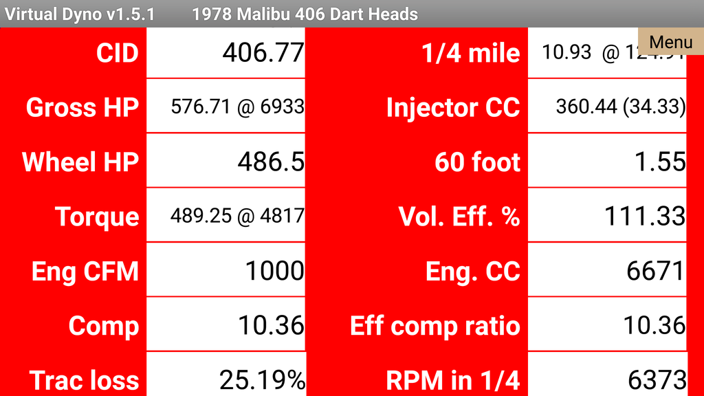

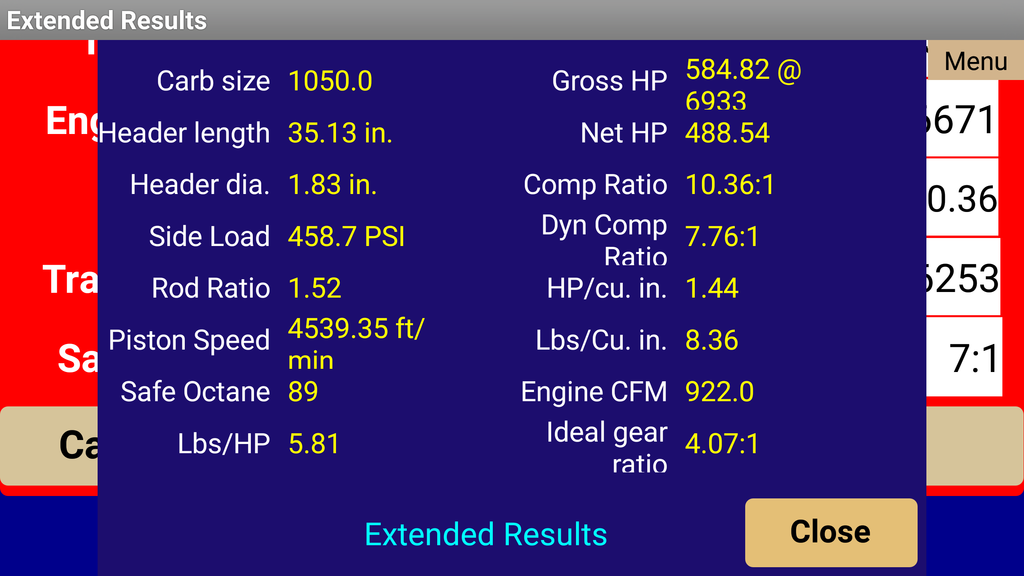

WVHillbilly520H
@bcgold, I like that you took the time to write up the cam compression idiosyncrasies, but I'll will have to say with my current 406 SBC combo with a static CR of 10.3:1 and Dart Iron Eagle Platinum heads I get by quite well with 93 octane pump gas and 34° of timing, each engine build should be an individual blueprint to each intended use with stock, modified, or serious performance components, just my experiences and humble opinion. This screen shot is from a computer dyno simulator for my particular build.
