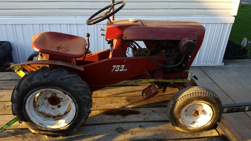

Trina's next tractor. 867. Let's get this up and running !!

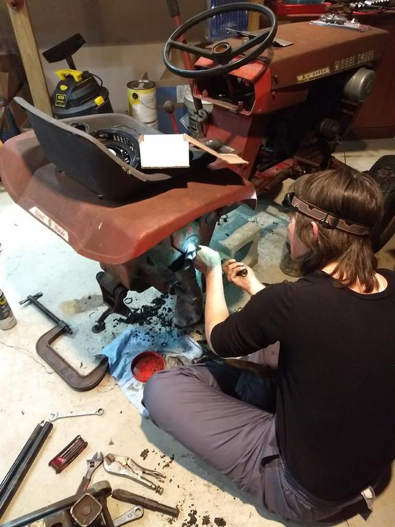

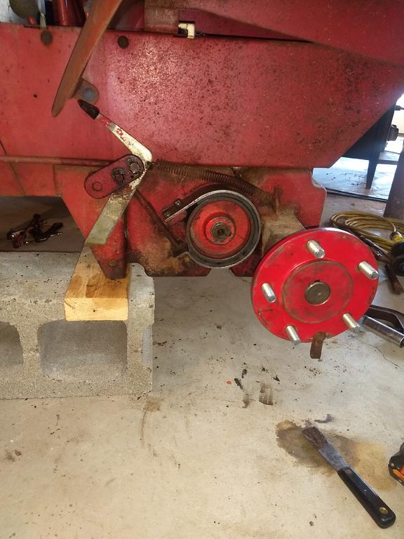

Trina and I were able to spend two or three hours working on this tractor again today.
We removed the brake system and cleaned up the shoe holder and she installed a new shoe from @rmaynard Bob.
Trina also wire brushed the outside of both axle shafts and then I finished cleaning one of them up a little with sandpaper and installed a seal on that side. And installed a seal on the brake shaft.
Note the wonderful pile of gunk on the floor...

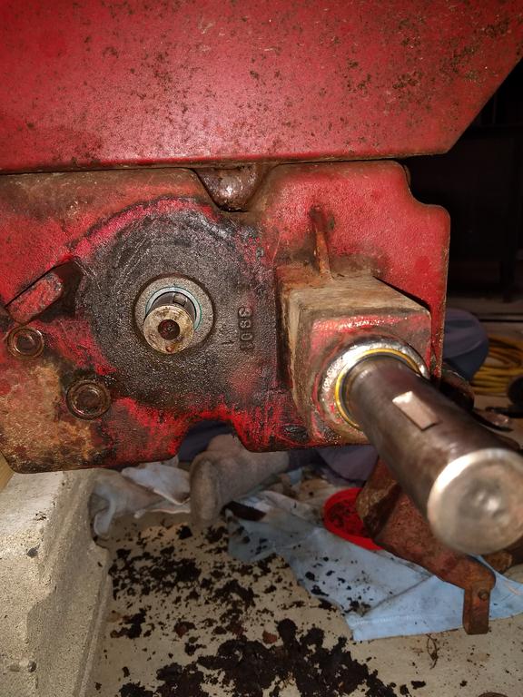

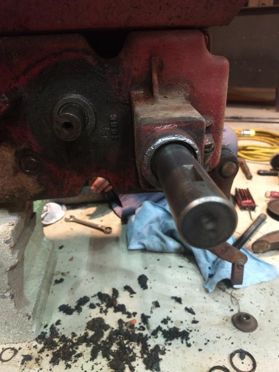

There was vast Gunk removal from both sides of the transmission.
She also removed the drive pulley and as seen in the picture below she pulled the seals out on that side of the tractor.
  • Like 6

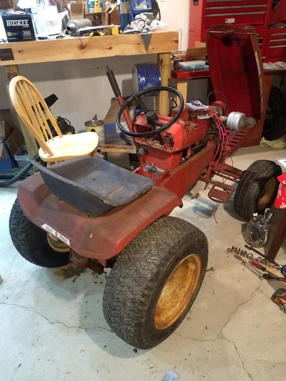

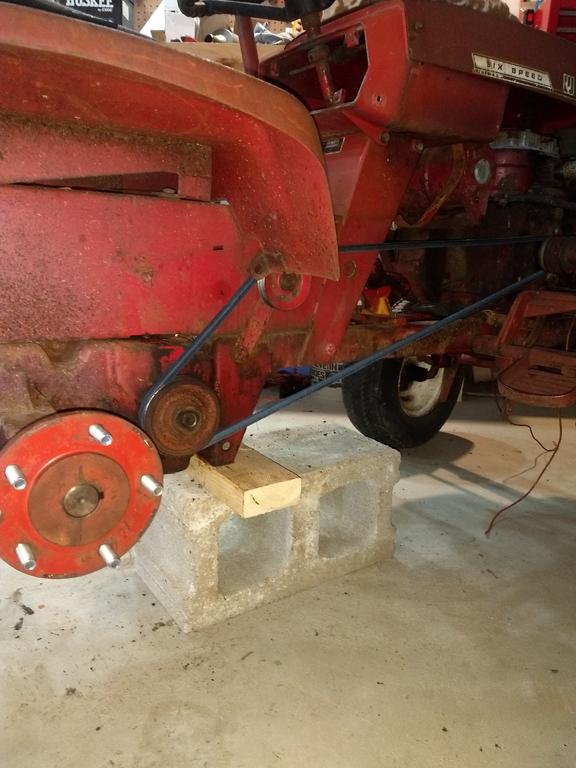

We finished cleaning up the transmission and reassembled the brake mechanism, adjusted it, installed the drive pulley, new Stens belt from A - Z Tractor, a better used idler pulley, and both hubs.
The hubs are much newer HD type with 2 set screws.. Of course with lug bolts...
Next we'll put the rims and tires that were on the 1267 when I got it. Same size rim with new/excellent chevron style turf tires. It'll get chains for traction later.
This horse is back on its own four legs, so to speak.
Now for the rewiring and a new gas line and we'll be good to go. We hope.

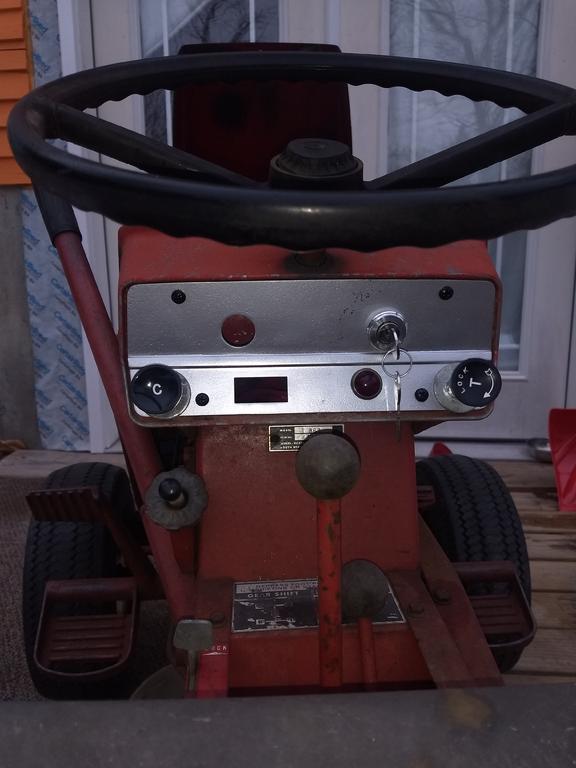

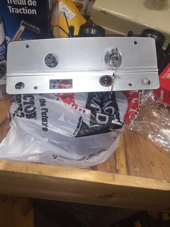

Not much time to mess around with the tractor today but I was able to use the pilot light as recommended by Richard @953 nut to sort of, reuse the old one as well. I put the guts and the nut and washer from the new one onto the original lens and it looks like it should hold okay.
I also got another ignition switch for this one. I went with a Standard part number US14. This is a direct replacement for the switch that was in the tractor even though it is not actually correct for Wheel Horse application because it actually is a 4 position switch.
As much as I love putting things back to the way that they were built, sometimes it isn't justifiable to me. This switch was nearly half the price of the Cole hersee switch.

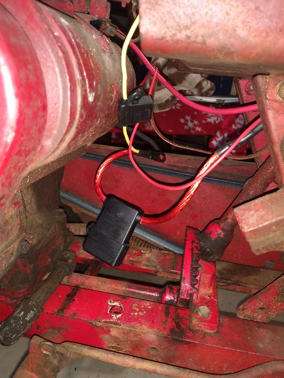

@jebbear I used the picture you sent me of the harness that you built to make my own for the 867 tonight.
@953 nut and @WHX21 I used the schematic that you folks posted a few months back to wire this thing up tonight.

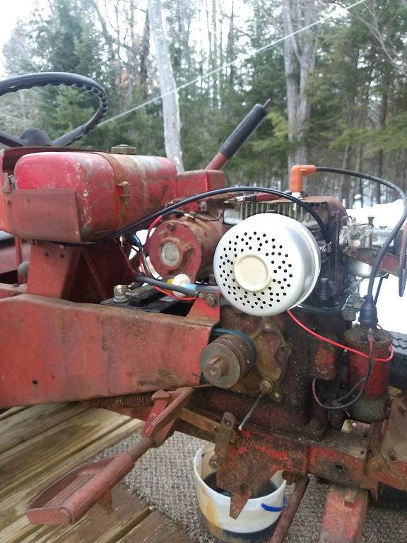

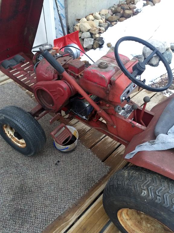

She's running !!!
Next step is to get some oil back in the engine and put some diesel in the transmission.
Here's a few pics.
:text-coolphotos:             Glad to see you are using the fuses from the battery and S/G unit.         :handgestures-thumbupright:

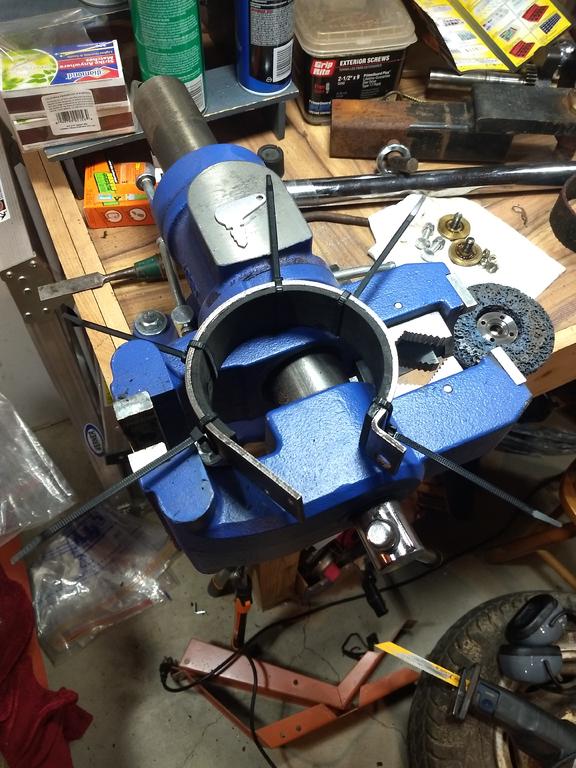

What kind of vise is that? Looks pretty cool
I ordered this online. I don't remember if it was a popular auction site or the jungle site.
I seem to remember thinking it was less than $150
