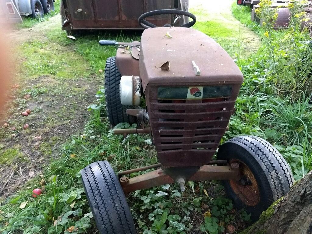

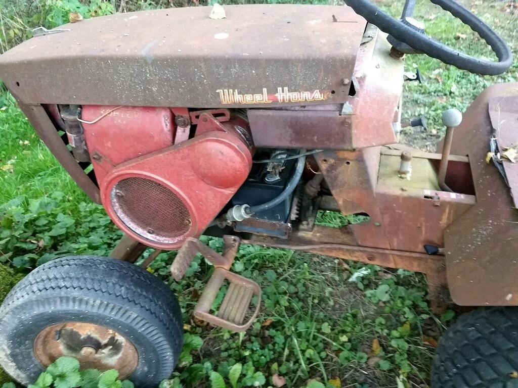

Trina's next tractor. 867. Let's get this up and running !!

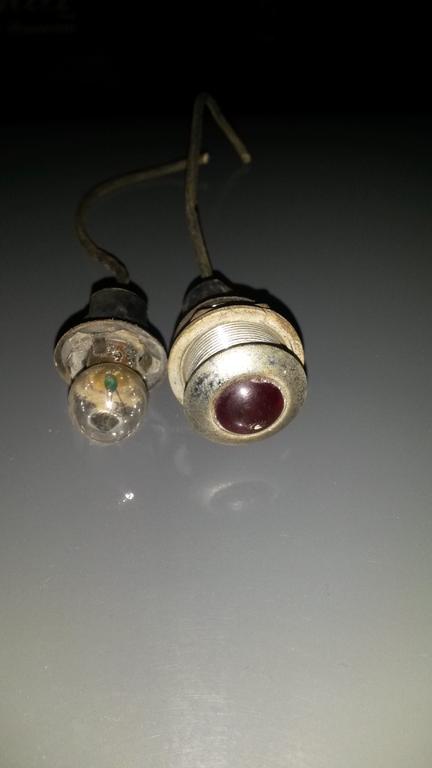

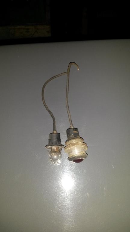

Well it's not that exciting LOL
A few are from tractors and a lot of them I have actually are old dash indicator lights from old semis / farm trucks we had over the years. It was routine at our house to strip anything that was still useful and could hold a purpose later down the road. If you didn't my grandad would let you know it.
I guess it's okay that they did not come from a cyborg.
I'd still be perfectly happy to put them to use.

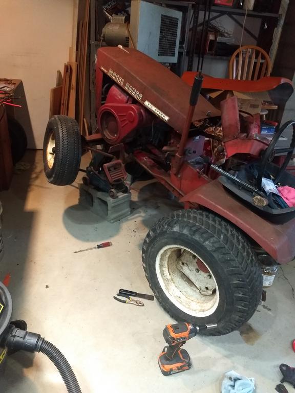

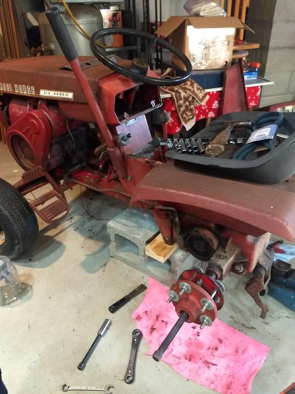

A little more drainage.
I want to get the front higher but the chain Falls is in the outdoor workshop so this'll do.

Is that jack osha approved?
Jack.... Probably.

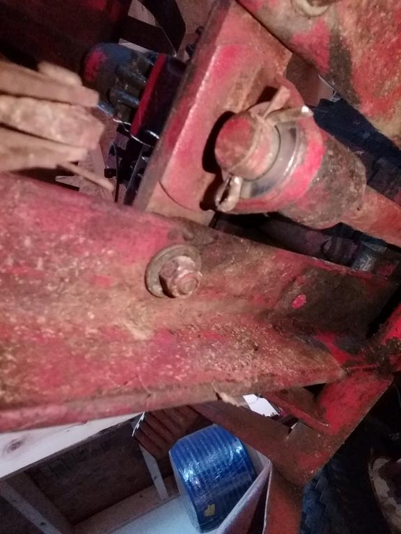

Found a shim to put between the cotter pin and lower steering block while installing a new block.
Should help tighten up the steering just a little.
On 12/24/2018 at 10:09 AM, Chris G said:
I can send ya a complete one and a extra socket. The chrome has to be cleaned, but it's not pitted or anything like that.

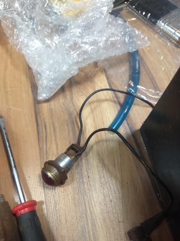

That is not the light for the generator light. There need to be two wires going to the lamp and it is not grounded.
It is a Cole Hersee PL-20-RC.

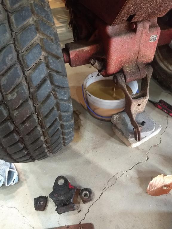

On 12/24/2018 at 2:00 PM, ebinmaine said:
Yummy !
You going to flush that or just refill ?
  • Confused 2
The Tuul Crib
Diesel run flush. Diesel run flush.
Diesel run flush

Due to the fact that it had water in it and the oil looks that way I'll likely run a couple quarts of diesel in it, drain, repeat. Fill with new oil.
I gave a good effort.
It tried to defeat me.
I won.

Chris G
Really? Cause my 1056 and the 1055 both have that style. One wire for power and the case grounds itself.
Two wire light is what came out of it
Trina's tractor. 657. Did not have one but I don't think it should have, having a Tecumseh engine. My other 1967. 1267. That did not have one either. So I can't use either one of those two as a reference point.
Chris G
@ebinmaine and @953 nut  well thanks for sharing that info 953nut. I never realized they were a 2 wire light. But he is correct it got me thinking so I checked the manuals I got and it shows 2 wires. So thanks for sharing that. I though it was correct all this time cause my 1056 has got 1 wire and the 1055 I did had a 1 wire.

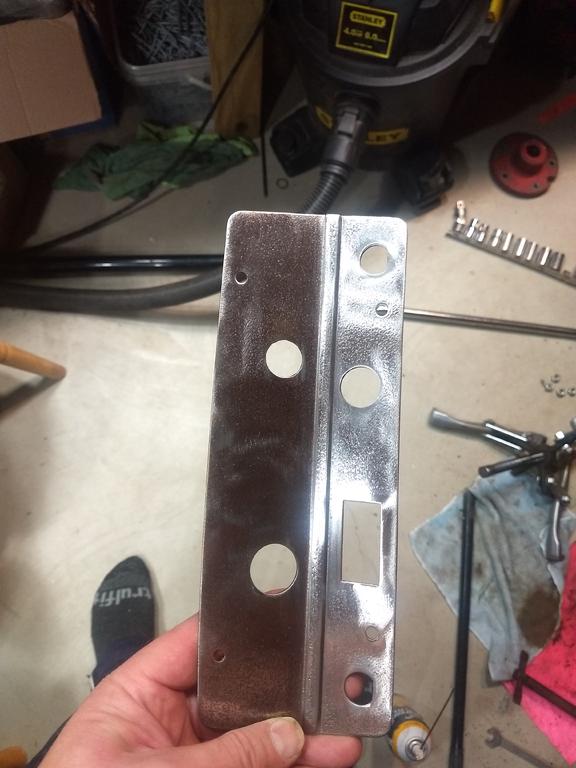

I wire brushed and ground all the rust off of the dash plate. I didn't think to take a before close up of it but you can see in the first post if you zoom in that it was basically a piece of rust.
This thing almost looks too good to coat over the way it is now.
Maybe @Vinylguy Terry has some see-through decals?
I really am about half inclined to just throw a coat of clear over this.

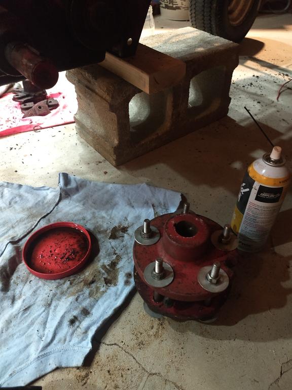

Got the hub off the other side just now. This one argued far less. This side had a wheel seal that was leaking much more. So less rust in the hub.

Just so you know - unless that surface is as smooth as glass any imperfections will show through the vinyl replacement decal once it dries and pulls itself tight to the surface. I do recommend using a good quality automotive primer as a base, then use a skim of filler to get rid of the pits and such, then put your final background color over that. It is worth your time to block sand the surface between coats - the smoother the finish, the better that decal will look. I learned the hard way on my first dash project, amazing how that vinyl can show the smallest imperfection and actually amplify it to make it more noticeable.
Sarge
@Sarge
Quite true. On Trina first tractor we had a heck of a time getting that one to sit correctly.
I think for now we're just going to put it back together and paint it now but sticker it later..
