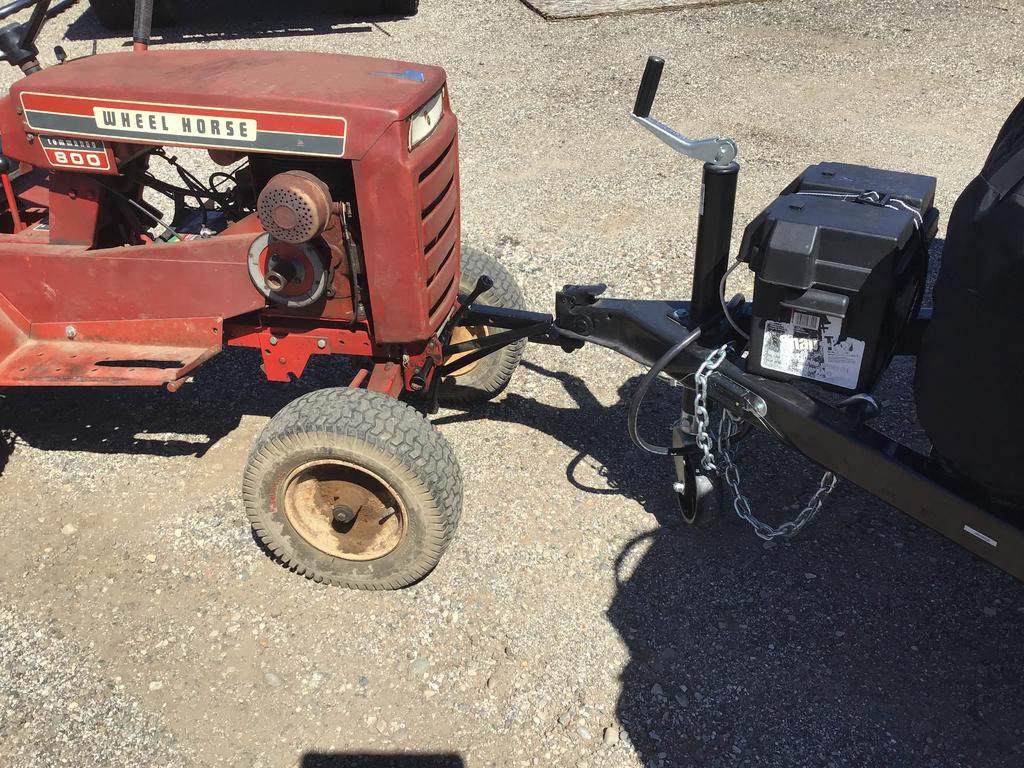

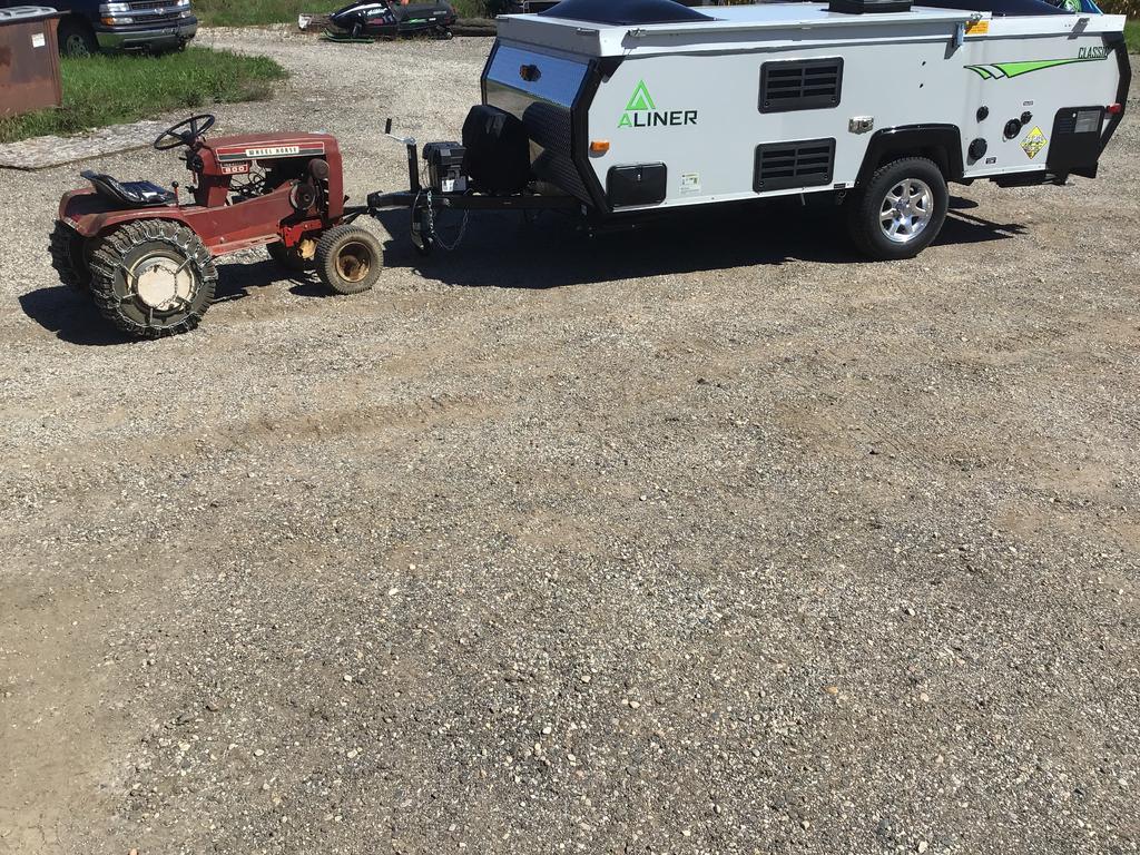

The Attach-A-Matic holds up to tugging a trailer, I bet it would fare well pulling and lifting...
the hitch is built from an old 4 way lug wrench, fits just right!
I am having troubles loading pics, I’ll post then reload and try again...
