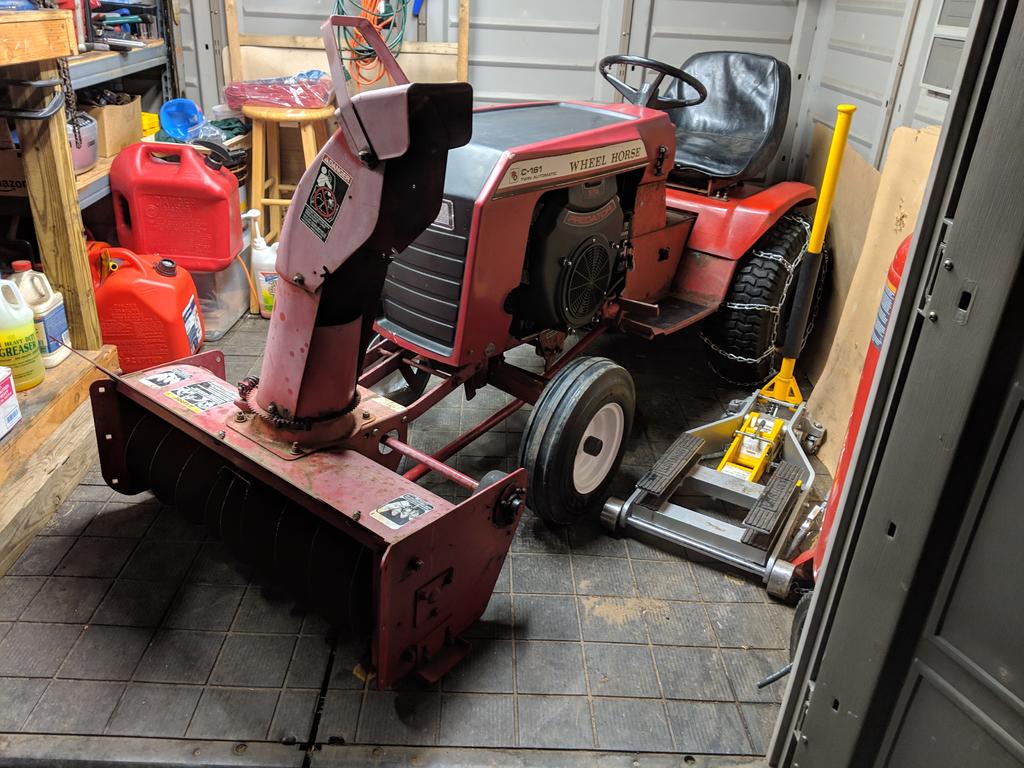

WildmanC120 613 #1 Posted December 7, 2018 So, I saw in another thread where someone bought some 1 way check valves to go inline with the fuel line. I guess it really improved cold starts after sitting a little while because it kept the fuel line full. I bought one and decided to try it. I would recommend not doing this, I cannot get my engine to run right now. It's pouring fuel out the what I believe to be a vent and its filling the intake with gas. Engine will not run at much less than full throttle now. I'm not sure what happened but the 1 way valve must have created too much pressure with no place to go. I wonder if it has forced the float to stick open as I tried even feeding the engine with a gravity fuel source and it was just pouring gas out the carb. Share this post Link to post Share on other sites

WildmanC120 613 #11 Posted December 8, 2018 All Fixed!!!! Pulled the carb apart and found some black colored crud in the needle and jets. It did not come from my fuel line as its brand new translucent blue line. The inside flapper on the check valve is black though. If you use one be sure to clean it 1st. Good lesson here. She also got a new set of NGK plugs too as the others were totally black and fouled. I did come across something awesome though. Found some welch plugs on top of carb with that looked like needles. Removed the plugs and sure enough, adjustable low mix screws. It's my lucky day for once HA. About a 1/2 a turn to each and she starts and idles much better than before. Thanks EPA! 22hp Predator Running After Carb Clean & Low Adjustment Also installed a new set of Tri-Ribs. It's like having power steering now. These things are AWESOME! 3 3 Share this post Link to post Share on other sites
