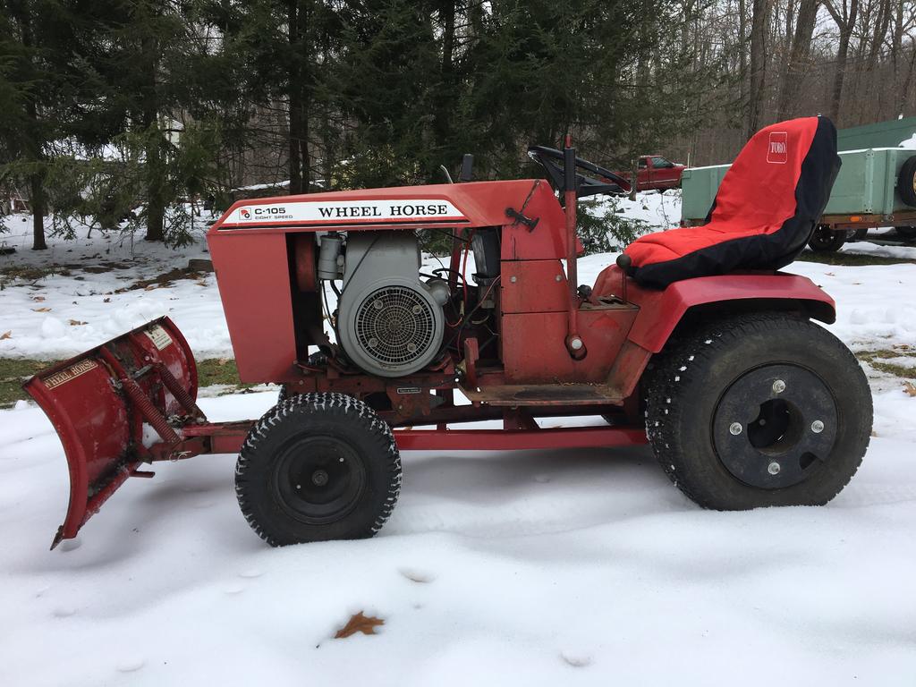

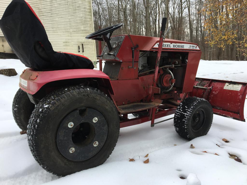

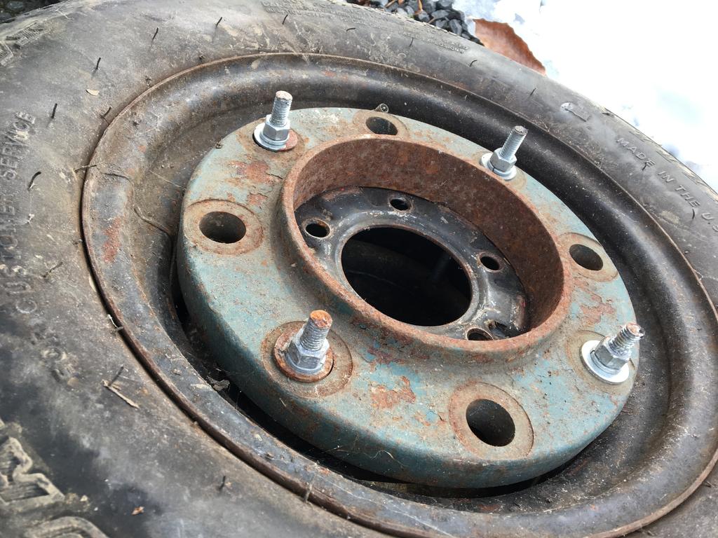

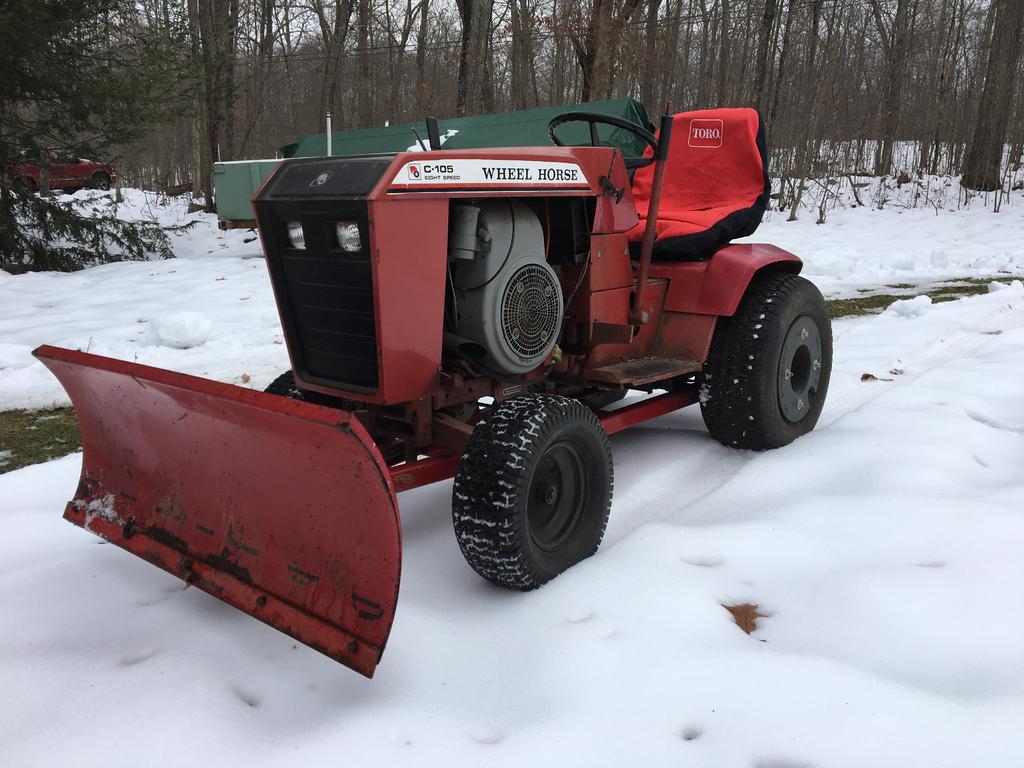

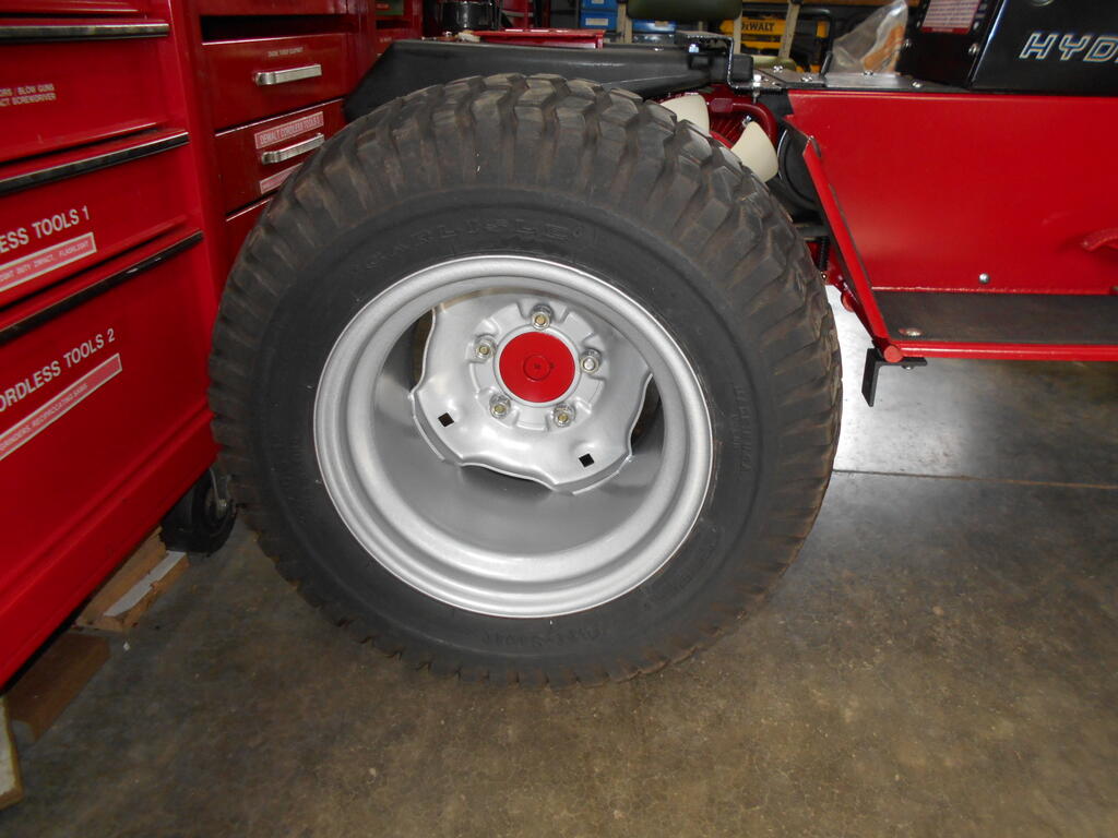

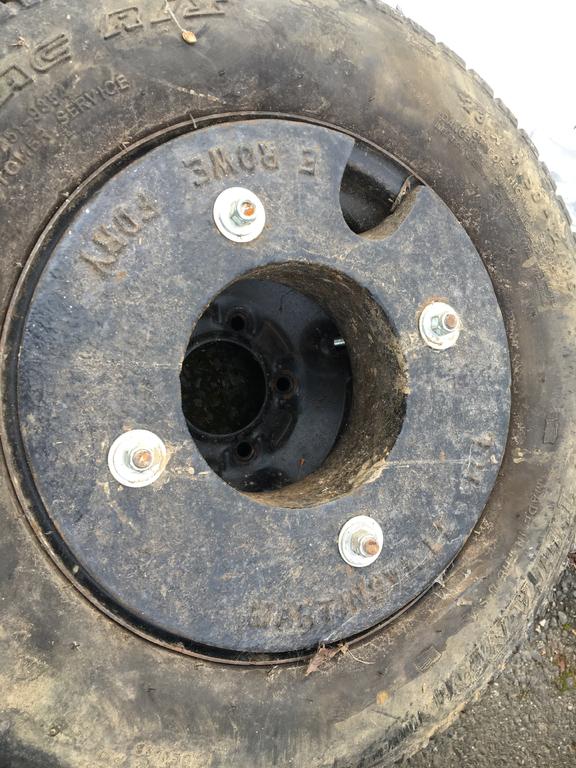

Sparky-(Admin) 23,986 #1 Posted November 21, 2018 Snow plowing and the harsh weather can take its toll on our (my) machines...so I always have a second plow tractor ready and waiting in the shed. Ive sold off quite a bit of my stock and only have two machines that I would want to work hard and plow with. So my C-105 gets the job of second fiddle. Two ply turfs in the rear with 50# weights on the outside and steel pipe flanges that weigh in around 18# on the inside of the rim. With 65-68 pounds I can avoid chains. Pics of course.... 7 12 Share this post Link to post Share on other sites
ebinmaine 75,755 #2 Posted November 21, 2018 7 hours ago, Sparky said: steel pipe flanges Can you elaborate on that? I use fluid and weights and chains and could actually use more here on the mountain. Share this post Link to post Share on other sites

Retired Wrencher 6,169 #5 Posted December 11, 2023 On 11/20/2018 at 8:46 PM, Sparky said: Snow plowing and the harsh weather can take its toll on our (my) machines...so I always have a second plow tractor ready and waiting in the shed. Ive sold off quite a bit of my stock and only have two machines that I would want to work hard and plow with. So my C-105 gets the job of second fiddle. Two ply turfs in the rear with 50# weights on the outside and steel pipe flanges that weigh in around 18# on the inside of the rim. With 65-68 pounds I can avoid chains. Pics of course.... Those tiers must of been fun to put on Mike. Ohh my back! 1 2 Share this post Link to post Share on other sites
Sparky-(Admin) 23,986 #6 Posted December 11, 2023 11 hours ago, Retired Wrencher said: Those tiers must of been fun to put on Mike. Ohh my back! Yeah… not fun. I fiddle with the floor Jack till the rear hub is right at the correct height to shimmy the wheel on. 1 Share this post Link to post Share on other sites

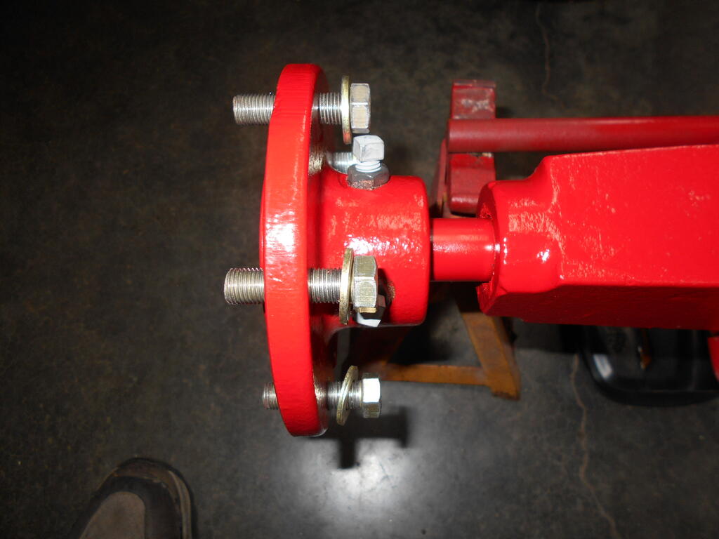

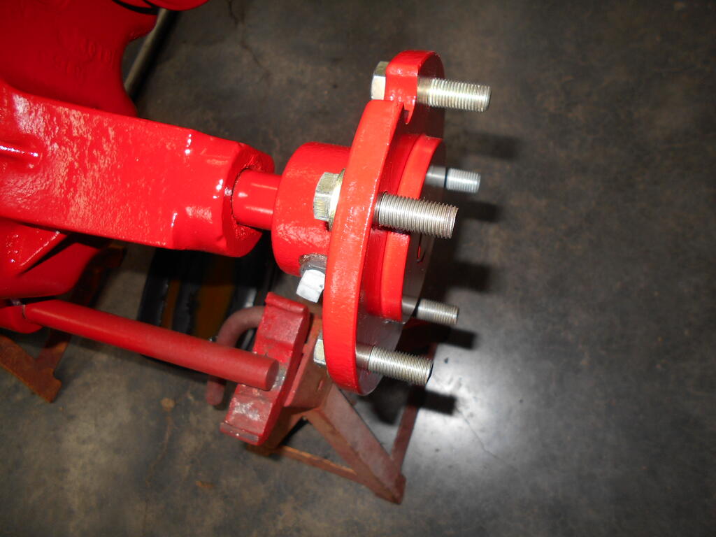

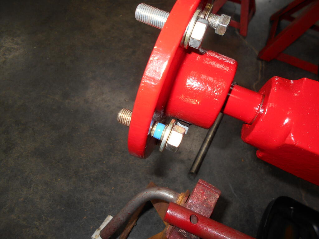

Wild Bill 633 899 #7 Posted December 12, 2023 13 hours ago, Sparky said: Yeah… not fun. I fiddle with the floor Jack till the rear hub is right at the correct height to shimmy the w Try replacing the lug bolts with grade 8 full thread bolts with red loctite and lugnuts. Just like a car/truck. 1 1 Share this post Link to post Share on other sites
cleat 8,073 #8 Posted December 12, 2023 All of my machines are set up this way. Makes wheel mounting so much easier. I use blue loctite so I can get the bolts out if required and have never had one move. I bought a bunch of open ended chrome lug nuts because I like the look. No extra thread out past the nut so I will be disqualified from the drag race track but for mowing grass it's perfect. 6 Share this post Link to post Share on other sites

ebinmaine 75,755 #11 Posted December 12, 2023 5 hours ago, Wild Bill 633 said: red loctite 4 hours ago, cleat said: blue loctite We started doing the same thing here as far as the fully threaded bolts but I've never put Loctite on any of mine. I figure if the bolt backs out or breaks off I already have worse problems. 4 hours ago, cleat said: stainless steel I've tried using stainless and had very poor luck. Usually we use grade 5 but I've also done grade 8. Fine either way. I found stainless galled up too easily. 4 hours ago, cleat said: No extra thread out past the nut so I will be disqualified from the drag race track You guys have a lot of 7 mph+/- drag racing out there? 😀 Share this post Link to post Share on other sites
cleat 8,073 #12 Posted December 12, 2023 I mean the flanges were stainless steel. Wheel bolts are all grade 5 or 8 1 Share this post Link to post Share on other sites

8ntruck 8,337 #15 Posted December 13, 2023 @ebinmaine - if a bolt backs oit or breaks, your problems are probably insufficient torque, broken hub, or broken wheel, or possibly either the mounting surface of the wheel or hub not being flat. 1 Share this post Link to post Share on other sites

midpack 1,073 #17 Posted December 13, 2023 I've had trouble with stainless bolts loosening. I used some on headers on my Mustang. They were constantly coming loose. Swapped them for "header bolts" years ago. Never came loose again. I've seen it with other applications, but that was the most annoying 😑 1 Share this post Link to post Share on other sites

Wheelhorse#1 1,890 #19 Posted December 13, 2023 Ive been wanting to do this to my machines.What size bolts are you guys useing on the hub ? Share this post Link to post Share on other sites
ebinmaine 75,755 #20 Posted December 13, 2023 1 minute ago, Wheelhorse#1 said: Ive been wanting to do this to my machines.What size bolts are you guys useing on the hub ? 7/16-20 x 1 1/2" long. Or longer. Fully threaded. Bolt Depot in Hingham Mass stocks them. You'll need lug nuts too. Order those by size and you'll find quite a few available on fleeeeBay. Open , closed, various colors etc. Share this post Link to post Share on other sites
Wheelhorse#1 1,890 #21 Posted December 13, 2023 2 minutes ago, ebinmaine said: 7/16-20 x 1 1/2" long. Or longer. Fully threaded. Bolt Depot in Hingham Mass stocks them. You'll need lug nuts too. Order those by size and you'll find quite a few available on fleeeeBay. Open , closed, various colors etc. Thanks Eric Im ordering some up now .Been useing bolt depot for quite a wile now ,great prices and shipping too. 1 Share this post Link to post Share on other sites
