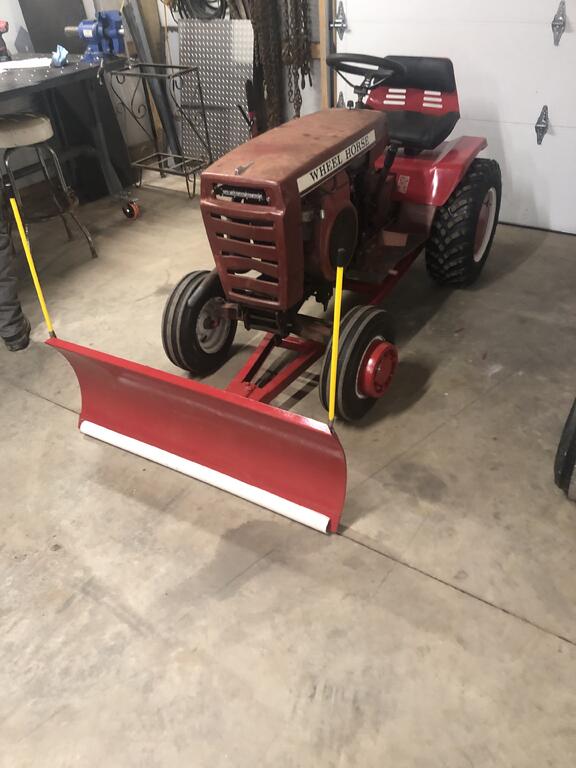

Why does the plow angle lever hit my brake pedal?
11 minutes ago, Blasterdad said:
Didn't the B-80 have a shorter frame than the C's ? That might be the problem...:confusion-confused:
They did... But ALL the difference was in front of the forward step mount.
It's been years since I did this thread and 4 or more tractors with that plow.. I don't remember what I did to solve the issue in the end.
Blasterdad
I didn't see that @Horse Newbie dug this up...:hide::rolleyes:
Tonytoro416
I recently ran into this on my raider 12.  I lucked out cause the plow I have has extensions on it for a 520 so I was able to simply move the plow forward one set of holes. (At rear axle)
Edited by Tonytoro416
mike avad
thanks for all info mine doing the same thing on my B-80 am make a new handle for one of my dozer plows
