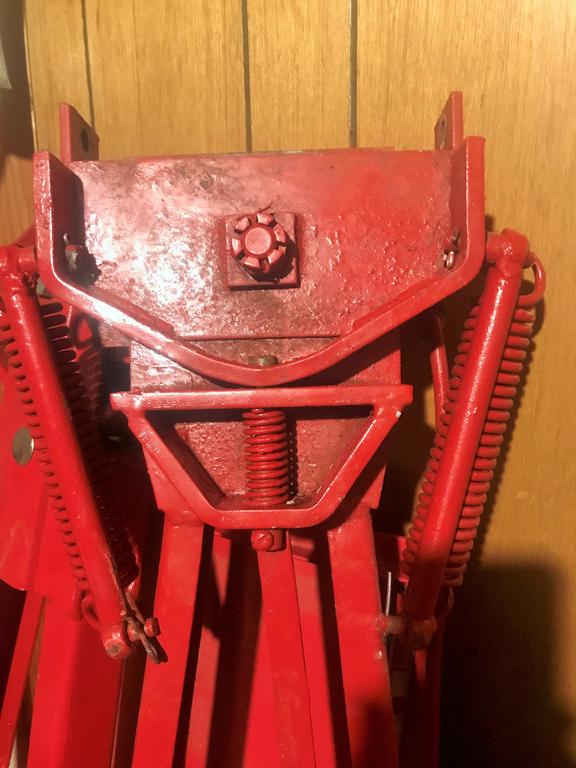

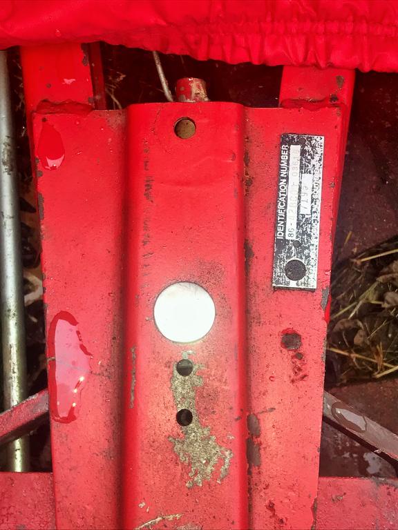

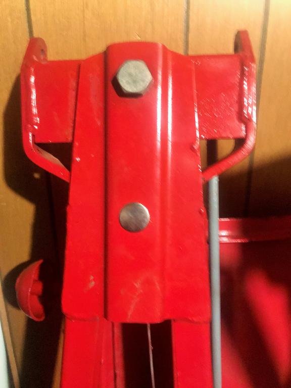

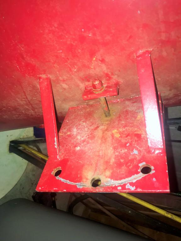

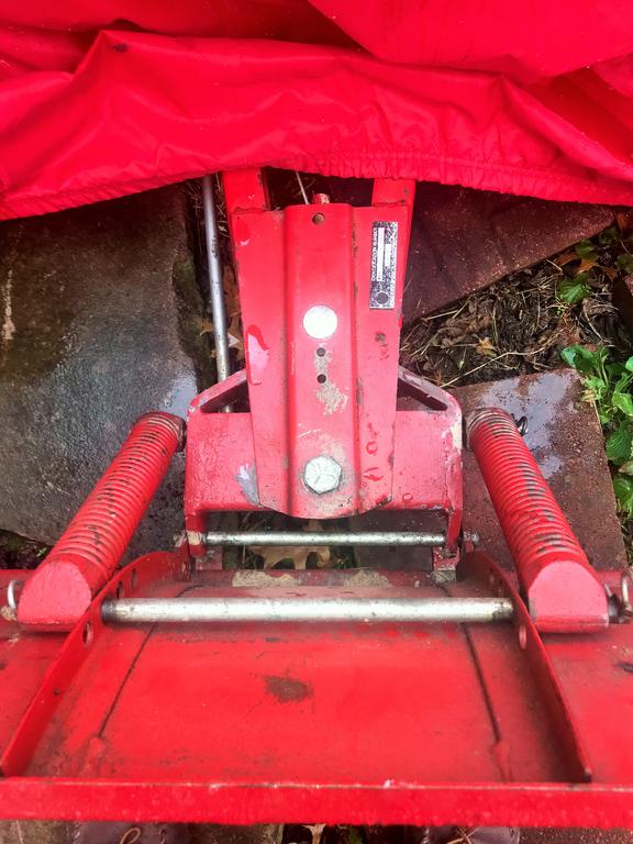

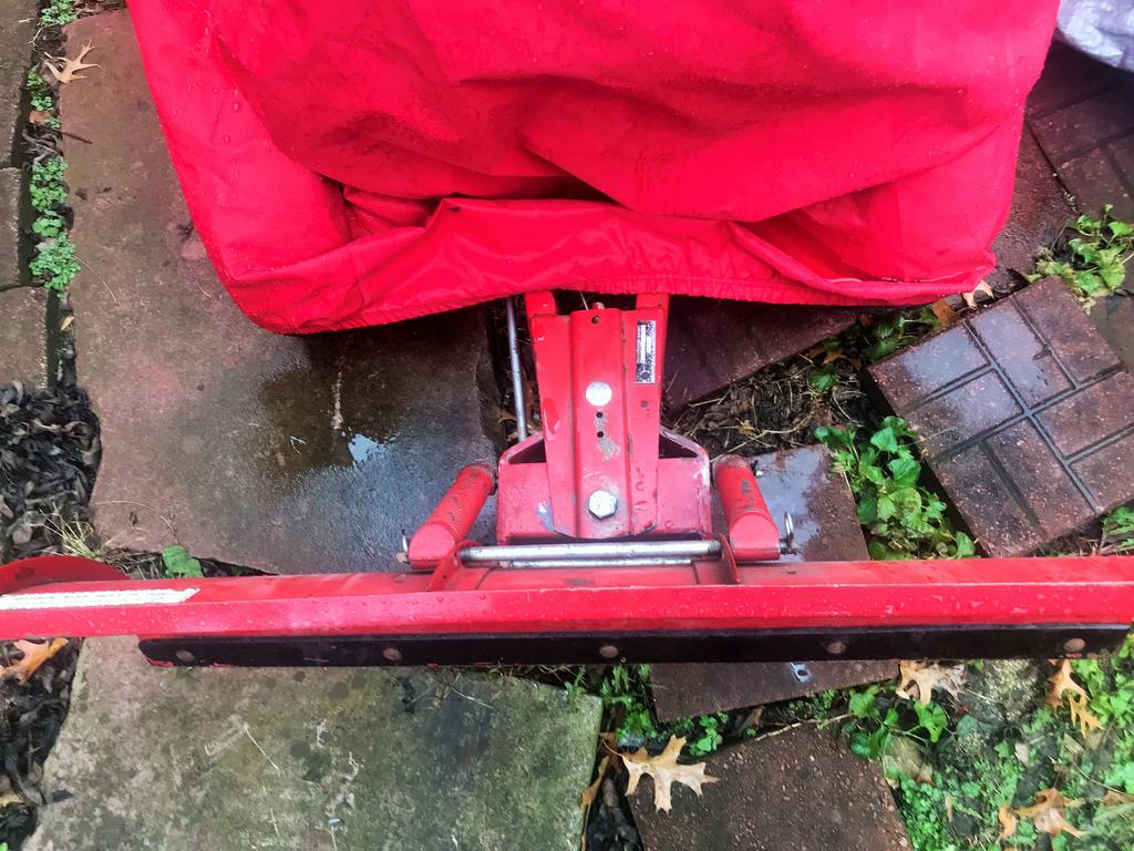

Lane Ranger 11,083 #3 Posted November 19, 2018 (edited) If you take the chrome cap off the plow frame and blow it out with an air compressor that will help. I add 3 snd 1 oil and I use a grease gun. The pin gets rusty, dirt does clog and the hole on the plow end gets blocked too. I had to replace a rusted cotter pin in that one inch hole on top the pivot rod one time. Holding flashlight in my mouth, needle nose pliers, and a screw driver holding back the spring that rides in front of the pin! A difficult operation to say the least! The first three photos are of my 42 inch plow on my 1995 314-8 It is interesting to look at the evolution of this snowplow/dozer blade in the front end. The next photo is of the 54 inch plow for my 1054 from 1964 The next photo is of my 1962 BD-4262 Snowplow/dozer blade And fina; photo is of a RH Snowplow/Dozer Blade Front End Edited November 19, 2018 by Lane Ranger 2 Share this post Link to post Share on other sites

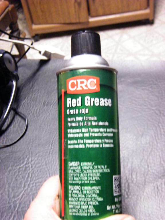

stevasaurus 23,002 #4 Posted November 19, 2018 High pressure washer may clean it out Eric. Nothing wrong with a little oil from a can...especially one that has a trigger and shoots it. If you want something a little thicker, they make a Red Grease in a spray can. Got it at Farm & Fleet...CRC Red Grease. 3 Share this post Link to post Share on other sites
