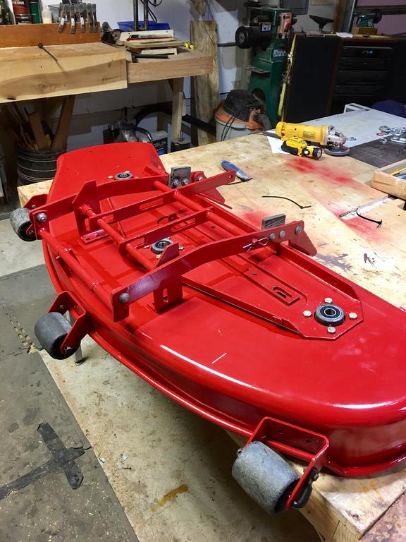

Here is the final setup. Thanks to Lincoln at A-Z for the pulleys and belt guards. I even finished it off with Terry's decals.

peter lena
nice work on that, if you regularly drop that deck and scrape it down , let the sun warm up the  bottom , thats just the opposed  of the life it lives , and then oil spray it down , you can retain all your work. metal of any kind needs a lubrication feed to stop the acid/ grass grunge build up. your finish work , deserves  a regular clean up and oil down , just my own experience, pete
