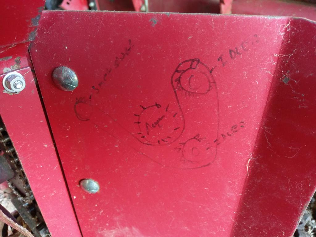

Schrec050584 2 #9 Posted November 19, 2018 Which nut on the outside is it to tighten the chain? I cant see a slot. Is it the upper or lower one? Have a pic? Share this post Link to post Share on other sites
gwest_ca-(File Mod) 11,148 #10 Posted November 19, 2018 You can see the adjuster slot in this picture - bottom sprocket. Garry Share this post Link to post Share on other sites
WVHillbilly520H 10,374 #11 Posted November 19, 2018 Use this diagram it will help you with the adjuster nut, Jeff. Share this post Link to post Share on other sites
