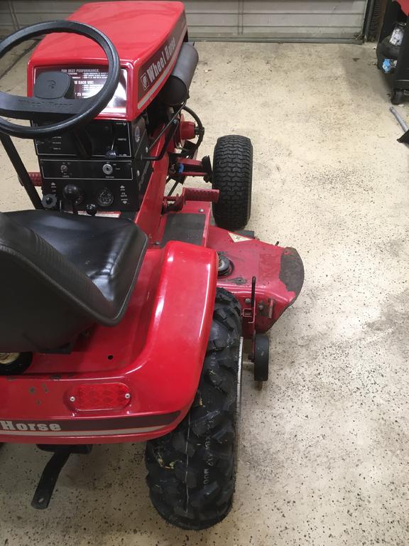

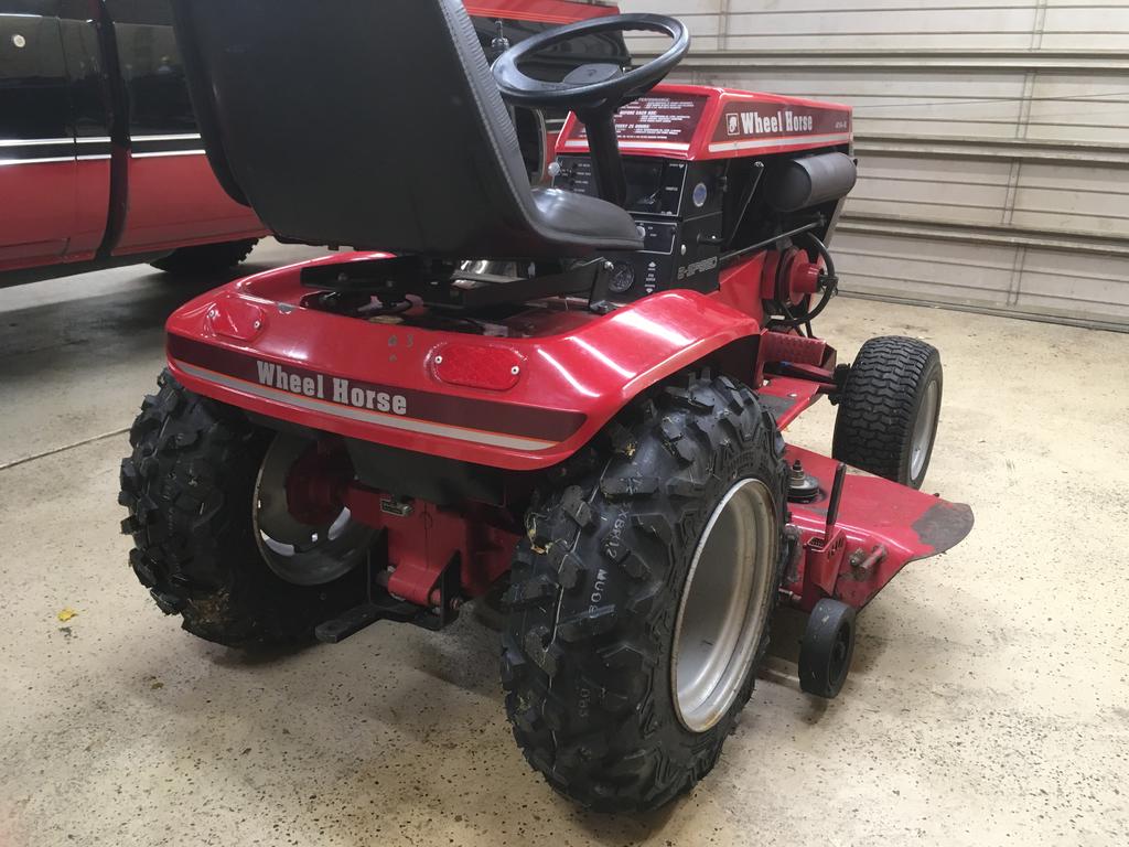

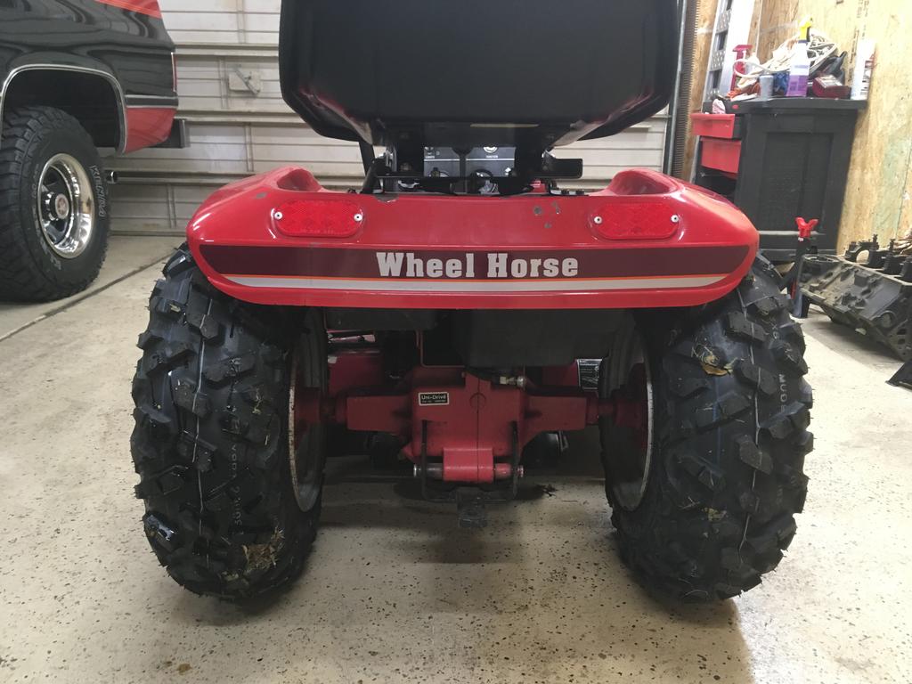

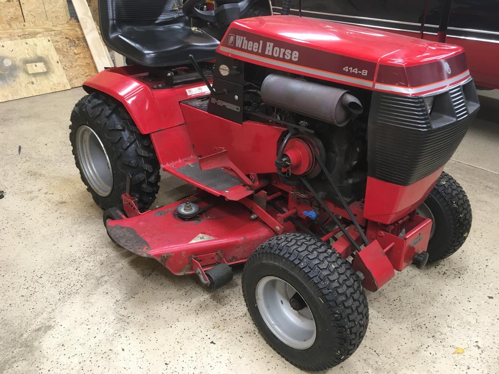

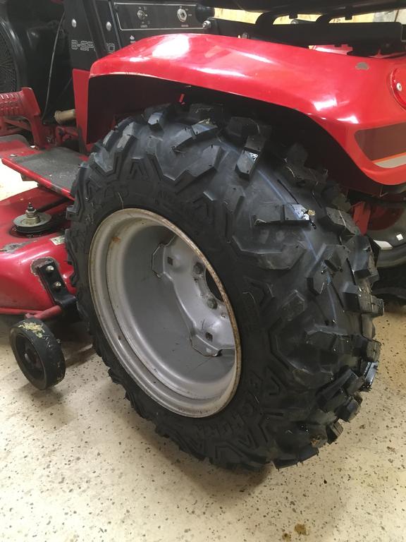

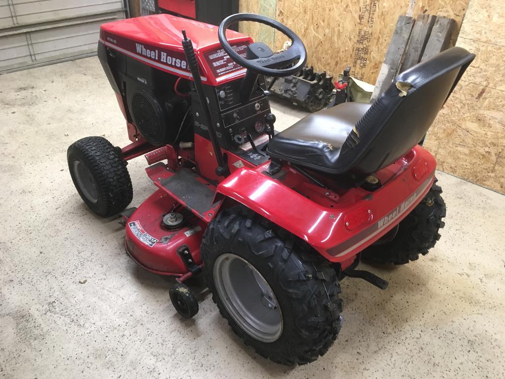

JoeliusZ28 77 #1 Posted November 15, 2018 (edited) Just got these installed last week, they're Maxxis Bighorn 2.0's in 23x8-12. I couldn't find *any* pictures of this tire mounted on a tractor anywhere, so I figured I'd post them up for others to reference. I'm regretting not going with the 10" wide size as they ended up being a little narrower than i expected (they look narrower than the stock tire to me) and I don't think the extra width would have sacrificed any traction. That said, I'm confident they're going to work just fine. They are filled to the top with beet juice and have quite a bit of weight to them. I use this tractor to cut grass, run the snowthrower, and I am hoping to use it for plowing/discing my garden this spring too. Was planning to use my wheel weights in combination with this but I don't even think it will be necessary. Edited November 15, 2018 by JoeliusZ28 7 1 Share this post Link to post Share on other sites
WVHillbilly520H 10,376 #2 Posted November 15, 2018 Adding the extra wheel weights will only enhance your traction in the garden or plowing/blowing snow, they do look aggressive on your ...i have these in my ATV...Sedona RipSaw... Share this post Link to post Share on other sites

JoeliusZ28 77 #4 Posted January 28, 2019 Figured I should report back on the performance - these things are phenomenal in the snow! Better than my chains/turf tire combo by a mile. If I ever need more traction i still have my wheel weights and hitch weights i can toss on. Highly recommend them but make sure you get them fluid filled! 1 1 Share this post Link to post Share on other sites
