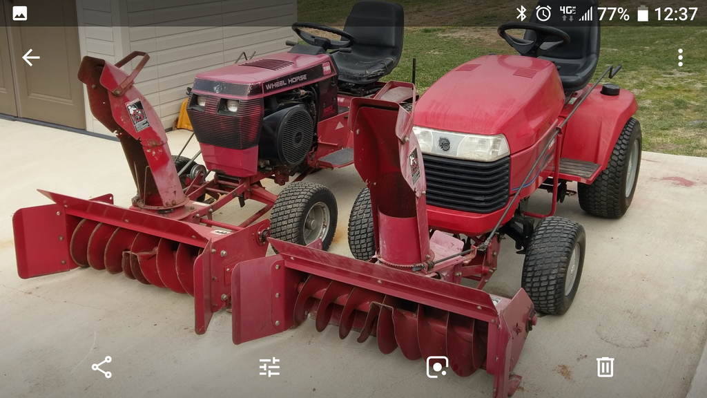

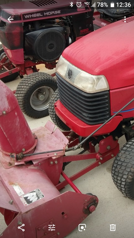

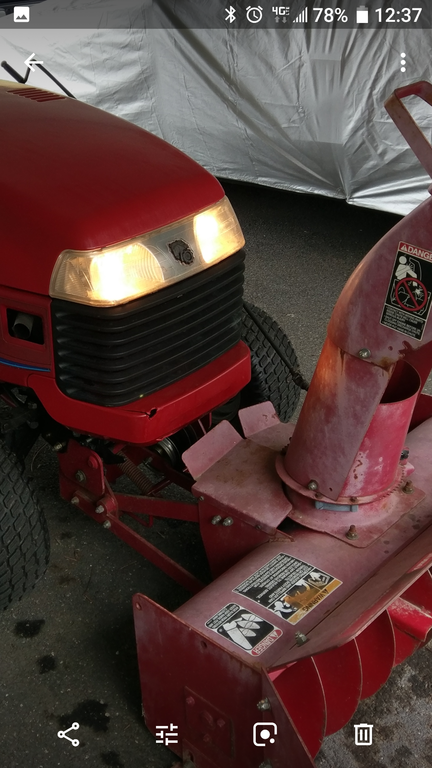

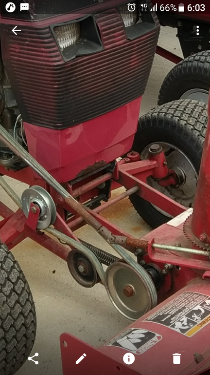

I honestly believe it's not worth the time and effort, just because the HC/classics snow thrower PTO drive and mounting points are so different from the xi and I've had both series as you can see from my pictures quite the difference, as many of the classic style throwers out there I'd wait for one of those, Jeff.

BTW, the 5xi series are of the horizontal engine, the difference is the the crankshaft is longitudinal with direct shaft drive vs transverse like the HC with belt driven transaxles, Jeff.
