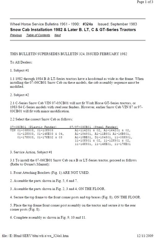

I am looking to see if anyone else has a snow cab with these mounting brackets.  I have checked the manual section with no luck. Model number on the cab is 07-06CB01.  I am looking for some pics of the mounting points.  I know it is for a B-C series tractor but The PO had it mounted on a 312 but it was removed when I bought it.    I am hoping someone else has done this too.
This file may give you some hints. Click on the fuzzy picture so you see the notes and you can download the 3-page file from there
This one is what you need to end up with - 13 pages

I tried to download the 3 page file a few times the other day and it would not download but the 13 page one does but it is not the same model I have.  Looks like I have to wing it.
I just downloaded the 3-page file so don't know what is wrong.

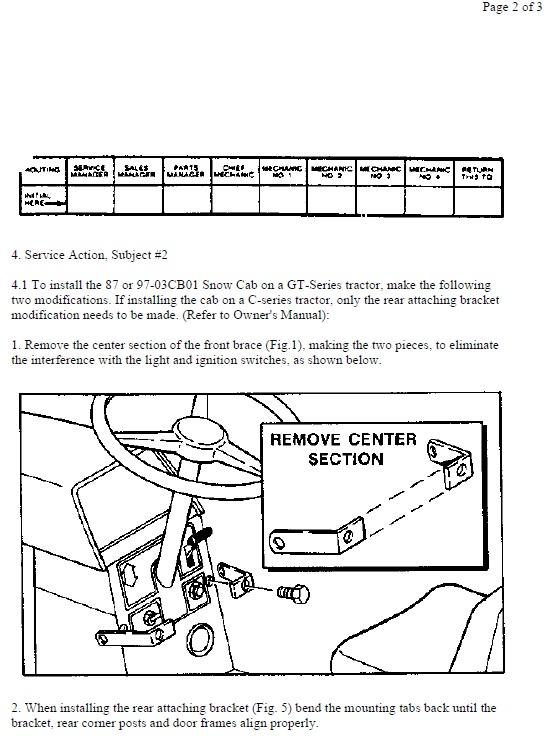

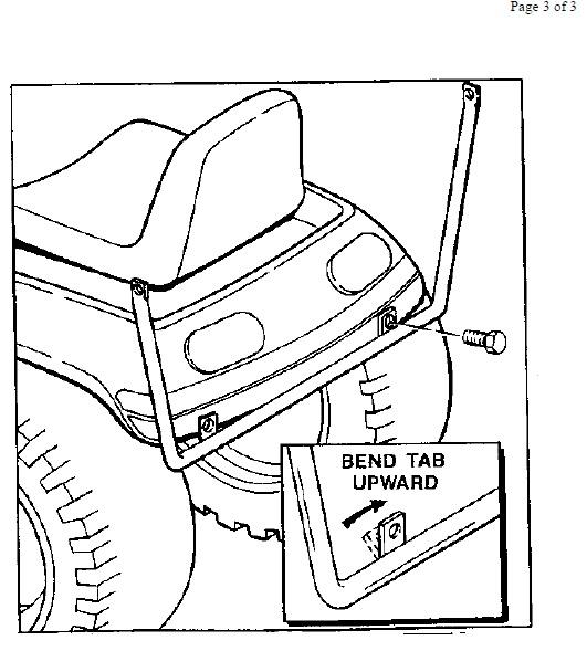

Later models may give you more ideas
