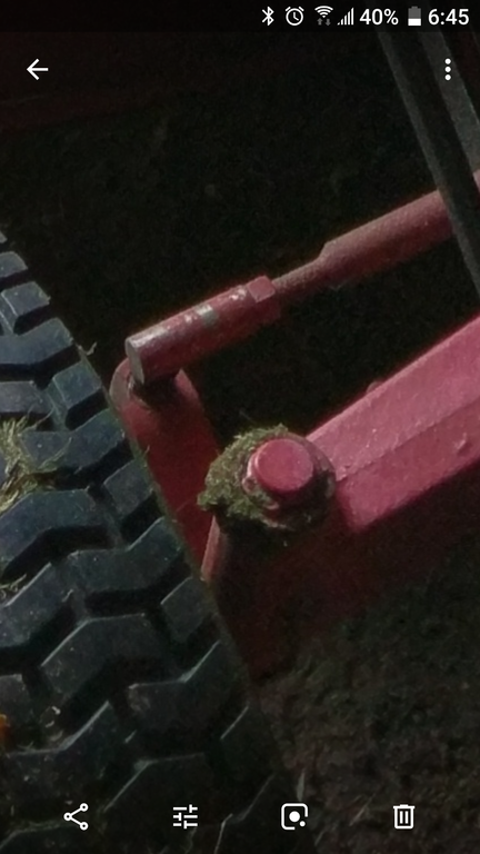

Will this 60" deck fit a C-161?  Will any 60" deck fit??? Thanks
cleat
It will physically hook up but you likely could not steer.
The front wheels will hit the deck.
You would need the swept front axle.
I have not mounted my 60" deck in 2 years. The 48" does the job almost as quickly.
It does take some power to spin that beast as well. Makes the 20HP Onan grunt.

I had a feeling that it may hit the front wheels.  I have the power to turn it as I just swapped a 22hp Predator on my C-161.  I guess i'll just find a nice 48" and live with it.
cleat
There are swept axles on ebay.
Any axle from a 520 will fit your machine.
You will need the spindles and wheels as well unless you can somehow bush your 3/4" spindles to fit the 1" holes in the axles.

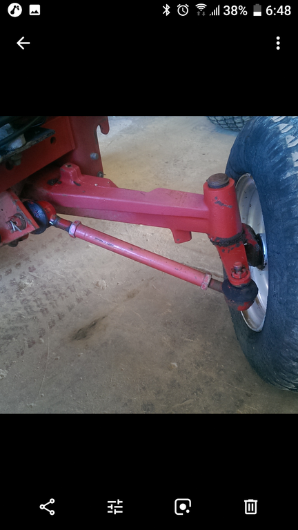

I never thought that was possible.  Is that axle any wider then mine or just swept forward?  Do I need the tie rods too?
roadapples
It's about 4" wider OA. YES you will need longer tie rods...
WVHillbilly520H
The tie rods on the 520s (top) are automotive type vs those spindly little 3/8 style on all the others(bottom)...

Nice.  Is there any pics or anyone who has done this swap?
cleat
If you get all the parts it is a simple bolt in (you might need to drill 2 more holes in the frame if you go with the reduction setup but that is simple to do).
Cheapest way is to find an old blown up 520 and harvest the parts required then sell what is left (swept axle assemblies often sell for more than an entire 520).
You could even put your old parts back into it and sell it more or less complete.
If you find a 1990 520 or a 520HC it will be non reduction steering but with all the other goodies.

What do I need? Axle, tierods, spindles and wheels?
Is this axle the same width as old one?
cleat
As Roadapples said, axle is around 4" wider.
To make it a complete bolt in, you will need axle, spindles, wheels, tie rods, and either lower steering shaft from a 1990 model or the complete gear reduction steering gear assembly that includes upper and lower steering shafts from a 1991 and up model.
