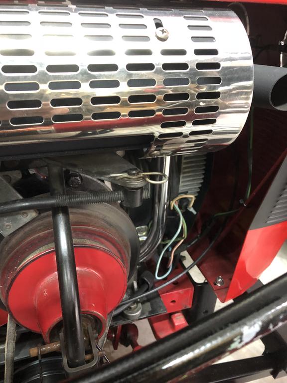

This is probably an easy one but I haven't had a chance to mess with it so I thought I'd ask the experts and hope the answer will help others.  I finished up the FEL for my 520 a while back and I think I have the hydraulic leaks sealed up.  I've noticed that once in a while my PTO disengages on its own.  I'm assuming I need to adjust the engagement lever rod but I'm not sure without fiddling with it.  I hope to mess with it later this week but in the mean time, if anybody can point me in the right direction, I'd appreciate it.

The trunnion on the PTO rod was just adjusted out too far. I screwed it in about a quarter inch and all is good. 5BB5B296-4D1D-4AB5-A9F3-701449F4CE36.jpeg.fdb61e163b097c56eb33ab04787a9c83.jpeg
