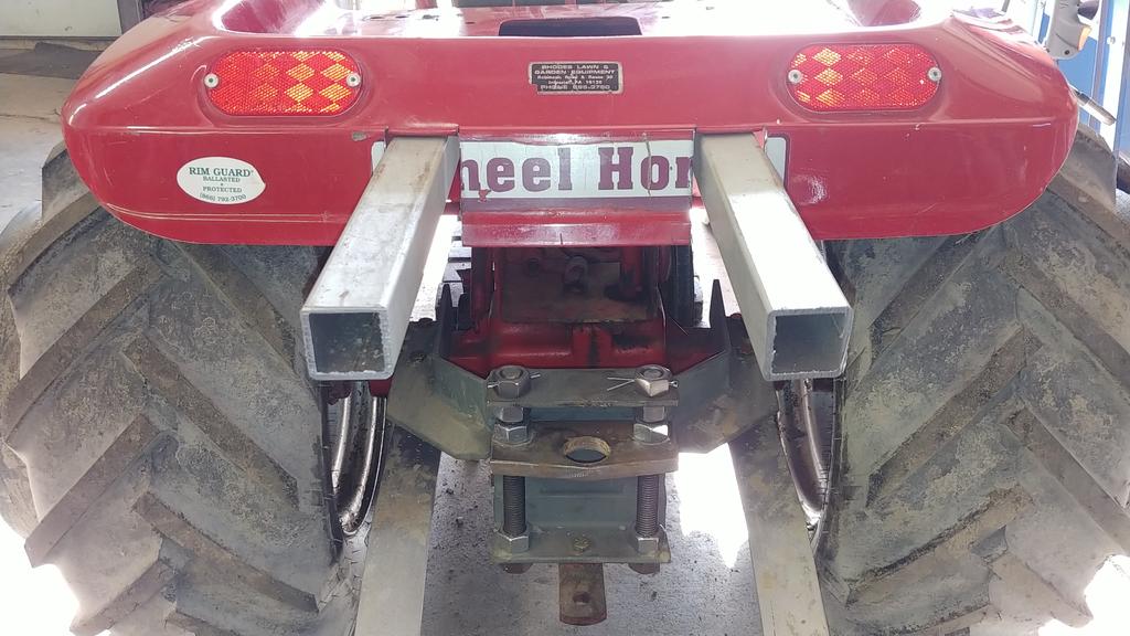

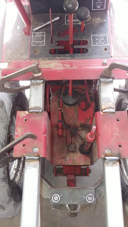

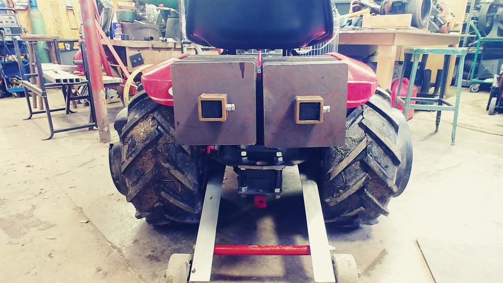

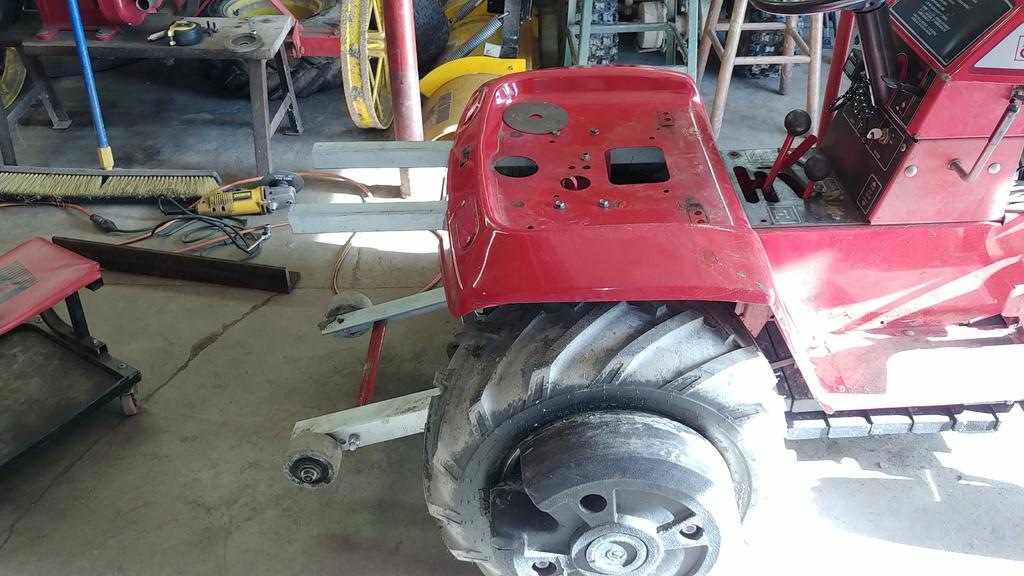

Well I decided to make a weight bracket to hang more weights on the rear of the little puller after Saturday's pull.
Ralph S

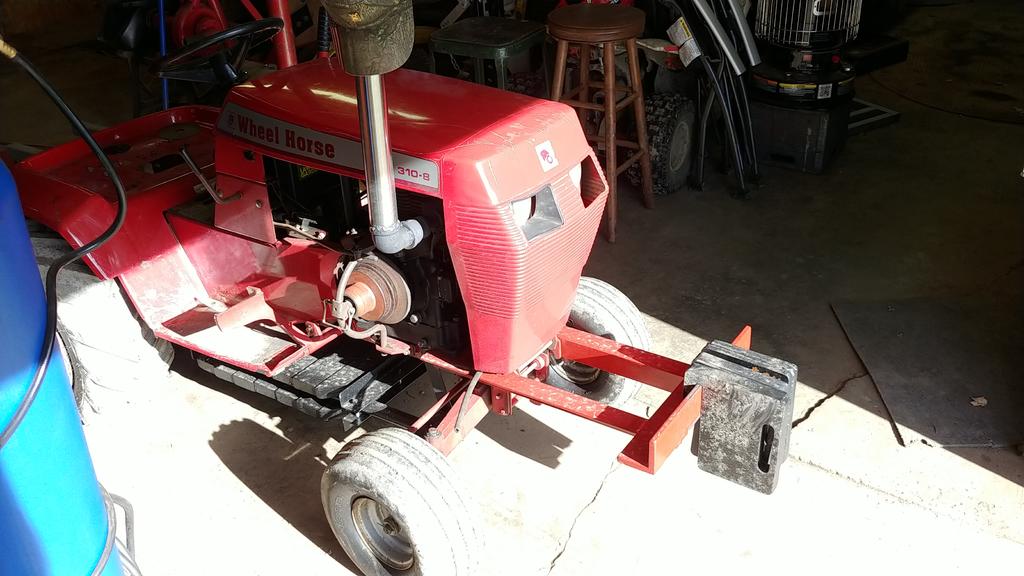

I installed a front bracket too so that I can juggle weights where they are needed

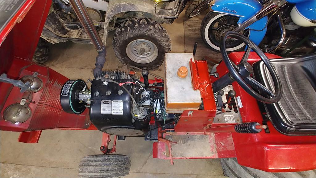

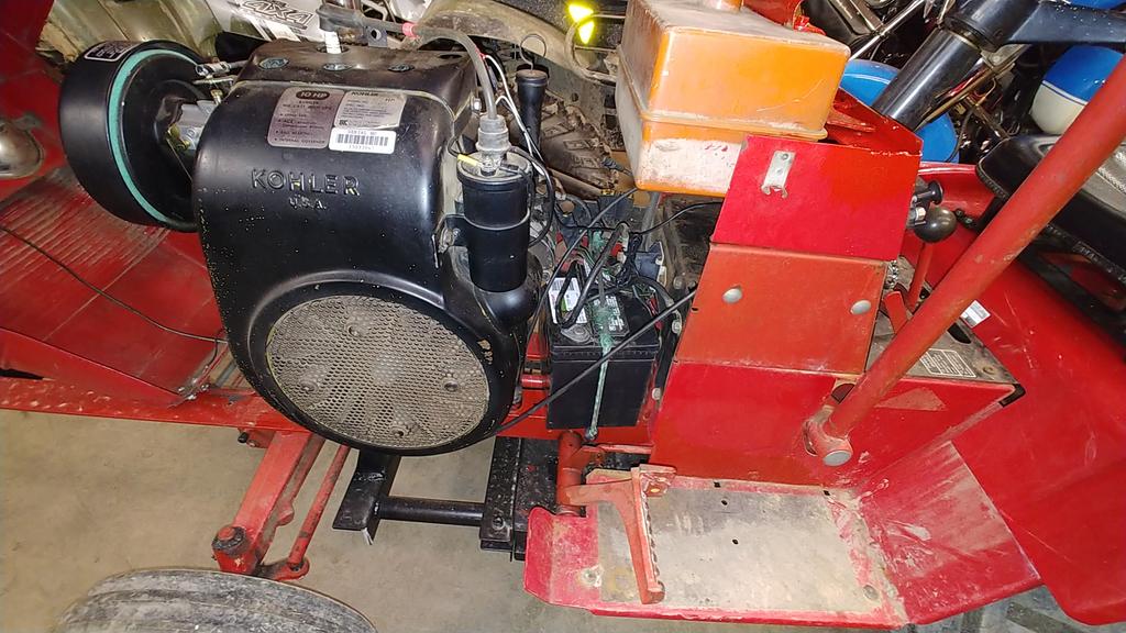

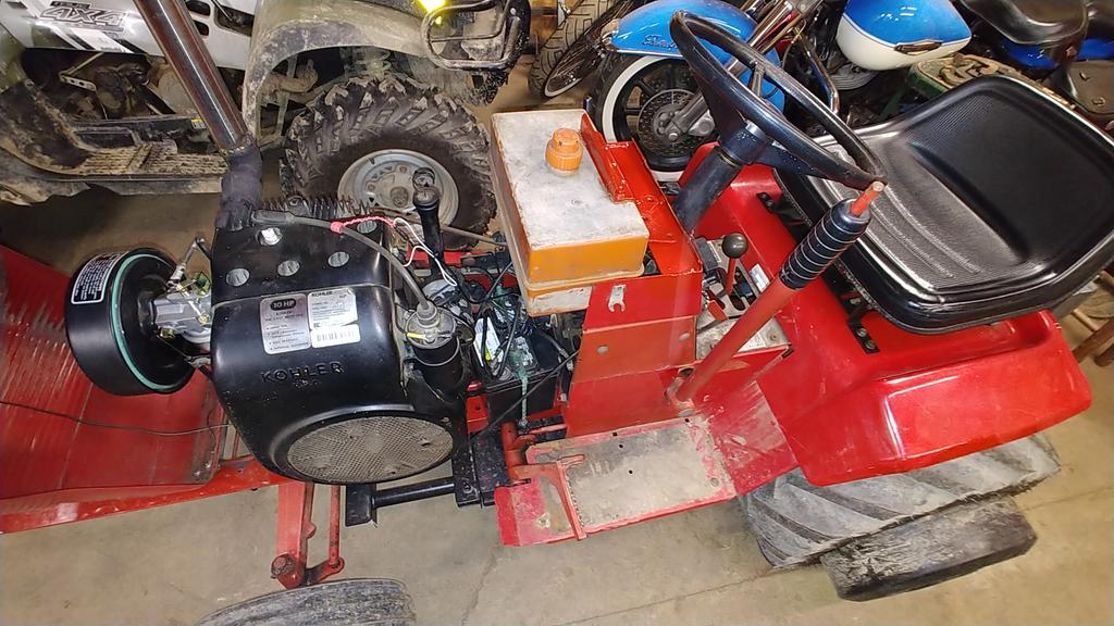

I relocated the battery and fuel tank too. LOL the things we do to stay occupied

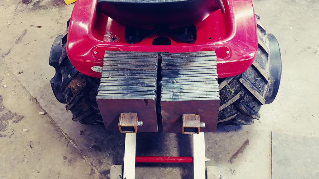

I'll bee at 1500 lbs. Weight class now. I changed up the weights in the front to the same style like the rear so I can balance it out to keep the front low while it's pulling

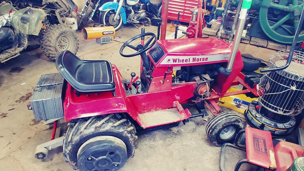

Ralph S
I've got the rear weights on. I'm ready for big knob and Portersville.

How much weight is on the back? Looks like it is easy to adjust.
Ralph S
38 pieces at 6 lbs.each. all I need is a 1/2" wrench to adjust the weight
Ralph S
This will put me at 1500 pound stock

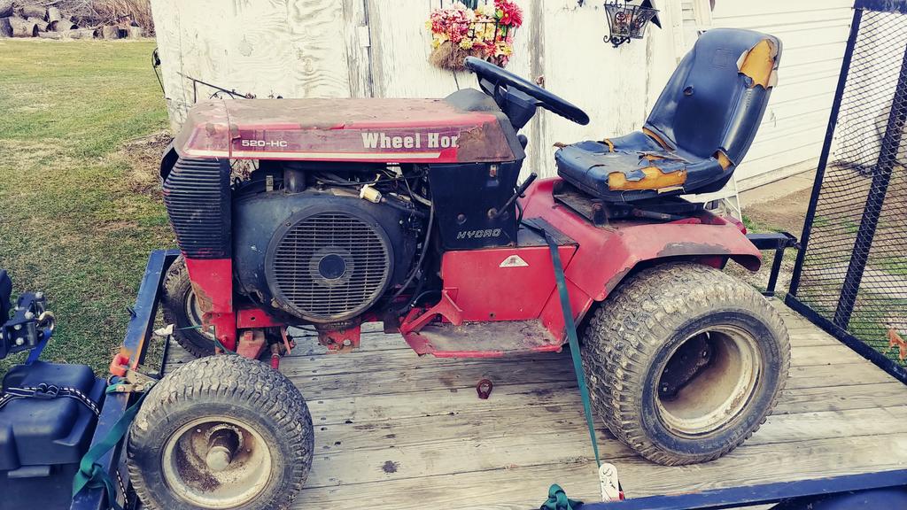

I just picked this 520hc up yesterday and had it running and driving today

I found a hitch and a bottom plow for it and plan to use it for plowing and disking. Who knows ? maybe make a litttle side cash with it plowing gardens.
Right around 230 lbs
