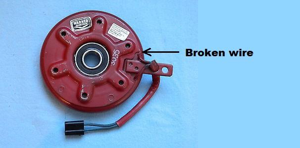

Has anyone had success removing and reinstalling the coil from an electric PTO clutch. The PTO on my GT-14 quit working the other day and I have determined that the positive wire where it enters the clutch has an open fault. If I push the wire in and move it just right the clutch will close. Paul @pfrederi did a great thread on the electric clutches but it didn't cover this particular problem. How bout it; has anyone had success pulling the coil out and putting it back?

I fixed one off an Ariens with that problem, ground the epoxy out around the wire repaired it . Verified it worked and
refilled epoxy area.

Didn't work well for me. I had the same problem. Clutch would only engage if I played around with the wires. Finally I removed the coil from the housing and tried soldering the wires in the coil, but it just kept shorting at the next weakest place. After soldering several different places I finally gave up. Called a local electric motor repair shop that would make and install a new coil in the old housing but the price was salty. I wanted to keep the machine original, so I was ready to pay to have it done when someone here offered me a used one. That was a year ago and I'm still up and running. Repair is worth a try though if you have a little patients! You could try an electric motor repair shop in your area. Perhaps they might be a little easier on your wallet! :D

The only thing being powered by this clutch is the Hydraulic pump for the front end loader. That pump doesn't need a clutch so I will probably buy a pulley to replace it and then play with the electric clutch later on;   got too many other projects going on right now.

I have removed the electric clutch and replaced it with a pulley because it only operates the pump for the front end loader.
