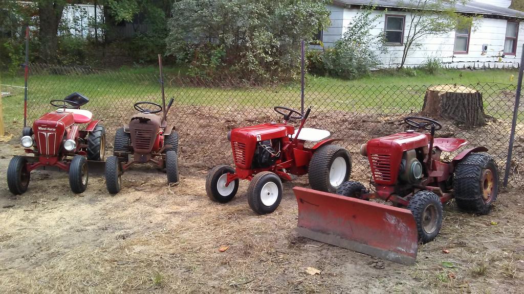

Rustoleum Regal Red and @Vinylguy‘s decals!

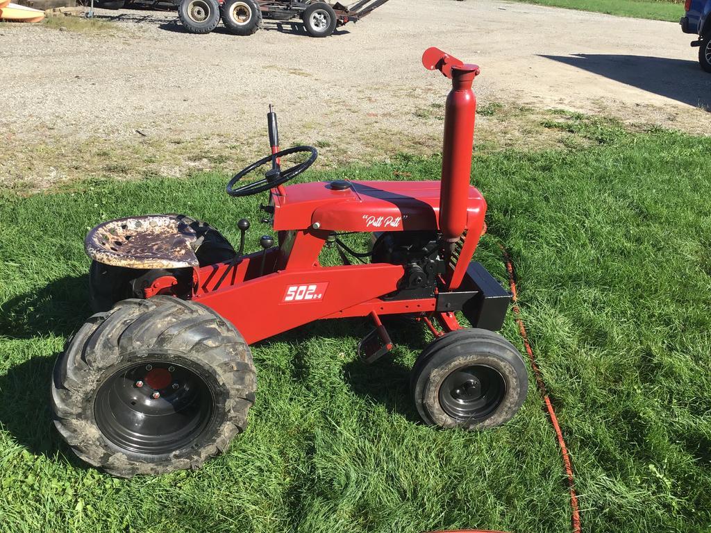

Here is my build thread on Putt Putt

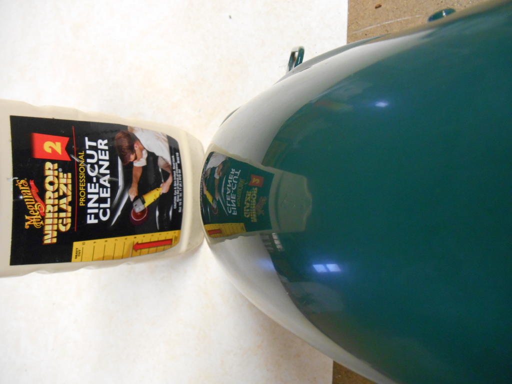

 I do like Rustoleum,but prefer it in the quart containers. The harbor Freight purple gun with the built in pressure regulator works for me. The red Rustoleum primer works as well and i actually prefer it to the etching primer. I do a light etch with oxalic acid first,then the primer,and then the paint. On the tractorsthat you want to lookolder, there isno reason that you cannot clear over the old paint if you sand it a bit with very fine wet or dry.  Practice first on the BACK side of some panels and you will know if all this fuss is for you.
 You can also add hardener to the paint,but it is something that can be deadly if you inhale the fumes.
 Even if you make mistakes while learning to paint,color sanding and buffing can correct minor orange peel. I use wet or dry sand paper from800 to 1600 grit and soapy water.It does not take much sanding at all before you buff. Here is a Rustoleum job color sanded and buffed
