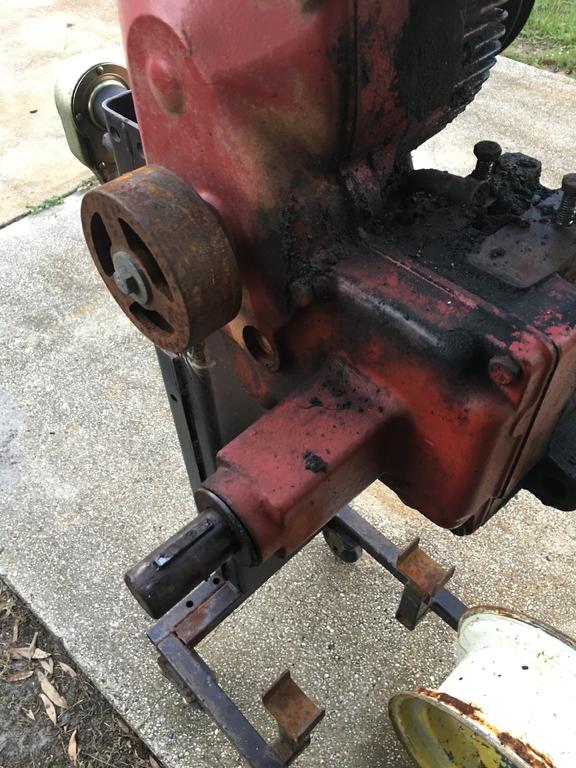

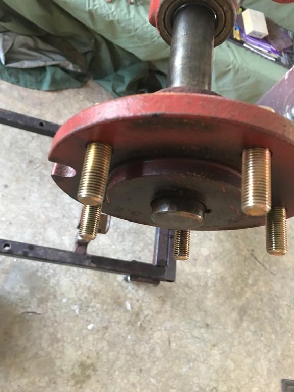

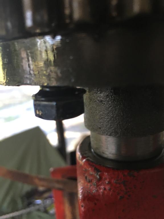

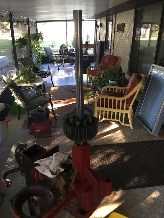

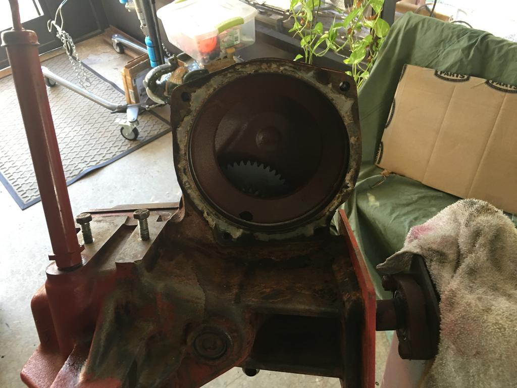

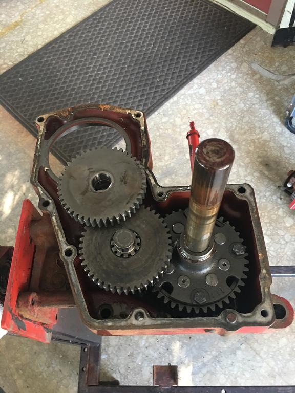

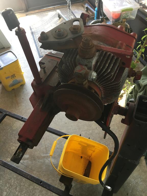

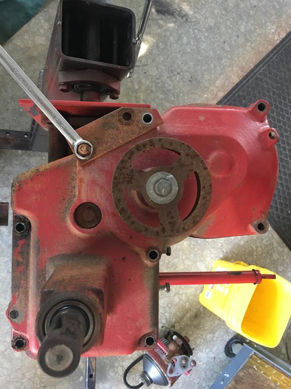

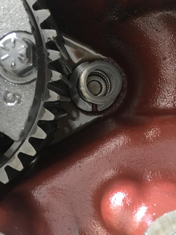

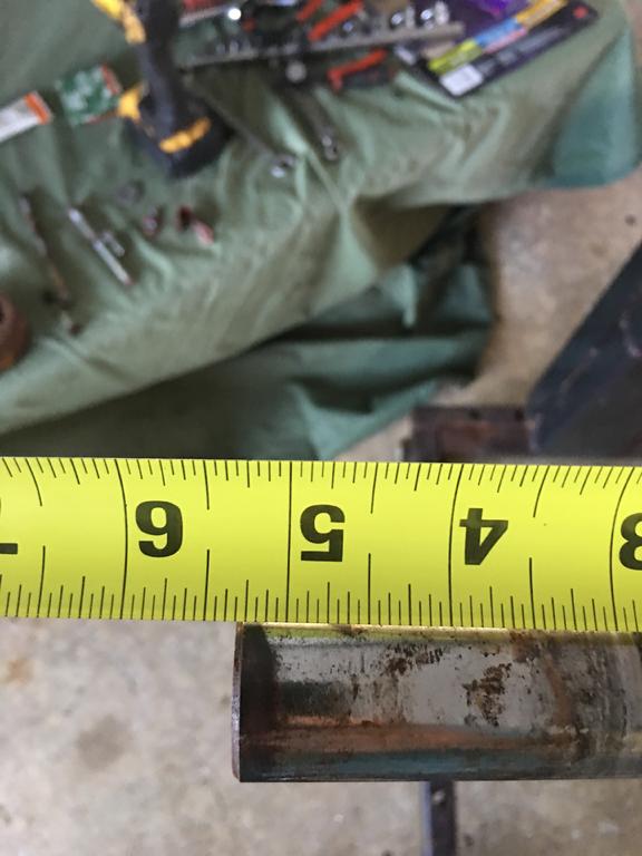

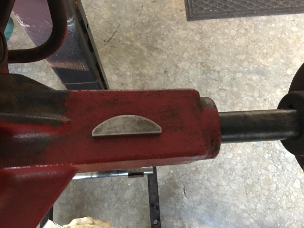

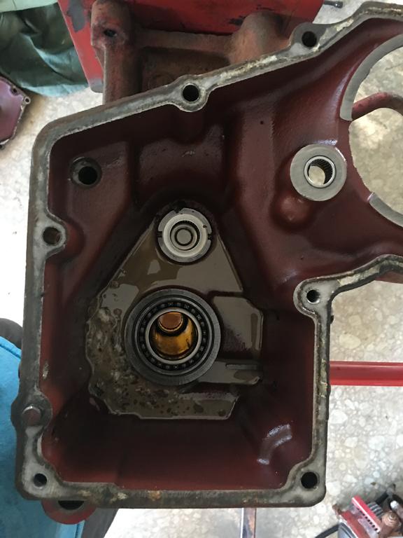

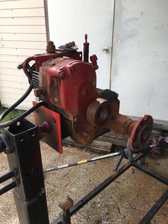

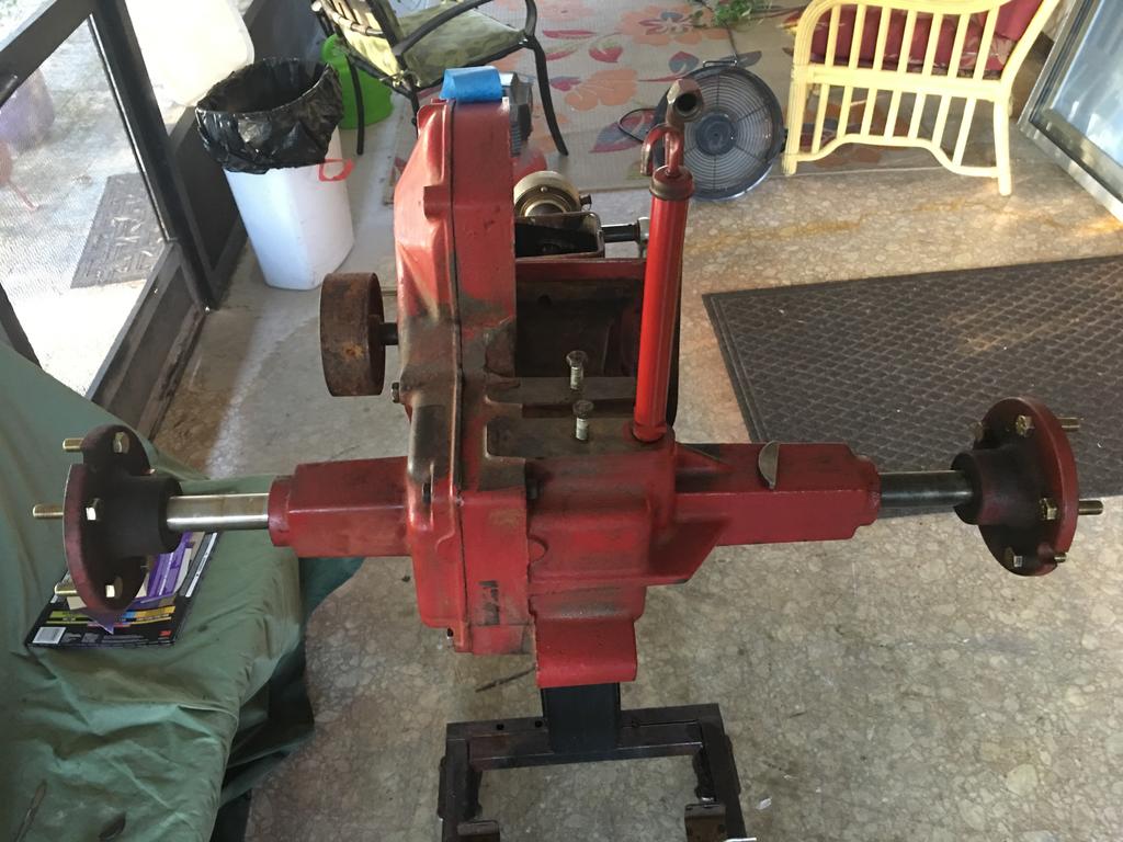

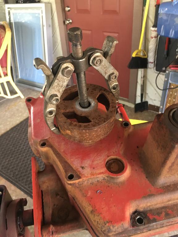

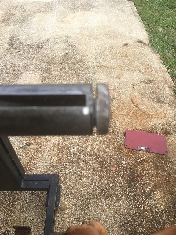

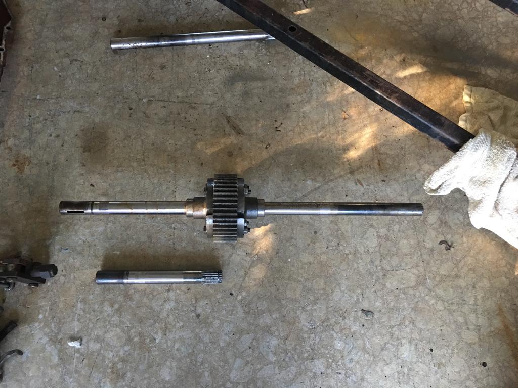

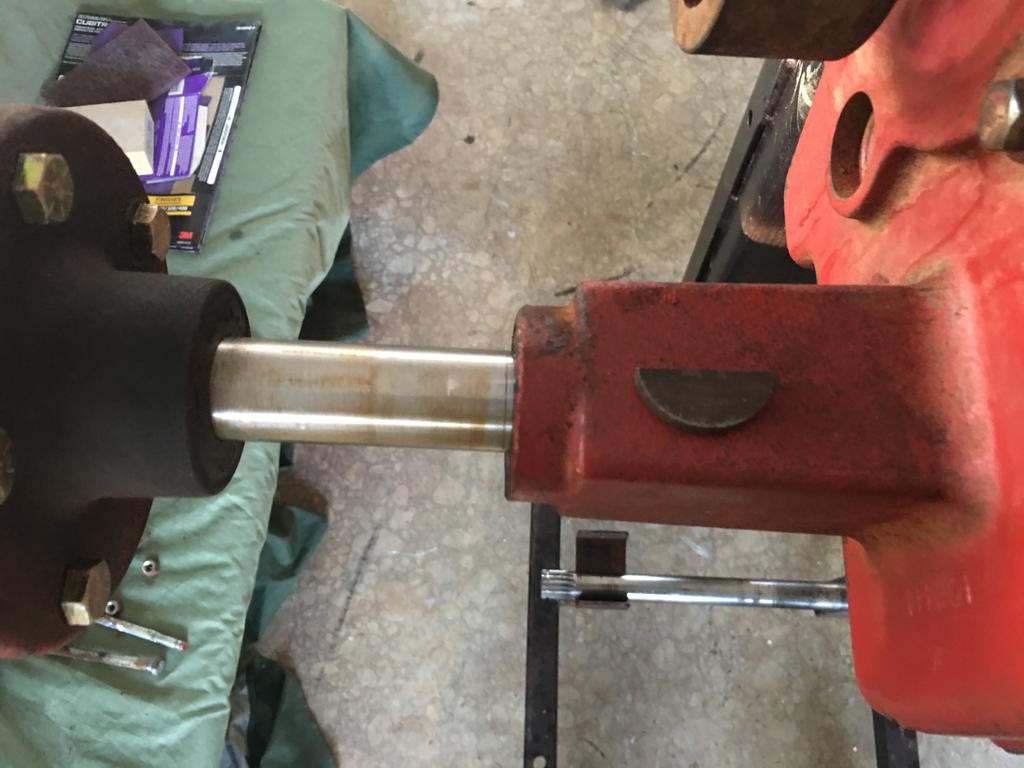

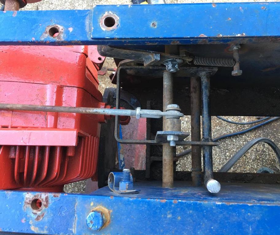

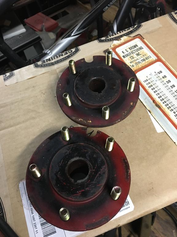

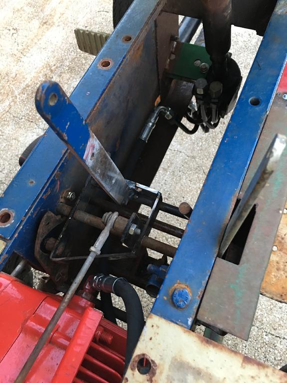

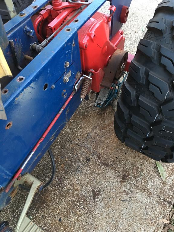

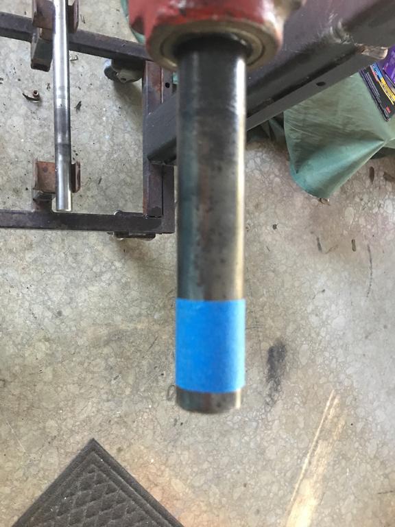

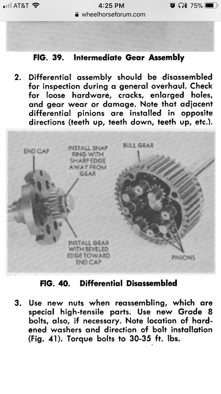

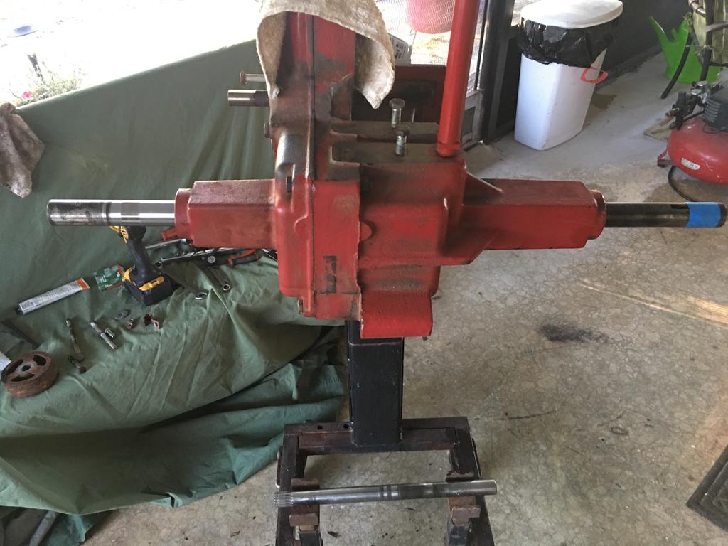

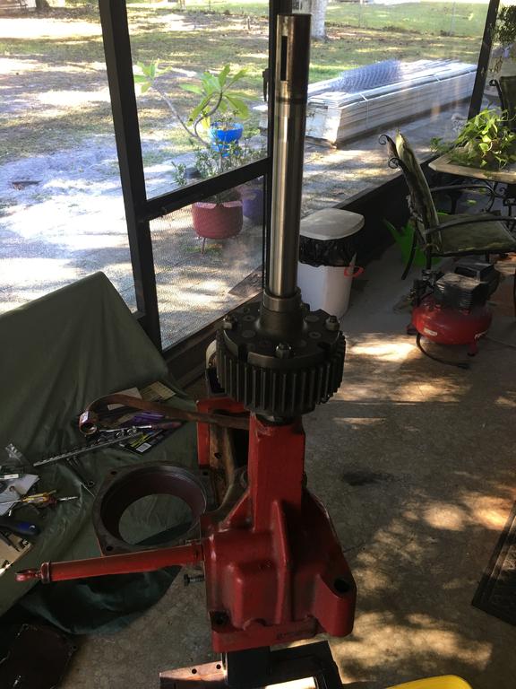

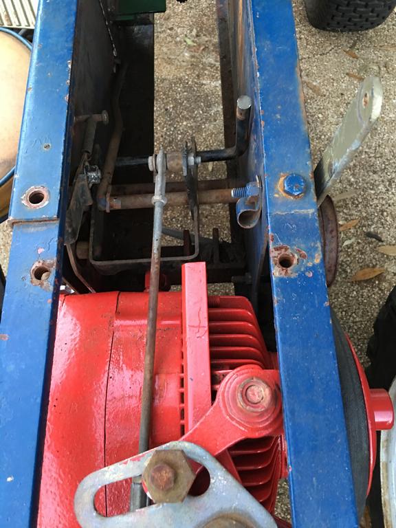

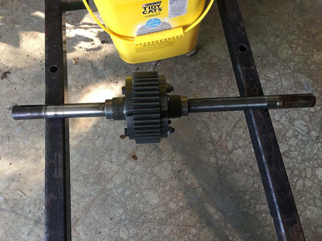

19richie66 17,765 #1 Posted October 21, 2018 (edited) This will be a picture “tutorial” of what I did to “widen” an eaton 1100 for my GT14. I wanted to replace the worn out sunstrand that was in it with a newer Eaton I had from a 520-H. The problem being is the stock gt14 rear transmission is 29-1/2” wide from axle tip to axle tip. The eaton is way narrower. I finally lucked out on a fix by accident and this is the way I did it. I will continue to add content as I can. This transmission is out of a 418-A I bought for parts. It is being widened in the same way to go in a 1054 for my wife. First I got it on the rotating stand I built. I then pulled the hubs which was a chore. After I got those off I degreased the transaxle and scrubbed all the gunk off of it. While the hubs were off, I installed lug studs in them, 7/16x20-2” tap bolts. loosen and removed the pump. This will also get a new pump to case gasket (part number 108319) upon reassembly. remove brake hub and bracket Split the case. Be careful pulling the case half off. The brake shaft can come out whith the case and there is a shim under it that can come off and end up in the bottom half. So here it is. The stock Eaton 1100 differential with axles. After you split the differential , you’ll find the left axle is 10” long. The right side axle is 13”. I then cleaned out the lower case and rotated it 180*. I inserted the whole axle/diff assembly into the axle housing backwards. This should give you the longer(right) axle facing up. Remove the four bolts hold the differential together. I removed the top axle, top diff case plate leaving the pinions in the bull gear and lower plate. Now remove the longer(right side) axle from the top differential plate. I then removed the shorter(left side) axle from the bottom plate and insert the longer (right side) axle in it’s place. Now take the shorter axle and toss it. I then took a D-160 axle(16-1/2”) and insert it back into the top differential plate. Reinstall it back onto the bullgear/differential assembly and reinstall the four case bolts. The bolts/washers come through the short side and nuts end up on the long side axle(right). Torque these to 35 ft pounds. If you remove the snap rings and gears off the ends of the axles, pay attention to the snap rings. They have a “sharp”side and a rounded side. The gears are also beveled. The above excerpt from the eaton manual shows the correct installation of these parts. I couldn’t get a camera to focus on the details. Long axle pointing up now. 👍 So now you should have an axle assebly that looks like this. A little over 30” from end to end. More on that in a bit. You see the old left axle laying on the ground. May as well install all new axles seals while it’s apart. These are part number 6449. I found these on ebay for less than $10 a pair. They are aftermarket but look identical to the original seals. They are double lip seals. We’ll see how they hold up. New brake shaft seal. CR 7443. New case gasket (part number 108312). Everything back in where it’s supposed to be. all back together with added width. Should be right about 5-5/16” to 5-3/8” sticking out the left side case. If you pull on the axles they will move back and forth a little. I go by 5-3/8” With that being the case, you end up having to cut about +\- 3/8” off the right side to get it the same as the left side. You will end up using a stock smaller keyway on the left side. You will end up with a larger D-180/GT14 size keyway on the right side. Doesn’t matter what hub you run they slide right on. You can use 4 lug Gt14/953/1054 hubs, 6 lug D series hubs or the standard 5 lug hubs. They all fit 1-1/8” axle shafts. Aldon runs 6 lug hubs on his GT22-8, I have 5 lug on my GT14 with custom wheels. Your choice. The 4 and 6 lug hubs are wider with more surface area on the axle. Again, you have a smaller keyway on one side and a larger one on the other. Just depends on what you plan to do with the tractor your putting it in. People have been abusing eaton 1100’s with the smaller keyway axles. Also, all the puller preferred 8 speed transmissions have the smaller keyways too. Your choice. There you have it. A “widened” Eaton 1100 that will now work in a GT14 (of course the linkage and connecting parts will have to be modified a little). This one as said before will be going in a 1964 1054. That is what has to be cut off for the hub to sit even with the axle. This is what the cut is like. This is after the axle is cut and filed down. That’s it. I have been asked about this several times and wanted to make a video but I don’t have a camera man to help film so I guess this will have to do. Hope this answers some questions that some have had. I’ll continue on later about the linkage if anyone wants to see that. Any questions, ask away. Edited October 26, 2018 by 19richie66 2 16 1 Share this post Link to post Share on other sites

RandyLittrell 3,942 #6 Posted October 21, 2018 What is the total width when you are done with it Ritchie? The Eaton swap is looking like a great idea!! Randy Share this post Link to post Share on other sites

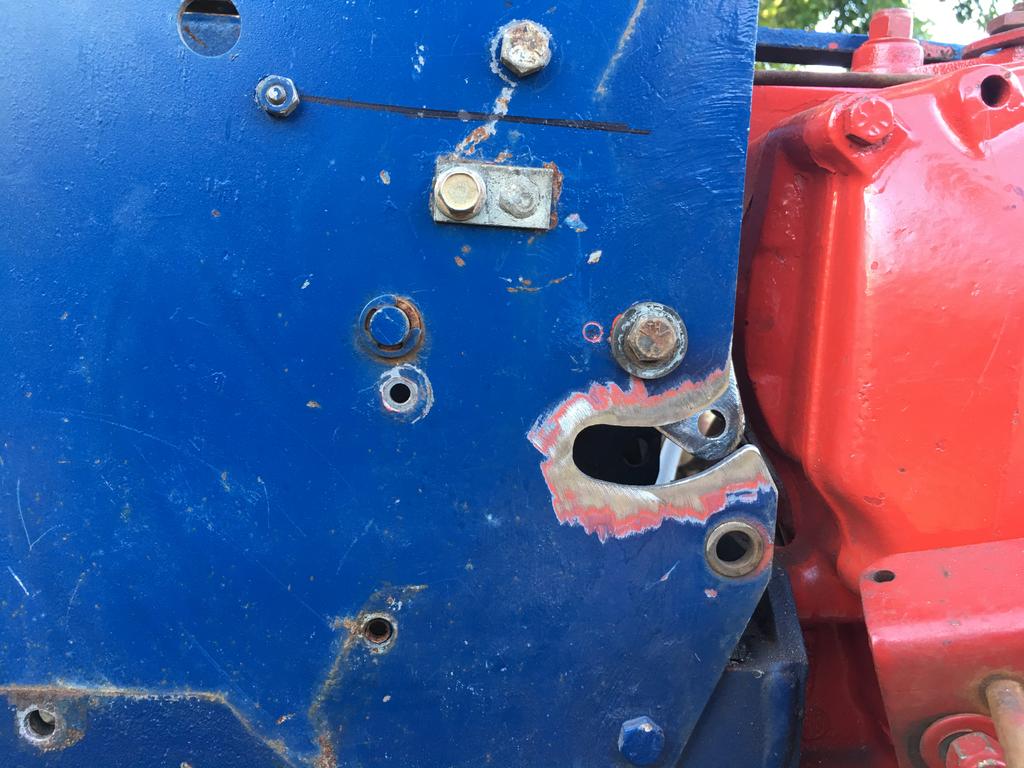

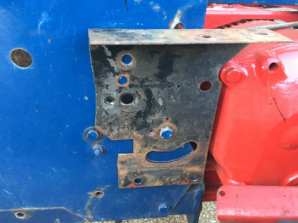

19richie66 17,765 #7 Posted October 21, 2018 5 hours ago, RandyLittrell said: What is the total width when you are done with it Ritchie? The Eaton swap is looking like a great idea!! Randy It’s 29-1/2” from axle tip to axle tip after you cut the right side to the correct length. I believe this is the same as the stock gt14 transmission. If you wver decided to do it, I have a pattern for the left side panel that has to be cut slightly for the brake rod/brake assembly to clear. Would be more than happy to provide measurements. I will try to include this in the write up as well. I’ll edit it later. 1 Share this post Link to post Share on other sites

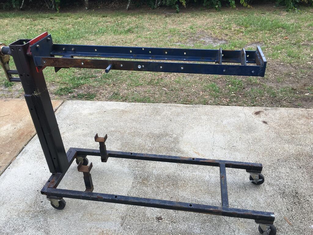

Thor27 846 #13 Posted July 13, 2023 @19richie66 Thank you for doing such a good job documenting this. Also, your transmission stand is a pretty awesome idea. 1 Share this post Link to post Share on other sites

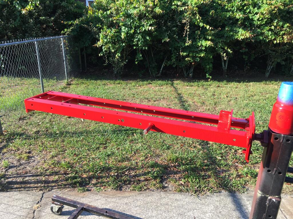

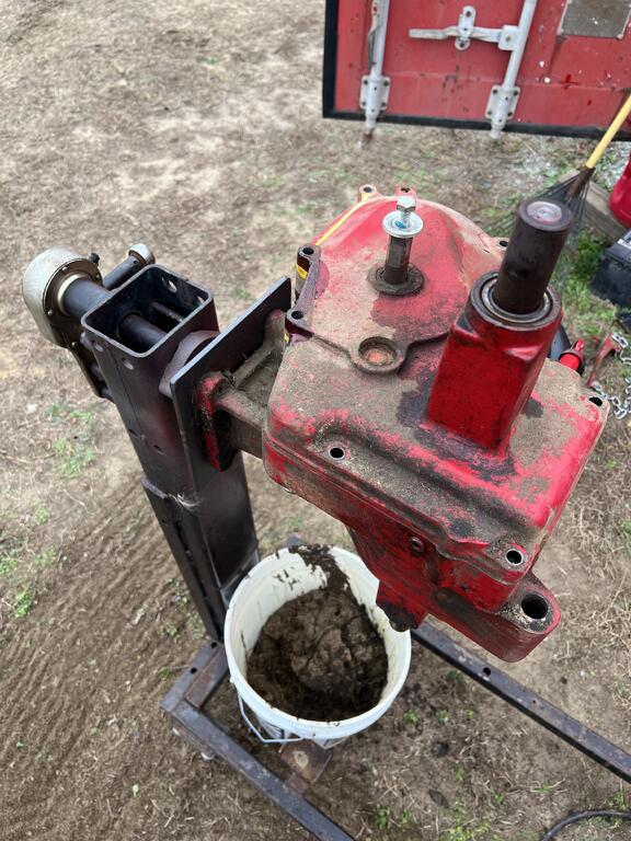

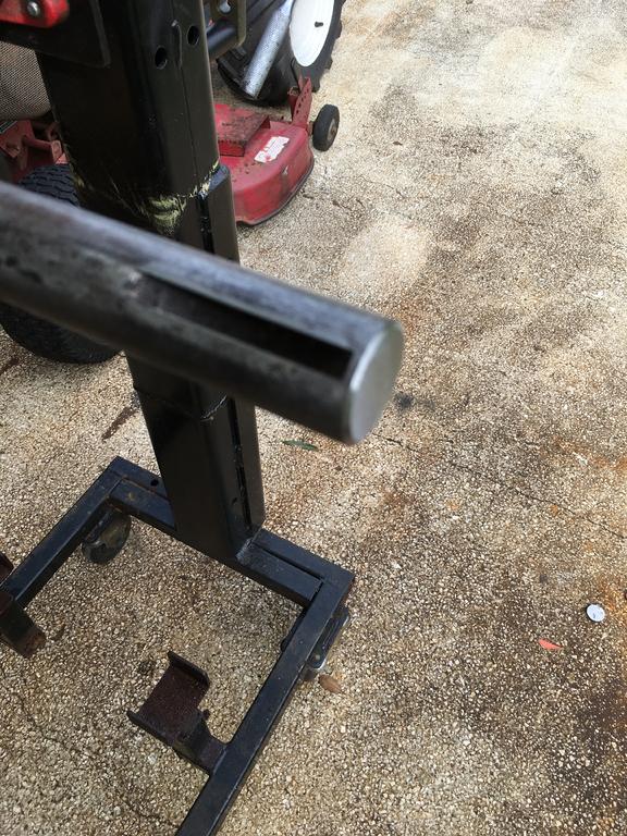

19richie66 17,765 #14 Posted July 13, 2023 (edited) 5 hours ago, Thor27 said: @19richie66 Thank you for doing such a good job documenting this. Also, your transmission stand is a pretty awesome idea. Thank you sir! It’s just some C channel I had and scrap steel plate. I got the slack adjuster(rotating mechanism) and actuator cam(shaft that runs through the bearings and rotates)from NAPA. Works great for frames too. I actually have a transmission on it at the moment I’m getting ready to split. Edited July 13, 2023 by 19richie66 1 2 Share this post Link to post Share on other sites
