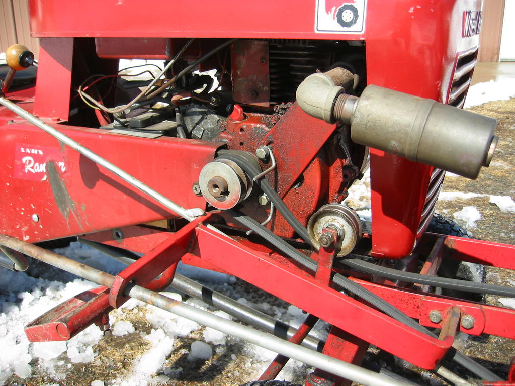

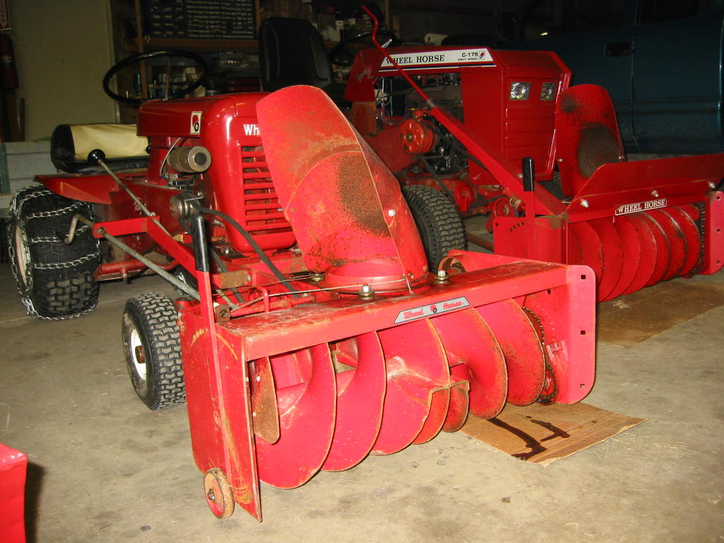

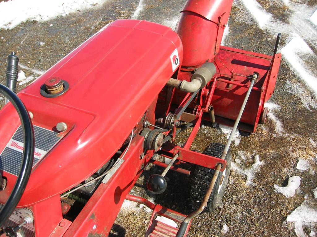

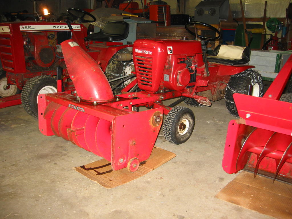

Here re some pics of when i had mine on the L-107  See anything different from yours?  What isn't working...
Paul Boy
Good pictures, thanks. I think I see my problem. Will try again tomorrow if the rain holds off.
