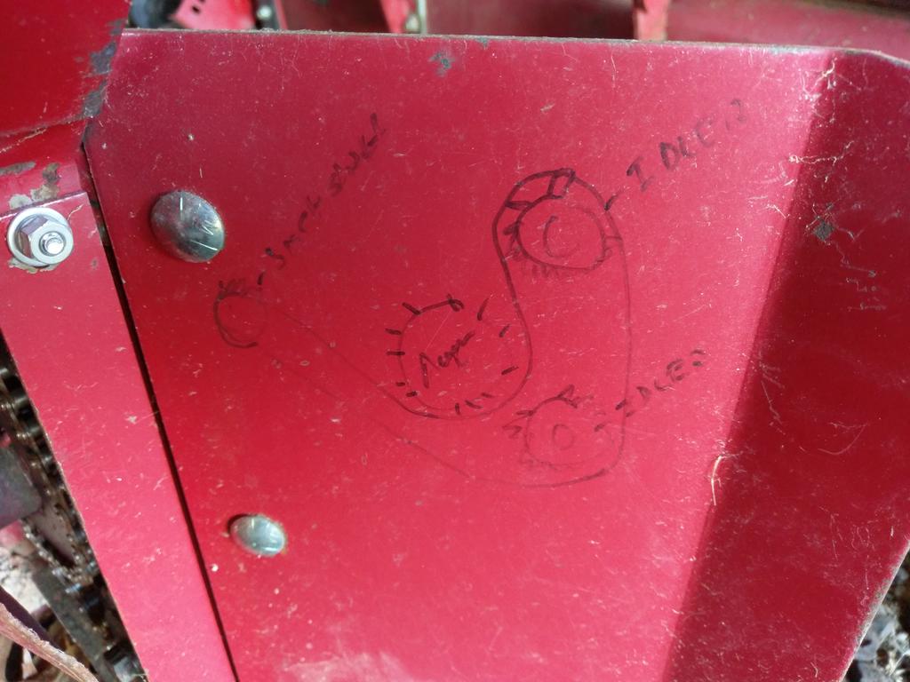

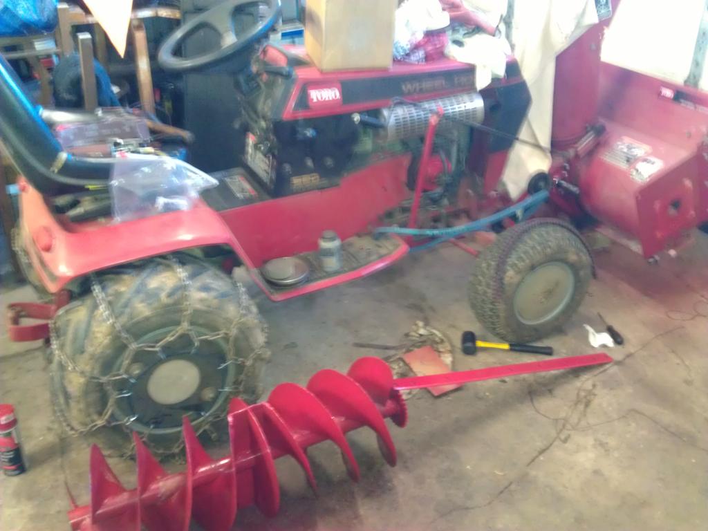

You do need to retension the idler sprocket after "dry" run and and again after a snow load SHOULD BE NO MORE THAN 3/8"-1/2" DEFLECTION ON THE LONGEST SPAN, those idler sprockets are little more than stamped steel pieces spot welded together that seem to wear out rather fast for no more use than these things see, I tore my old tall chute single down and replaced every sprocket (and mean every single one even the one welded to the auger itself) all the bearings pulleys and roller chain a few years ago before I found myself a 2stage  chucker, these tall chute single are just as effective as the deuce except in real wet stuff or DOT plow banks, Jeff.
