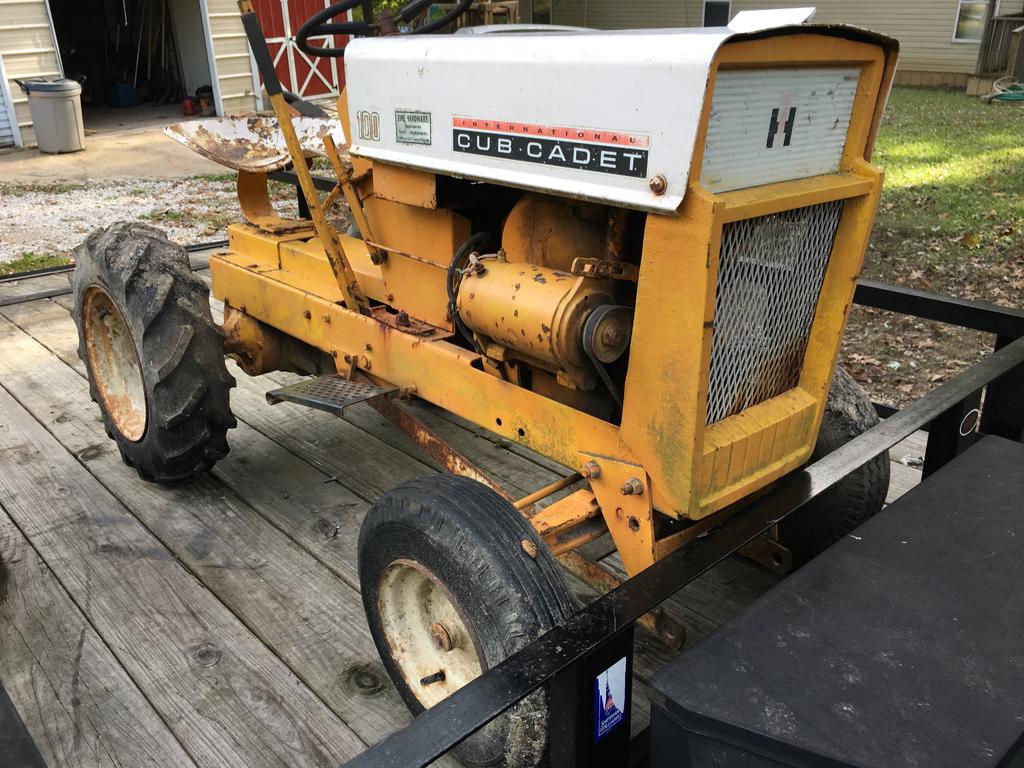

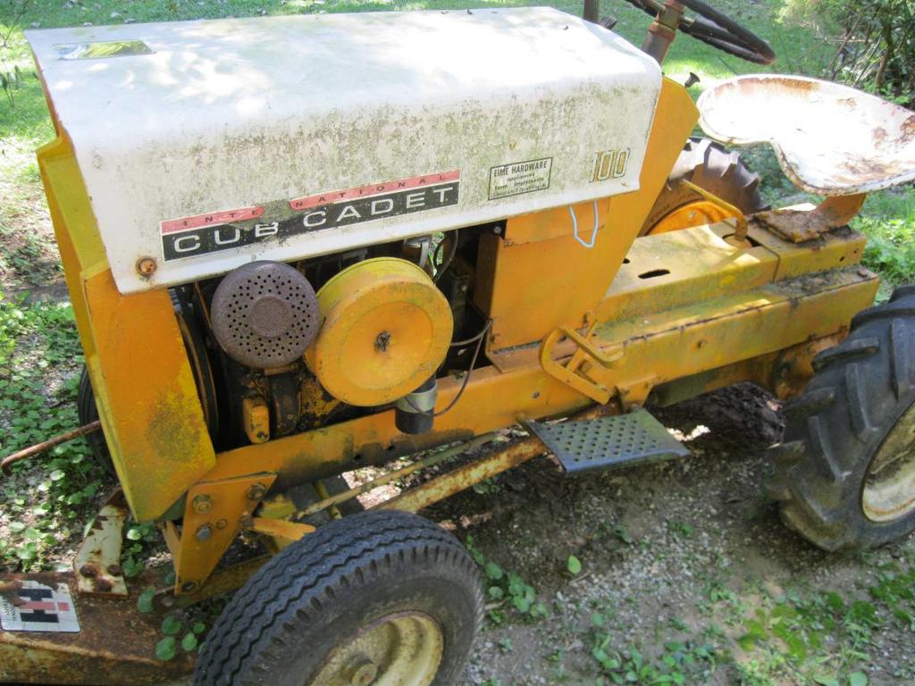

T-Mo-(Moderator) 4,533 #1 Posted October 17, 2018 Found this Cub Cadet 100 on CL. Ad says it still runs, but needs a "car" battery. It has the 42 inch front blade with it. Ad also says it's a 1960, which we all know is incorrect since IH didn't sell their first L&G until 1961, and it was the Original. The 70 and 100 came out later, in 1963. Anyways, it doesn't run and has at least the starter/generator froze up, if not the engine (let's hope not!!!!). Seller says it needs a coil, but I have to address that when I can access the engine and the S/G situation. It was a brother and sister who had it, it was their dad's who bought it new. They still have the operator's manual for it. Deck worn out long, long ago, and after seeing their yard, I can understand why. I told him the rear tires were on backwards, but he said they were always like that and I wasn't the first one to point that out. I didn't get it home until late last night, so the only pictures I have is from the ad. 10 2 Share this post Link to post Share on other sites

T-Mo-(Moderator) 4,533 #9 Posted October 18, 2018 Good news and bad news. I loosen the belt to the S/G to see which was locked up, the S/G or the engine. It was the engine....I pulled the plug and it isn't looking too good. I see rust on top of the piston and the plug was weird looking. All I had was a bit of motor oil, so I put a little straight through the plug hole and the engine turned just a tiny bit. I will get something a bit stronger, maybe transmission fluid, and pour a bit of that in and let it sit for a spell. Good news, the S/G isn't seized up. So, there's that. 2 1 Share this post Link to post Share on other sites

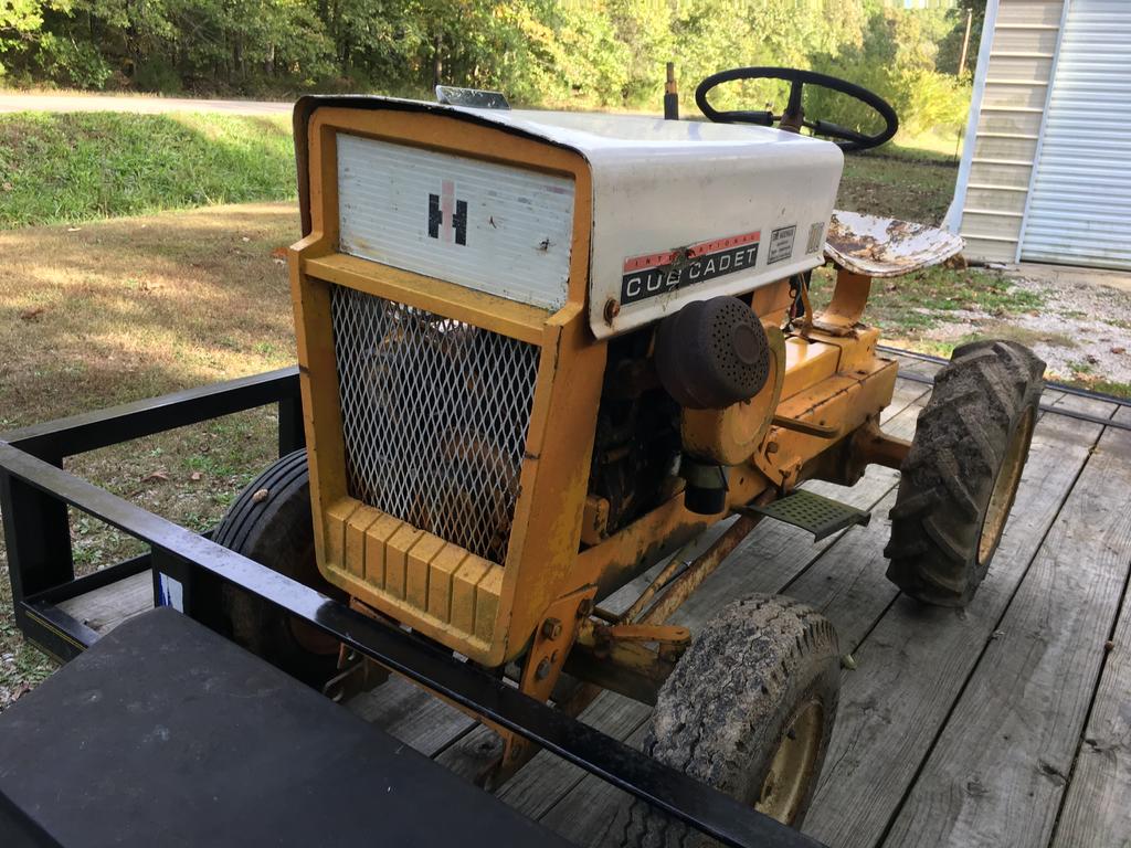

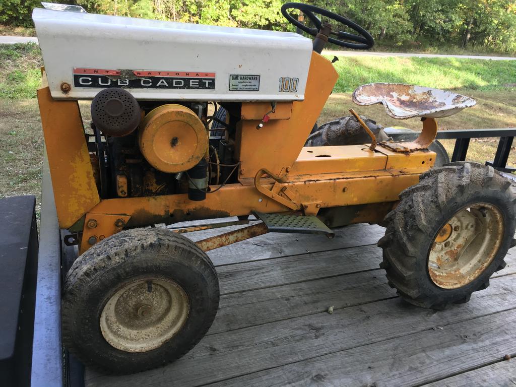

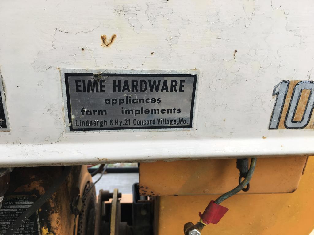

T-Mo-(Moderator) 4,533 #10 Posted October 18, 2018 Some pictures from before I got it off the trailer. It still has the original dealers tag on it. I haven't check the serial number yet to see what year it is. 2 Share this post Link to post Share on other sites

dcrage 629 #16 Posted October 18, 2018 Terry That dealer tag is for a closed hardware store in south St Louis county. I contemplated buying a used Cub from them back in 1990 when I purchased my 310-8. Share this post Link to post Share on other sites
T-Mo-(Moderator) 4,533 #17 Posted October 18, 2018 46 minutes ago, dcrage said: Terry That dealer tag is for a closed hardware store in south St Louis county. I contemplated buying a used Cub from them back in 1990 when I purchased my 310-8. I figured as much - I googled them and they come up on one link with an address and a phone number. The address is 11500 something like that Concord Village Road, which appears now as a Pawn Shop. The phone number takes me to a eye clinic. It's too bad small shops like that aren't in business anymore, which is par for the Wheel Horse dealers for the most part. I know IH used various type stores like hardware stores to sell their tractors and equipment, so it didn't surprised me that this Cub Cadet was bought new at a hardware store. Share this post Link to post Share on other sites

T-Mo-(Moderator) 4,533 #19 Posted October 19, 2018 Update: I pulled the drain plug and there were no metal shavings or parts in the oil - but a slight trace of possible water. The engine seems to be loosening up some, I was able to turn it more and I can see the piston moving now. I pour a mixture of transmission fluid and acetone in to loosen it up some more. On a side note, I couldn't live with the rear tires on backwards anymore, just in case someone excuse me of doing it. So I switch the tires around so they're now pointing in the right direction. 4 1 Share this post Link to post Share on other sites

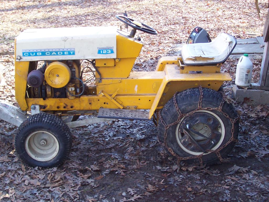

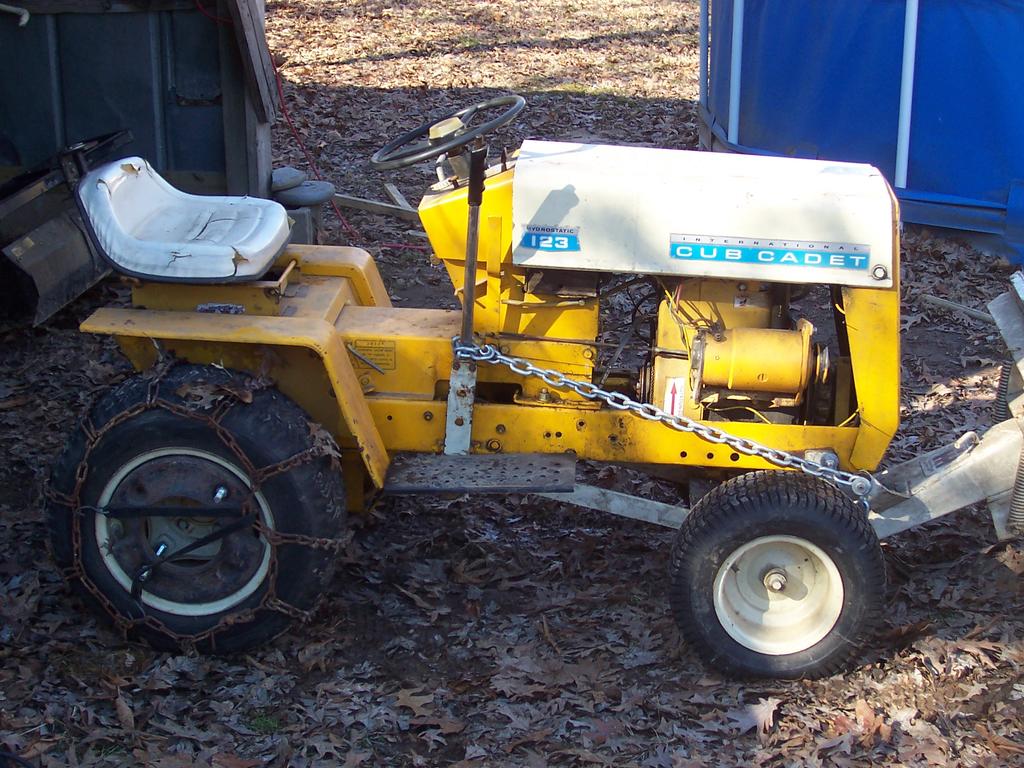

T-Mo-(Moderator) 4,533 #21 Posted October 19, 2018 Dave, I had a 123 - it was the first hydrostatic drive tractor IH built for the Cub Cadet line. I know a lot of people refer the wide frame CCs over the narrow frames, but I like the narrow frames the best. Yes, there is less room to work on them, but they're also cooler to look at. Here is my 123 that I had (I should have kept it and at least one of my 104s I had). 1 Share this post Link to post Share on other sites

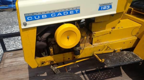

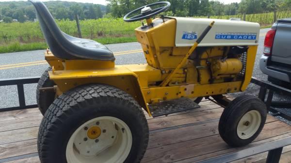

Mows4three 826 #25 Posted October 20, 2018 Thanks for all that info T-Mo. Good reading, for sure. I'm including a couple pics from the Craig's List post for the HI Cub 123 I mentioned. The guy wants $575 (might take less) and the machine looks very clean for what he claims is a 1965 tractor. Must have truly been shed/barn/garage kept. Cheers! Dave Share this post Link to post Share on other sites
