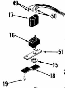

gwest_ca-(File Mod) 12,450 #6 Posted October 19, 2018 Would this arrangement match what you have? The pto switch #16 mounts with the terminals facing up. On the bracket that mounts the switch there is also a piece of spring steel #18. When the pto handle is pulled to the off position the outer tab on the pto lever/shaft contacts the spring steel and pushes it up which pushes the button on the switch above the spring. The second tab on the pto lever is farther inboard and it is a stop to prevent the pto lever from going too far. Here is the page I'm looking at https://www.partstree.com/parts/toro/mowers-lawn-garden-tractor/01-16kh01-sk-486-toro-sk-486-8-speed-garden-tractor-1982/electrical-system-sk-486/ Garry Share this post Link to post Share on other sites

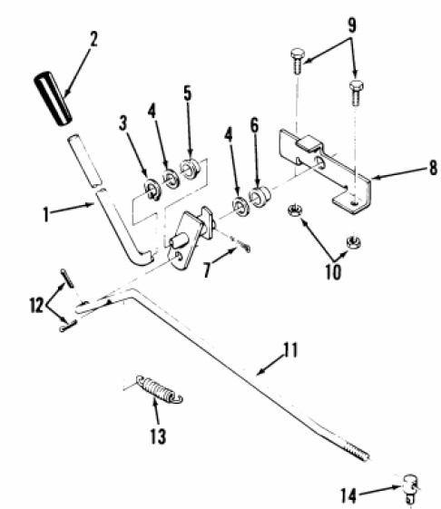

boovuc 1,090 #7 Posted October 20, 2018 Hi Bob, Mine isn't a two wire unfortunately. GARRY!!!!!!!!!! I think you hit it! The idiot that used it before my friend got it from him to save must have taken it a part like he does everything else to try to fix it and.....................he lost the parts. They are not in the bag of crap he gave his brother in law! I need #8, 9, 10, 18, 19, 51 to make it work as it should or I 'll have to bypass it and I don't really want to do that. This makes sense now based on your post and the fact this jerk takes things a part and doesn't know what he's doing. (Stories told to me and what I have seen with this tractor). I'm probably screwed. I did see #8 on flea-bay. The bolts/washers and nuts are not an issue. The spring steel part may be. Thanks, Garry! I really appreciate the effort! Share this post Link to post Share on other sites
gwest_ca-(File Mod) 12,450 #8 Posted October 20, 2018 I will bet a piece of that blue steel strapping for binding products to pallets would work for #18 if you can drill a hole in it. Will keep looking to see if there are older parts for your 1975 vintage as they may be different than these 1980-1982 parts but sounds like the concept is the same. #51 is likely just a piece of flat stock. The 1980-82 models used a wider hoodstand so that alone tells me the 1975 parts will be different. I have drilled stainless steel hose clamp straps so that may also replace #18. Garry Share this post Link to post Share on other sites

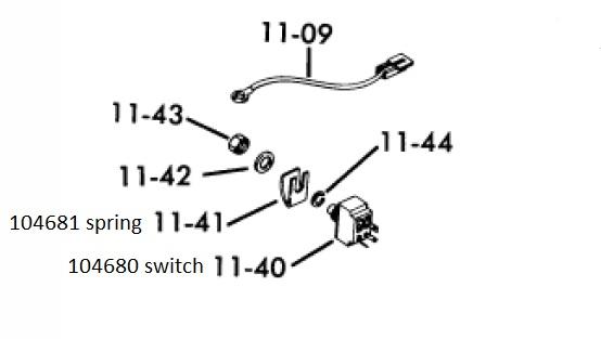

gwest_ca-(File Mod) 12,450 #11 Posted October 22, 2018 Appears 1975 and 1976 used the 104680 switch with a 104681 U-shaped spring to control the switch button outside the hoodstand. In 1977 they used a ball switch with just 2 wires. In 1978 they went with a wider hoodstand and used the same 104680 switch but with a 105873 flat spring inside the hoodstand. Garry 1 Share this post Link to post Share on other sites

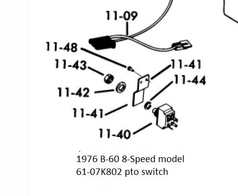

gwest_ca-(File Mod) 12,450 #13 Posted October 25, 2018 Found another variation of the flat spring over the switch button but a little puzzling. It is for the 1976 B-60 which should be recoil start and magneto ignition. Don't see the need for this switch but without an original parts list or wiring diagram hard to know what was happening. The ipl may be shared with the B-80 which would have battery ignition. No part number for the 11-41 spring tab listed. Does anyone have a copy of either? Garry Share this post Link to post Share on other sites
