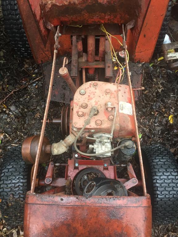

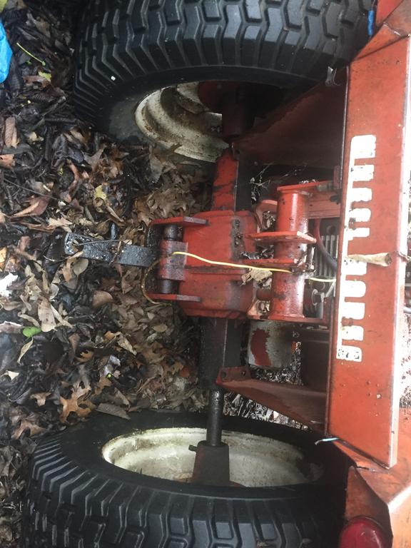

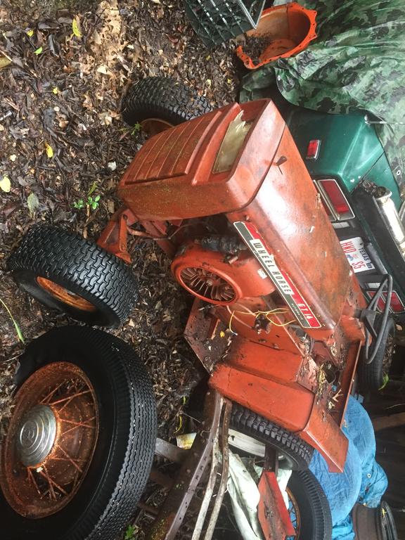

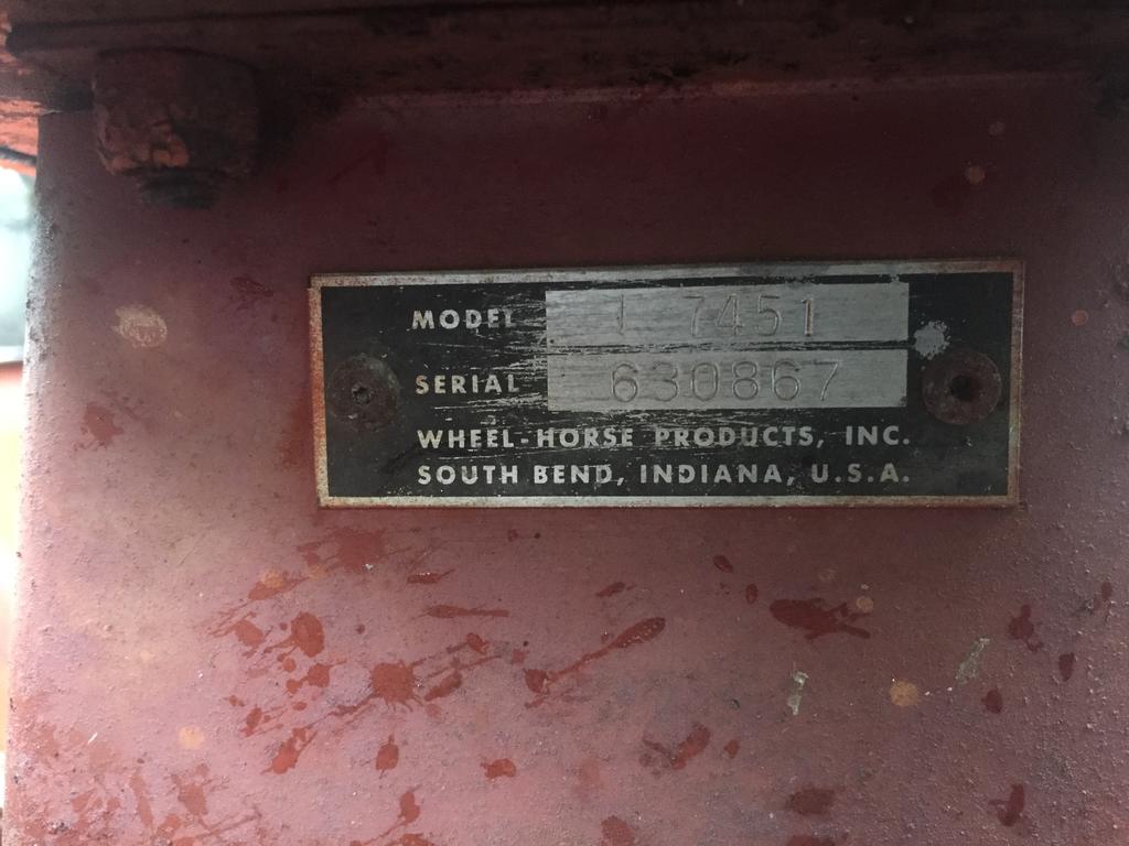

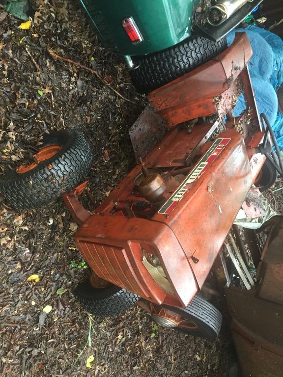

ZXT 2,401 #12 Posted October 17, 2018 (edited) Thanks, everyone! 953 nut, thanks for those files. I'm sure they'll be invaluable. I'm thinking that changing to a newer style deck from say a C series tractor might be my best bet. There still aren't any parts even for those around me, but they were made for a longer period of time so hopefully they aren't as scarce. Here are a few pictures of the ugly thing that I managed to grab today. It went from 83 degrees to high 30's and raining in a day, so it goes without saying that I'm not going to be doing any actual work on it for now. I'm missing the original deck mounting pieces and pulley drive parts. I also noticed that the passenger side rear axle is slid out of the case quite a bit.. I'm not sure how catastrophic that is, but it might be the reason the tractor was taken out of service. I'll have to do some research. It also appears to be a 1970 model. Since this is a tech thread as much as it is an introductory thread, do I need to keep posting in here when asking questions or can I start another thread in the other section? Thanks! Edited October 17, 2018 by ZXT 1 1 Share this post Link to post Share on other sites

ebinmaine 70,320 #16 Posted October 17, 2018 5 hours ago, Machineguy said: need to keep posting in here when asking questions or can I start another thread in the other section It would be best to start a thread in the section that Best defines the question. That way others can search for that info later, easier. Double check to see if the axle is moving from the transmission... Or hub is moving from the axle... Or both. Repairable either way. I tore into a wheelhorse transmission this year for the first time. Surprisingly easy and simple to work on. @stevasaurus has some great videos and him and others have an amazing amount of knowledge to pass on about everything to do with the Horse. 2 Share this post Link to post Share on other sites
ZXT 2,401 #17 Posted October 17, 2018 5 hours ago, ebinmaine said: It would be best to start a thread in the section that Best defines the question. That way others can search for that info later, easier. Double check to see if the axle is moving from the transmission... Or hub is moving from the axle... Or both. Repairable either way. I tore into a wheelhorse transmission this year for the first time. Surprisingly easy and simple to work on. @stevasaurus has some great videos and him and others have an amazing amount of knowledge to pass on about everything to do with the Horse. Thanks! I'll start another thread whenever I need more info. I'm fairly certain that the axle is moving away from the transmission because of how far it's out. I read through a thread where a guy with a C-160 had the same problem and a C clip had come off allowing the axle to slide off. The tractor was mostly disassembled when I got it, so I assume someone was trying to remove the hub with a hammer instead of a puller, and the C clip couldn't handle it. Doesn't look like it'll be too big of a deal to fix. If nothing else, it's a good time to replace all of the seals. Thanks for the info! 2 Share this post Link to post Share on other sites
ebinmaine 70,320 #18 Posted October 17, 2018 23 minutes ago, ZXT said: assume someone was trying to remove the hub with a hammer You're likely correct. 1 Share this post Link to post Share on other sites
19richie66 17,560 #20 Posted October 17, 2018 Welcome to the nuthouse! Best place on the web.👍 You’ll love the gt14 when you get it going! Looks like a project but they are beasts! Share this post Link to post Share on other sites

Sparky-(Admin) 21,863 #22 Posted November 4, 2018 I wonder if your GT 14 has a newer motor? That long dipstick tube has me wondering Share this post Link to post Share on other sites
ZXT 2,401 #23 Posted November 5, 2018 Wouldn't surprise me, considering it is has a C160 trans. It also doesn't appear to have ever had the old style wheelhorse coil and flywheel pickup either, which i assume my tractor would've had. Share this post Link to post Share on other sites
