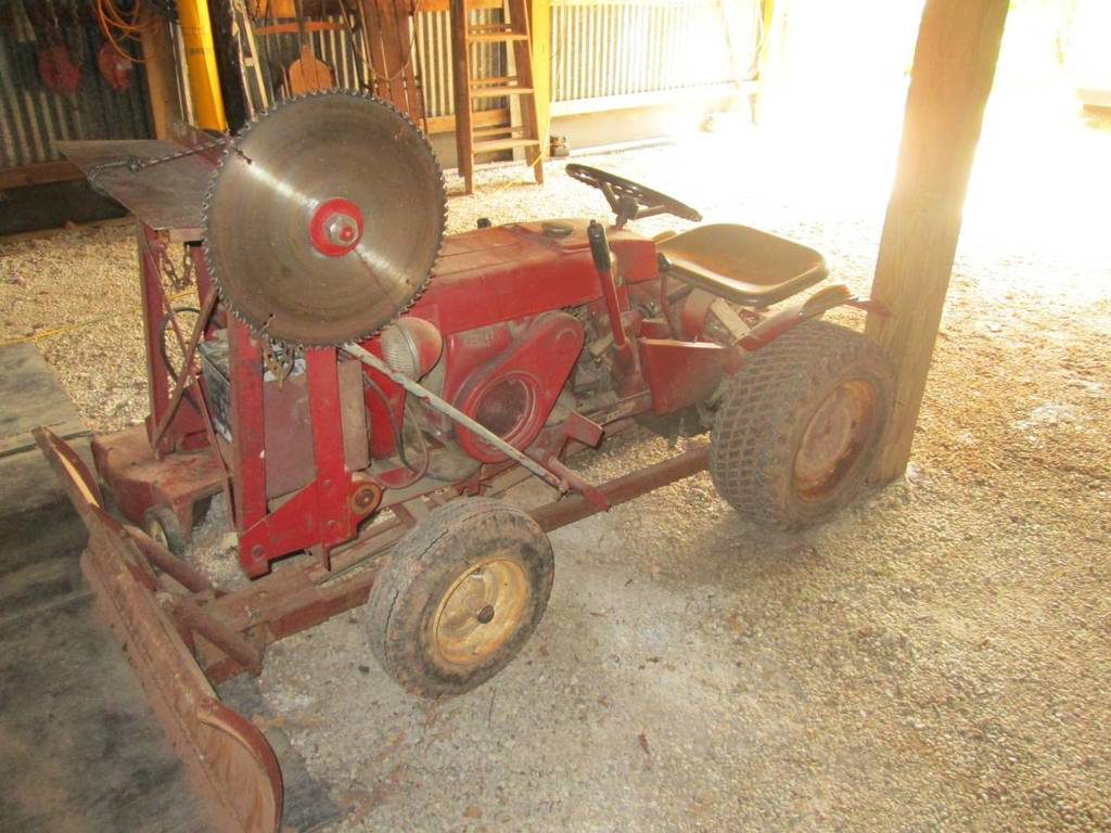

520hC-120 136 #2 Posted October 12, 2018 Right off wheel horse parts and more website. I don’t know anything about the saws but here’s a pic for ya to see. 1 Share this post Link to post Share on other sites
953 nut 57,861 #3 Posted October 12, 2018 15 minutes ago, 520hC-120 said: Right off wheel horse parts and more website. I don’t know anything about the saws but here’s a pic for ya to see. That is not a saw mill, it is a PTO to drive agricultural equipment. 1 Share this post Link to post Share on other sites

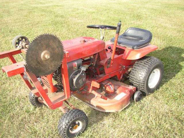

Tankman 3,520 #23 Posted October 20, 2018 Just saw a saw, local Craig’s List. $225. Share this post Link to post Share on other sites
The Tuul Crib 7,338 #24 Posted October 20, 2018 2 hours ago, Tankman said: Just saw a saw, local Craig’s List. $225. Doesn't look like you get much for 225 bucks! Maybe the blade is made out of titanium ! Share this post Link to post Share on other sites
elcamino/wheelhorse 9,360 #25 Posted October 21, 2018 That is a cut off saw for slab wood. My grand parents had one. They would get the small slabs that the saw mill had left over from squaring up logs. Belt ran from tractor. Cut the slabs to length 12 to 15 inches . That's is how the heated the house and the wood stove in the kitchen. The kitchen stove was used year round. 1 Share this post Link to post Share on other sites
