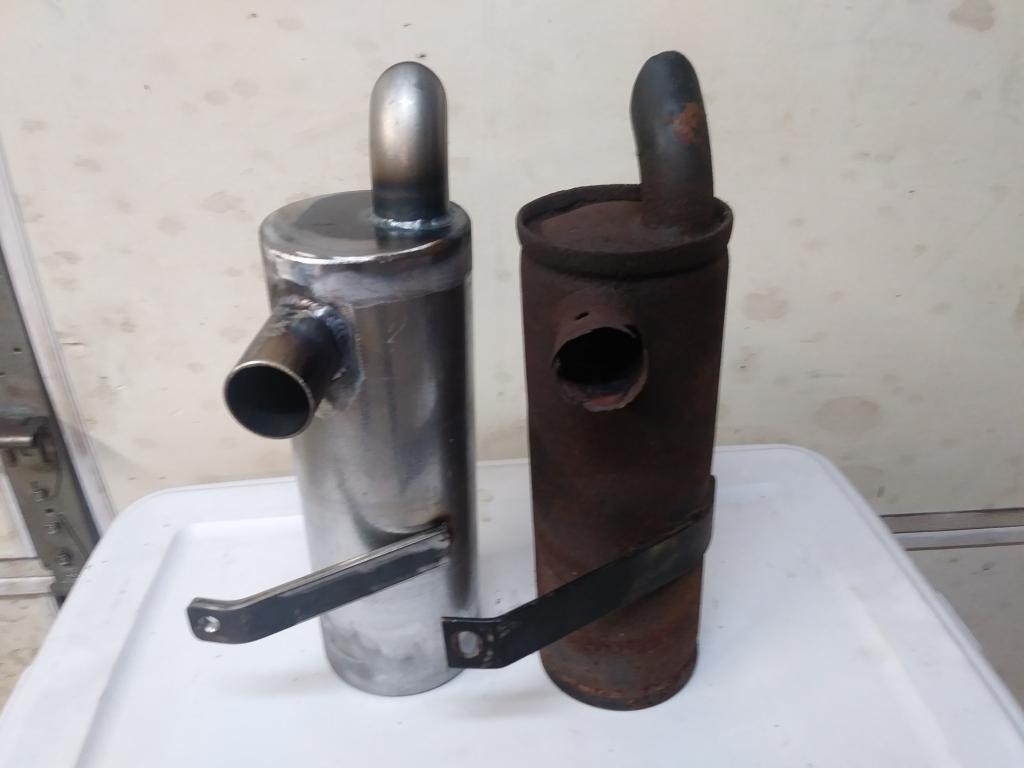

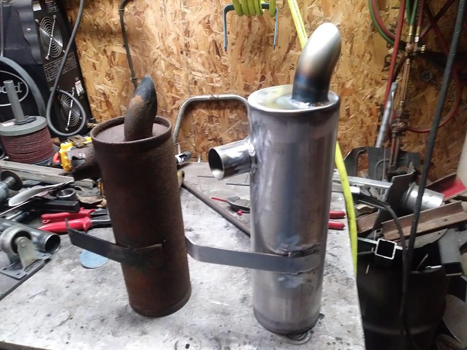

AHS 1,491 #52 Posted February 7, 2020 On 10/6/2018 at 8:44 PM, jimkemp said: I finished the next generation of wheel horse mufflers tonight , this is the prototype , now on to the testing stage and see how they sound I’m definitely interested! I’ve got a 414-8 (just like the one above!) that I just got and the muffler is beyond repair! What is your turnaround time? Do they need to be painted? @jimkemp Share this post Link to post Share on other sites
jimkemp 527 #53 Posted February 7, 2020 (edited) 20 hours ago, AHS said: I’m definitely interested! I’ve got a 414-8 (just like the one above!) that I just got and the muffler is beyond repair! What is your turnaround time? Do they need to be painted? @jimkemp I can have one built for you and ready to ship on Monday if you would like , no paint needed , they come with a high temp coating , @AHS Edited February 8, 2020 by jimkemp Share this post Link to post Share on other sites
rjg854 11,871 #54 Posted February 7, 2020 @jimkemp how did you make out with the next generation of the stack you were experimenting with? Share this post Link to post Share on other sites
jimkemp 527 #55 Posted February 8, 2020 2 hours ago, rjg854 said: @jimkemp how did you make out with the next generation of the stack you were experimenting with? Still working on a better way to put the fiberglass packing in them , my test muffler after time started to push the packing out , but I am always doing R&D on these mufflers trying to make them better 1 Share this post Link to post Share on other sites
AHS 1,491 #56 Posted February 8, 2020 On 2/7/2020 at 3:23 PM, jimkemp said: I can have one built for you and ready to ship on Monday if you would like , no paint needed , they come with a high temp coating , @AHS What do you charge for for a 414 muffler? @jimkemp Share this post Link to post Share on other sites
jimkemp 527 #57 Posted February 8, 2020 12 minutes ago, AHS said: What do you charge for for a 414 muffler? @jimkemp If the muffler looks like this one its $85 shipped to you , sorry I don't know what a 414 muffler looks like , @AHS 1 2 Share this post Link to post Share on other sites
AHS 1,491 #58 Posted February 9, 2020 10 hours ago, jimkemp said: If the muffler looks like this one its $85 shipped to you , sorry I don't know what a 414 muffler looks like , @AHS Exactly like that! Just let me get the muffler off and get some pictures to you. Share this post Link to post Share on other sites

jimkemp 527 #62 Posted February 23, 2020 2 hours ago, AHS said: Ok, the stanchion that bolts on from the end of the muffler 3 7/8 to the beginning and 5 1/8 to the end. I would like to order one from you. Let me know if this helps!😁 Looks like the same muffler I build , I will send you a message about payment 1 Share this post Link to post Share on other sites
