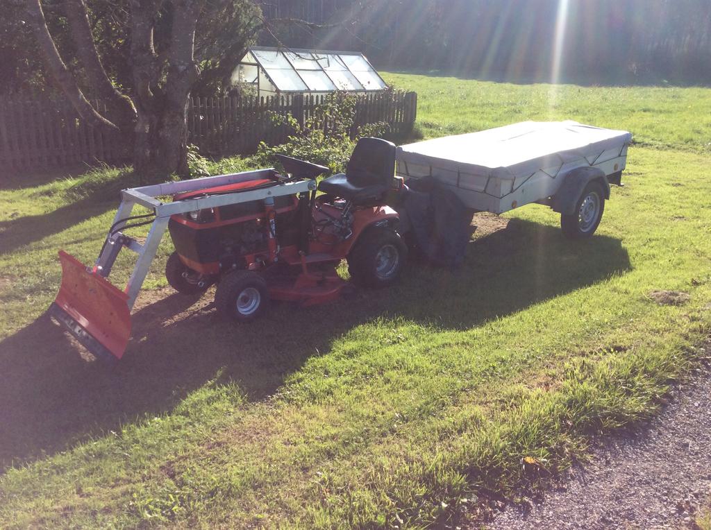

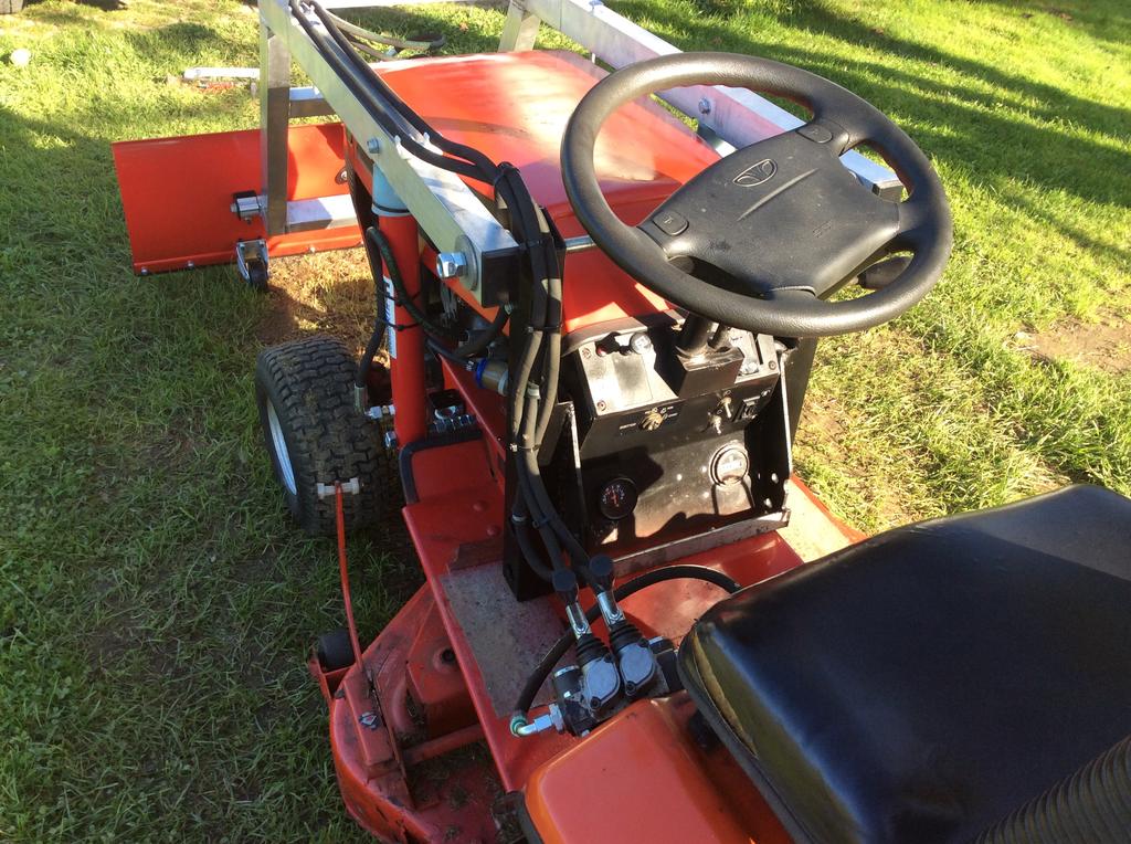

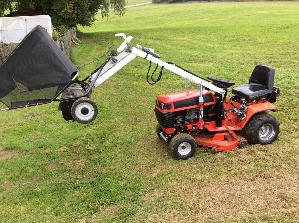

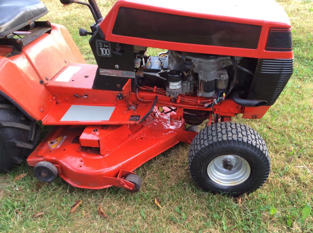

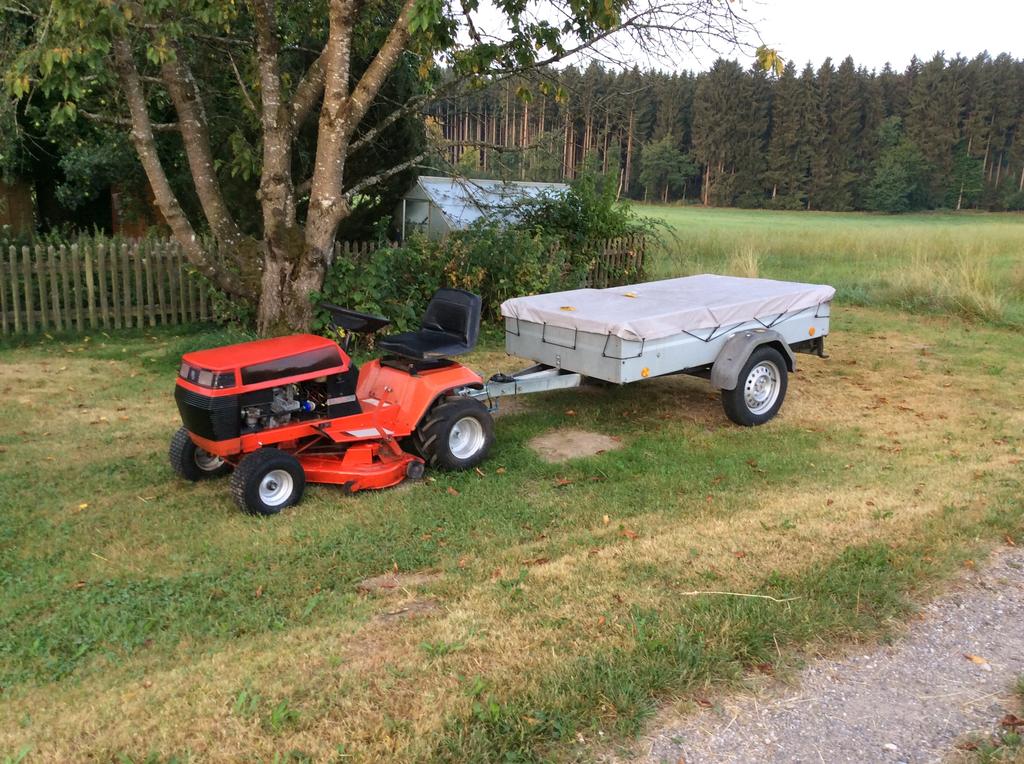

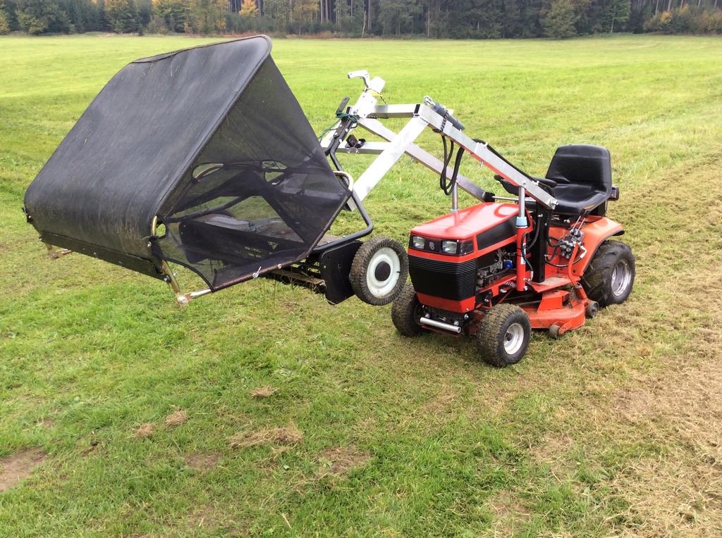

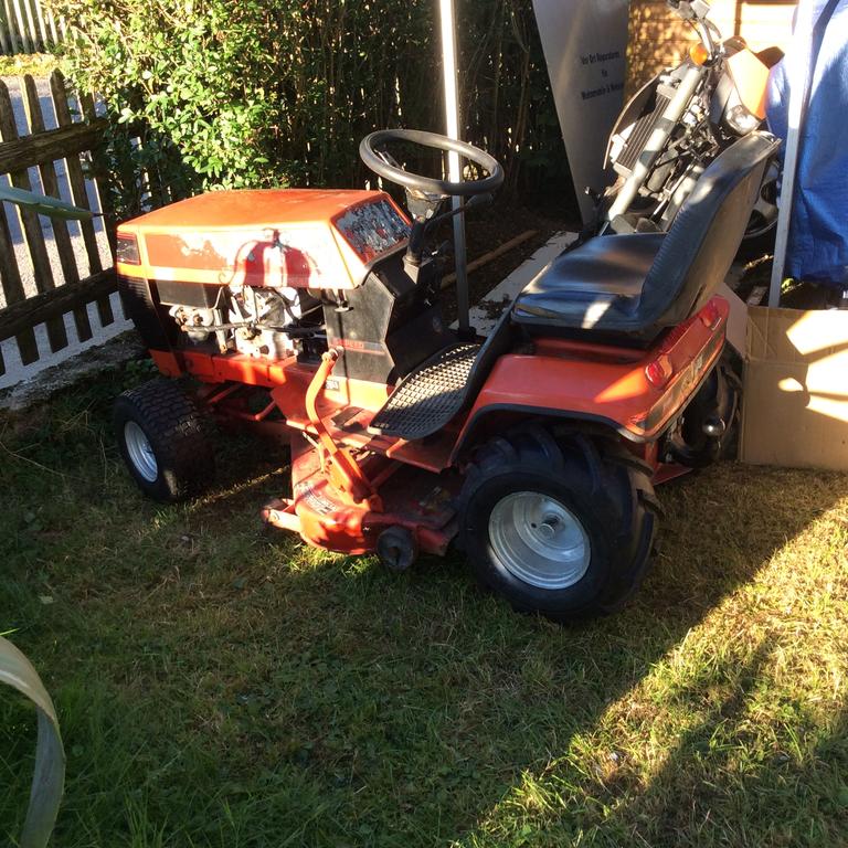

Tractorhead 9,087 #1 Posted October 2, 2018 (edited) Hi all, as i see, for most Wheel Horse owners, the 212-Series seems not be a real Wheel Horse, because of different technical issues. I got my little Tractor for free, after it was in a burning Garage. So the first impression was - oh my God - but i loved the Shape of that little Tractor, so i decided, to bring it back to work. i changed new tyres on, i rebuilt the electric, as far as it will be needed then i do the first mow. ok, the Blades was also not that sharp, so i changed them to brand new ones. i have the three blade deck, what was also very damaged in the last few years (it was a 1989 build) I refurbish the engine as far as needed, i cleaned and rework the steering axle, even the grease connectors, put new lights on, because some parts are melted, give a new steering wheel from a kia with Airbag - (deactivated) and so on... The last few months, it worked so far better than i expected, so i rebuilt it step by step. In case of the fire, the damages was not so dramatical, the most troubles was happen from the firefighters. shure they don't have to save it in good condition, they just have to stop the fire - thats it. i agree to that 100% - but everytime i looked this little tractor, i hear a voice inside me "please save me" Ok, i will do so. Actually, i use it as my personally multi tool. To do that, i added some features. first i gets an european Trailer Hook from an Iveco - yes 2Tons of capacity was a bit funny, but it fits perfect and i can use my car trailer - a light 700kg type, what fits perfectly and the optic looks pretty nice. The Power of the Onan e125V is strong enough, to climb also 17% upwards, more than enough for my needs. To be nearly perfect multi tool, i added a strong frame improovement and a hydraulik Frontloader. it have just lifted a maximum of 100 Kilos and just if it really needed, but the ability to lift is 700Kilos. i know, 100 kilo on frontloader was about 200 kilos on front axle. I do not want to kill it, it was just a ability to do in case. Nearly the whole Front loader was made of Aluminium. Except the mainholder and Frameimproovement, they are made of steel. Just have to deal with oil consumption, it seems, the intake valve seal seems to be defect. So the "little Pusher" blows blue Oilsmell while Start. Edited October 2, 2018 by Tractorhead 2 6 1 Share this post Link to post Share on other sites

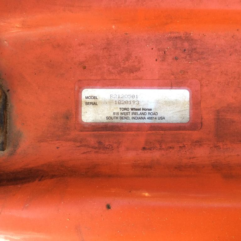

Tractorhead 9,087 #4 Posted October 2, 2018 Hello Paul, thanks for the flower. One Question i have, i am searching for all Original documents, because everything what was available before, Is all burned down in and within the Garage or is destroyed later by firefighting. Few documents i have again allready, i found here in that forum, thanks for that so far ! The reason of my need, i must mow and snow plow around our House, collecting leaves with my sweeper and some issues more what i use "the little Pusher" for, make it for me neccessary to drive on the road. To avoid trouble with our local country Sheriffs, i like to make it official Street Legal. It was not completley impossible, but as much original technical Data i can serve, that easier it will be, what are hopefully available for this little Tractor. Data i missing: maximum Load on the Axels (once front once rear) Empty weight of whole tractor and absolute maximum weight or (absolute max. Load ) axle independent. thanks for support if available ahead. regards Stefan 1 Share this post Link to post Share on other sites

Pullstart 64,380 #6 Posted October 2, 2018 to @Tractorhead Stefan! I’ve been to Bavaria, heading to München again next year, about this time! Nice loader, that looks like it’s built quite nice. Did you do the aluminum welding? Here is my “German kid” Jil after driving my 502 in the field this past August. She’s from Duisburg, she was our exchange student 5 years ago, now she’s in college. 3 1 1 Share this post Link to post Share on other sites

gwest_ca-(File Mod) 11,210 #8 Posted October 2, 2018 Is your model one of these? A2-12KE01 (212-H) - Toro 212-H Tractor (1989) A2-12KE02 (212-H) - Toro 212-H Tractor (SN: 1000001 - 1999999) (1991) E2-12KE01 (212-H) - Toro 212-H Tractor (1989) R2-12KE01 (212-H) - Toro 212-H Tractor (1989) I see an Onan filter so may be the following R2-12OE01 (212-H) - Toro 212-H Tractor (SN: 1000001 - 1999999) (1991) R2-12OE02 (212-H) - Toro 212-H Tractor (SN: 2000001 - 2999999) (1992) Garry 2 Share this post Link to post Share on other sites

Tractorhead 9,087 #14 Posted October 3, 2018 10 hours ago, gwest_ca said: Is your model one of these? A2-12KE01 (212-H) - Toro 212-H Tractor (1989) A2-12KE02 (212-H) - Toro 212-H Tractor (SN: 1000001 - 1999999) (1991) E2-12KE01 (212-H) - Toro 212-H Tractor (1989) R2-12KE01 (212-H) - Toro 212-H Tractor (1989) I see an Onan filter so may be the following R2-12OE01 (212-H) - Toro 212-H Tractor (SN: 1000001 - 1999999) (1991) R2-12OE02 (212-H) - Toro 212-H Tractor (SN: 2000001 - 2999999) (1992) Garry Thank you a lot Garry, youre my best Buddy in case of Information, all the months ago i searching about the 200 series, your Information shall be the best ! Thumbs up for your Work, thanks therefor ! One issue i have - i wonder about Serialnumber in combination with Timeline. The Tractor i have, was a purchase in 1989 that is shure, but about the Serialnumber verification (now) tellsme, it shall be an 1991 built, All info's i got before with the Tractor, it was definitiv a purchase in 1989 - wondering a bit about. For me, that Info is realy important, while make it street legal. I have no more evidence, because all old documents with marked purchasedate was gone or be just in parts readable. - so i trash it - not my best idea.... Damn, i know... Regards Stefan 1 Share this post Link to post Share on other sites
gwest_ca-(File Mod) 11,210 #15 Posted October 3, 2018 A purchase in 1989 could be a 1989 model or an early 1990 model as the 1990 models would have been released in late 1989. Does the engine still have a decal with the engine model number and serial number on it? The tractor model numbers identify the engine brand used K is Kawasaki O is Onan or Toro Power Plus/Onan B is Briggs & Stratton I am not familiar with these engines so it is possible an Onan filter would fit any of them. The E is for Eaton hydro transmission. The A, E and R usually identify export US produced models and the differences are safety equipment and decals for a specific region. Have seen a 1989 US model number show up in Australia so could have also gone to Europe. These are all the 212-H models we know about. Clicking on a line should take you to the illustrated parts lists. Maroon hood stripe 32-12BE01 (212-H) - Toro 212-H Tractor (1989) A2-12KE01 (212-H) - Toro 212-H Tractor (1989) - Export model E2-12KE01 (212-H) - Toro 212-H Tractor (1989) - Export model R2-12KE01 (212-H) - Toro 212-H Tractor (1989) - Export model First year for black hood stripe. 32-12OE01 (212-H) - Toro 212-H Tractor (1990) - Perhaps this is the one you have. Onan engine and available in late 1989. Black hood stripe 32-12BEA2 (212-H) - Toro 212-H Tractor (SN: 1000001 - 1999999) (1991) 32-12BEA3 (212-H) - Toro 212-H Tractor (SN: 1000001 - 1999999) (1991) 32-120EA1 (212-H) - Toro 212-H Tractor (SN: 1000001 - 1999999) (1991) - Toro mistake. Should be 32-12OEA1 (Used 0 for O) 32-12OE02 (212-H) - Toro 212-H Tractor (SN: 1000001 - 1999999) (1991) A2-12KE02 (212-H) - Toro 212-H Tractor (SN: 1000001 - 1999999) (1991) - Export model R2-12OE01 (212-H) - Toro 212-H Tractor (SN: 1000001 - 1999999) (1991) - Export model 32-12OE03 (212-H) - Toro 212-H Tractor (SN: 2000001 - 2999999) (1992) R2-12OE02 (212-H) - Toro 212-H Tractor (SN: 2000001 - 2999999) (1992) - Export model Garry Share this post Link to post Share on other sites
gwest_ca-(File Mod) 11,210 #16 Posted October 3, 2018 The black strip around the top of the hood and headlamps indicate it is a 1990 model if the colour is original. In 1989 that stripe was maroon. Garry Share this post Link to post Share on other sites

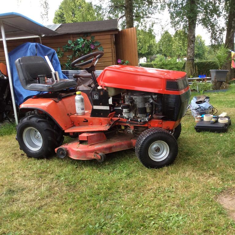

Tractorhead 9,087 #17 Posted October 3, 2018 Thanks Garry so far for your Info. On the Tractor i found a small Service (decal) sign inside the right side of the Engine Hood from the Dealer, it was with a delivery date stamp from 10/89, with 2 followed service marks for /90 and /91 what shall be delivery in October of 1989.. And each year Service in 90 and 91. So in that case, it make sense that it maybe an 1990- er Modell or facelift. The decal was a bit flaky from the fire, so i try to clean it by a light fingerwipe, but it flakes down immediately... damn -no pic from it before... However ! It is an Original 212-5 , Five speed manual Gear with an Onan E125V Engine. The original hour meter shows 2642 h and it is still continouse working.... When engine is starting, i wonder about, but it does. A lot of hours for that little Tractor, he lasted until now.... The light Oil-mist while Starting, seems to come from intake valve Seal. the rest of the Engine except carb stay's in good condition, so far as it can after the Fire. because of beginning strong Rust after a longer delay in fire extinguishing powder, i have to clean up several Parts ,especially the hood. while grinding down, i must remove the rest of non readable Service Sign.. The Files you provide was a huge help for me, (thanks again therefore) to find out more about my Tractor. Just about the Serial number, it shall be 2 Years newer than the Service Sign tells me, that is the only issue i wonder about. service Sign tells 10/89 Serialnumber tells 1991/92... curious. Anyhow, it is still working and will be grown up. Next step after Winter, will be a rework on the Engine, to stop the Oil- mist. Share this post Link to post Share on other sites

Tractorhead 9,087 #20 Posted October 3, 2018 Hey Garry, thanks a lot for your guidance and clearify about the Date of my Tractor. Independent what was signed on the Tractor before, it must be an 1991er build or Modell. how and why it was handled as an 89 - modell - who know's... So every issue points to it, that it is definitiv an 91- Modell. In my case, try to get it road- legal, all is fine - as far if i have any evidence, that it will be made before 1993. Share this post Link to post Share on other sites

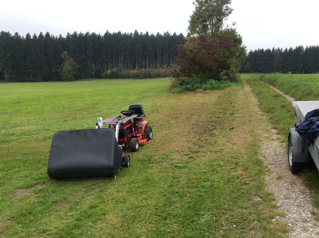

Tractorhead 9,087 #21 Posted October 9, 2018 I love to work with it! Even out in Backyard, everything is very usable... Had a small fail today, but with the Homemade Frontloader everything could be fixed quick without Backpain.... Real fun to work with.. - Never will miss it. Wheelhorse Rules 2 Share this post Link to post Share on other sites
