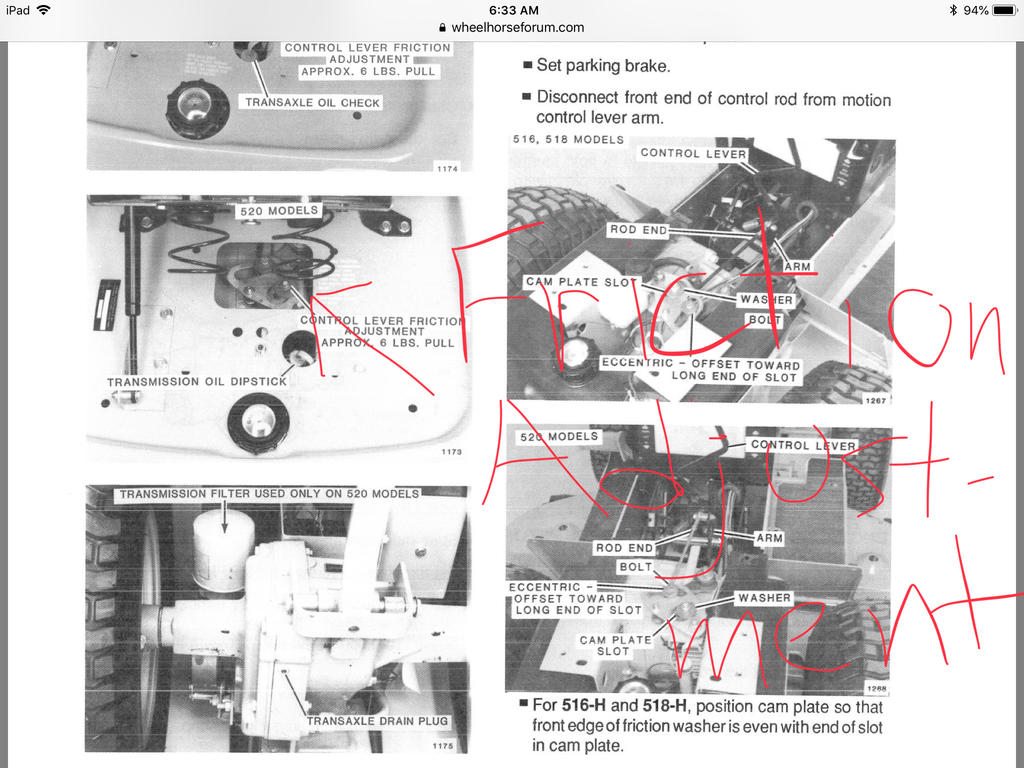

I have a 312h  the speed lever has to be held because unless it is the tractor quickly stops. Is there so adjustment I can make so I don’t have to hold it
520hC-120
Same thing happened with my 520h. Your setup may look similar to the manual Cleat posted. Just tighten the lower bolt to your liking, but not too tight. It will make the lever stay eventually.
This thread has a bunch of good information on the "Friction Collar" adjustment.
