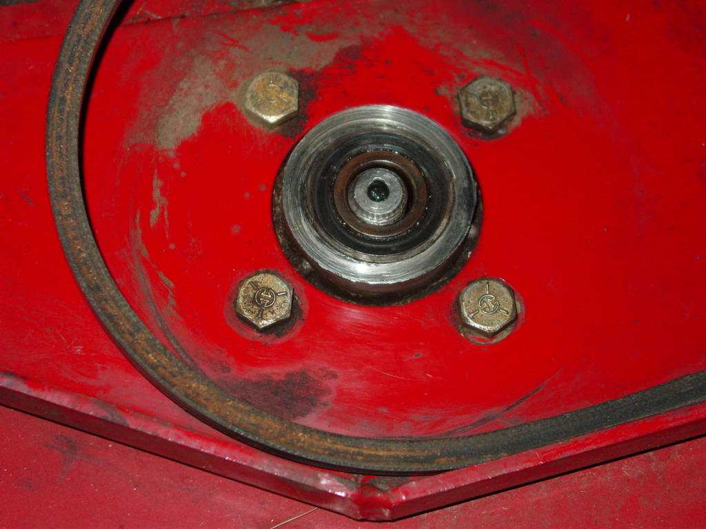

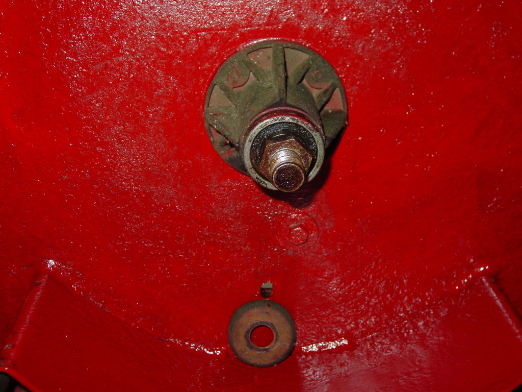

I was getting ready to install gator blades on my TORO 48" mower deck and noticed that one spindle cup was not where it should be when I removed the old blade.
DSC01535.JPG.277def74682e2cc911b451b94574ec4f.JPGDSC01534.JPG.4bfcbf85f0ceb248e9b2c5be240c9725.JPGThe mower deck is a TORO Model #78363 and Serial #8900333
How can I safely install the cup back on to the spindle?
You would need to remove the spindle, add the cup to the spindle and reassemble.
Make sure the other parts are all there and in the correct order.

Hi guys,
I was getting ready to install gator blades on my TORO 48" mower deck and noticed that one spindle cup was not where it should be when I removed the old blade.  How do I get the cup back on the spindle?

Attached is picture of a spindle with cup properly attached.

I haven't been able to budge the pulley on top, or the nut on the bottom.  Should one or both unscrew?

You already have the nut off the bottom.
The hex you see is part of the shaft.
Pulley should just slide off now but is being held on by rust.
You may need to heat the center of the pulley to break the rust bond.

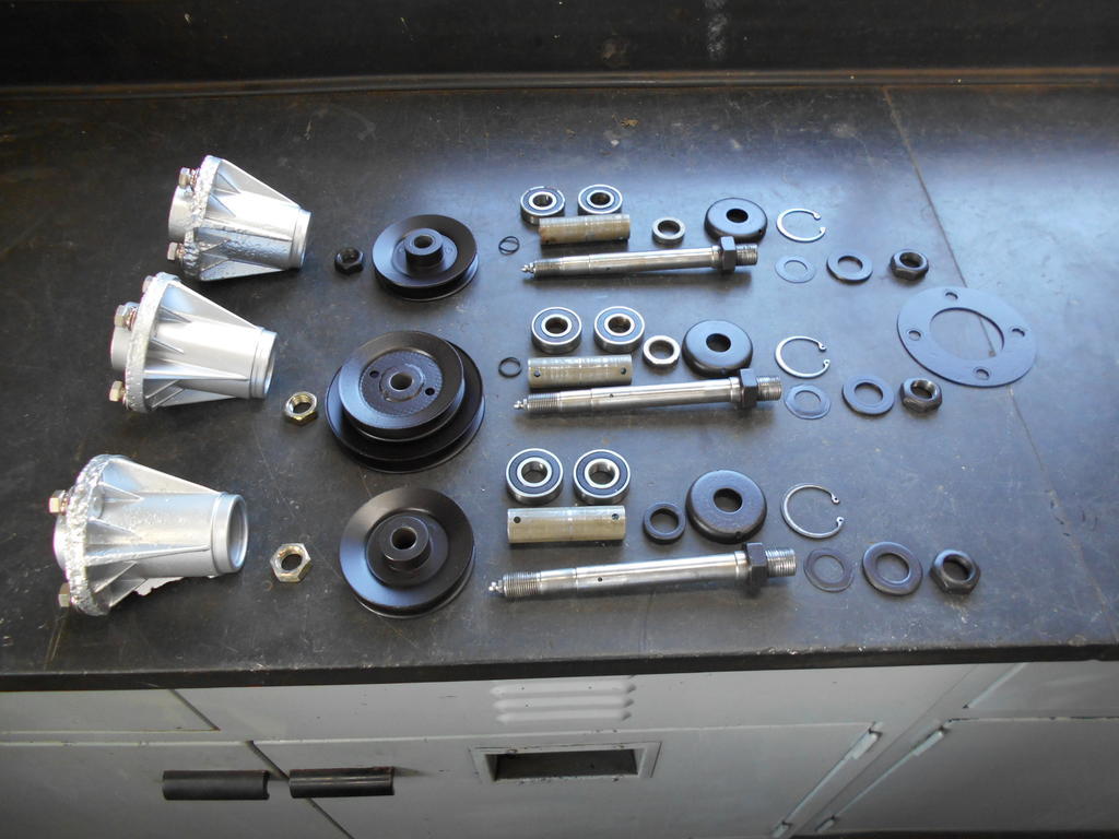

Here is a picture showing all the parts in roughly the right order.
5b91504477e28_Spindlesandpulleyscleanedupreadyforassembly.JPG.6a349bf2930190171956c061f8086c74.JPG.247662a66dbad99ce721648ac3b1f797.JPG

Make sure you have the spacer (#27 in the parts diagram) between the cup and the bearing.
There might be a small 'O' ring under the pulley on the shaft that you will need to slide up and off for the shaft to easily slide out.
I think this ring is just used to keep the spindle together during assembly at the factory so no big deal if it breaks.
Make sure to use never seize or at least grease on the shaft and it will come apart better next time.

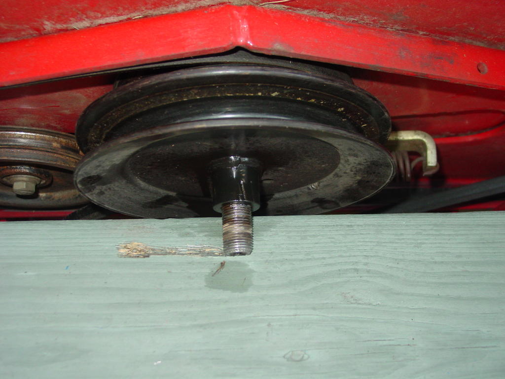

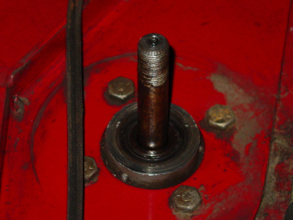

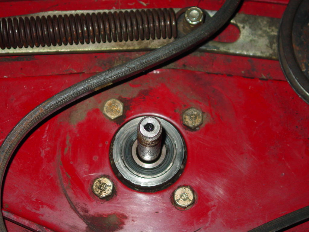

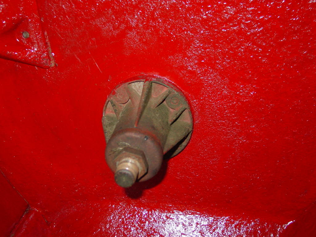

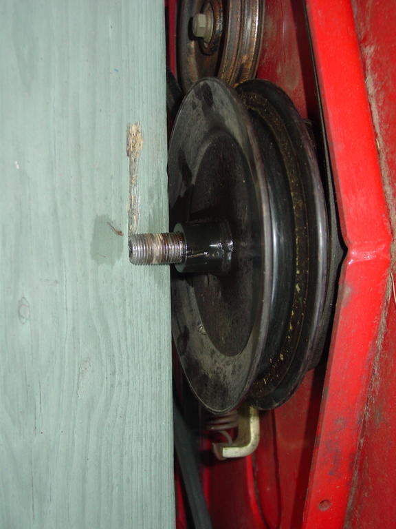

I removed the pulley and  tapped the spindle down with a hammer and block of wood.  I can move it up and down by hand, but it will only go as far down as what you can see in the photo.  It acts like it is catching on something but I don't know what it could be.  Any suggestions?
If it went that far it should go the rest of the way.
Has it gone far enough you can reach in with a set of bent-nose snap ring pliers and remove the internal snap ring? That way the lower bearing could come out with the shaft. Don't see how that would help because the shaft should already be through the lower bearing a ways meaning the bearing can't be seized to the shaft.

Looks to me that you or the previous owner has hammered directly onto the end of the spindle shaft, possibly mushroomed.
Edited by bcgold
lynnmor
Might be mushroomed, but it looks off center to me.  Tap it back a bit and spin it to see if it is bent.
eibbed
Now that you mention it, I think it may be bent a little.  Could that be keeping it from dropping out the bottom?
eibbed
I tapped the spindle up again and spun it around.  I don't think it is bent.  The tip looks out of round and that is what was deceiving me.  When I tap the spindle up,  it  catches, requiring  me to tap it for it to go back down.  When it is down, I have to tap it  a little for it to go up.

Clean and sand the shaft that you have sticking up. It must have a mushroom top or a burr on it.
You can tap it through with a punch if necessary.
Also, you can now unbolt it from the deck and get it up on a work bench where it is easier to work on it.
