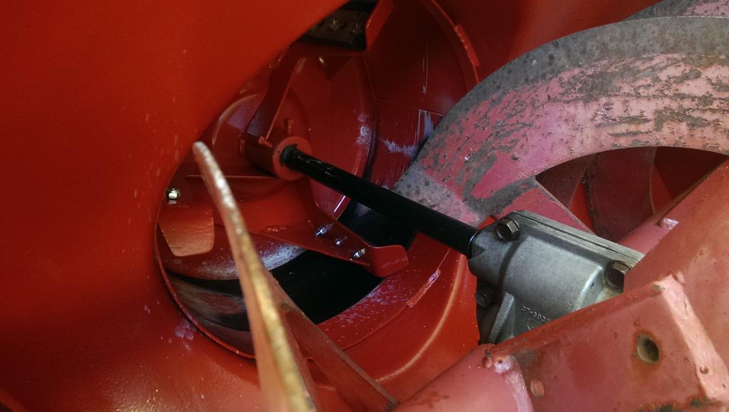

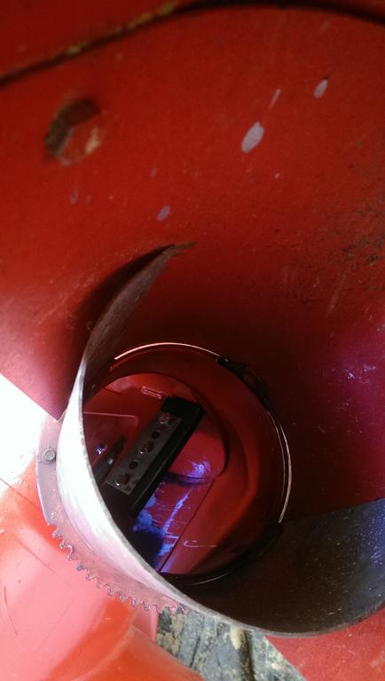

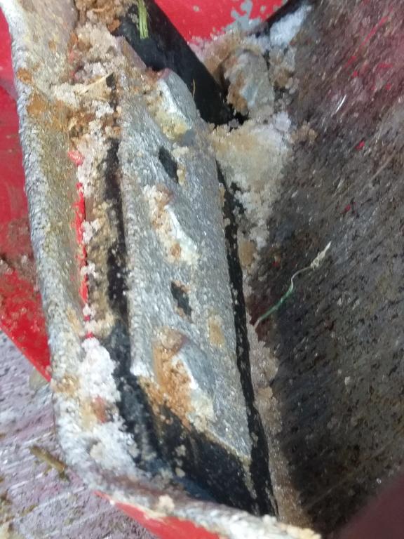

Also when I had my tall chute single on my 520 it did just fine in 18+" snow falls the 2 stage now just handles wet heavy or DOT packed plow banks better plus I installed one of those "0" clearance rubber impeller paddle kits eliminates 99% of chute clog/freeze ups...

now on your question I would from my experiences use only a single stage on a gravel driveway as I tried last spring to help out my BIL on his gravel driveway and ruined my impeller kit, as far as grass concrete or asphalt the 2 stage hands down...
