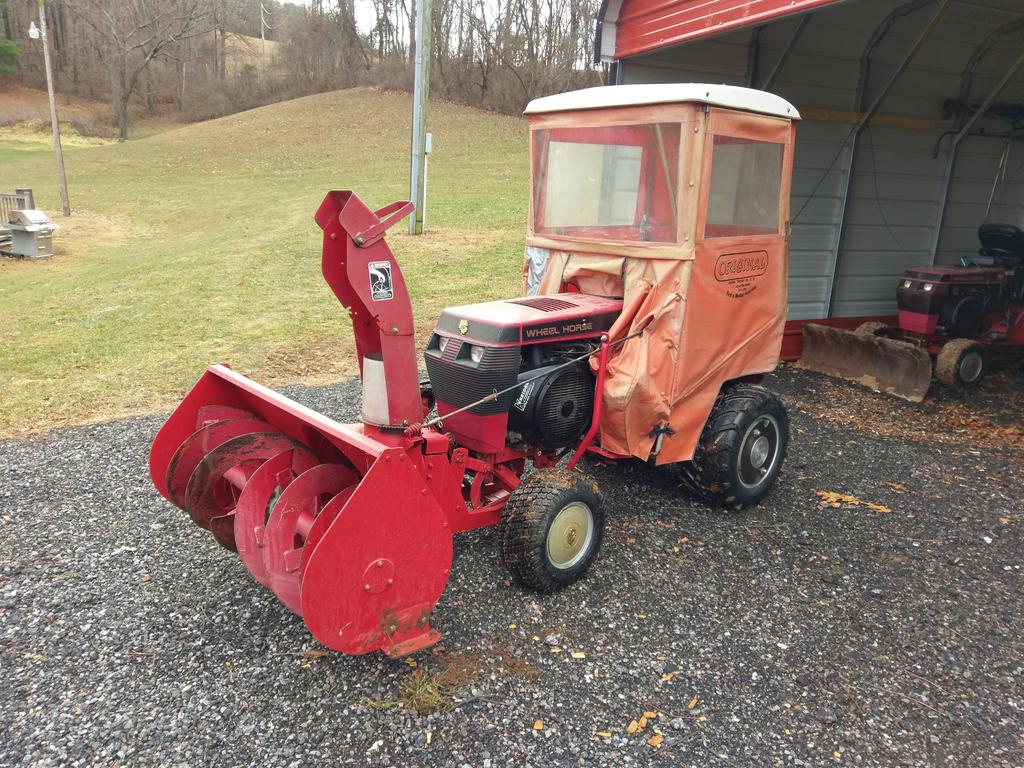

wallfish
418-C and 2 stage blower is exactly what I've been running for a few years . It'll have no problem throwing snow.
