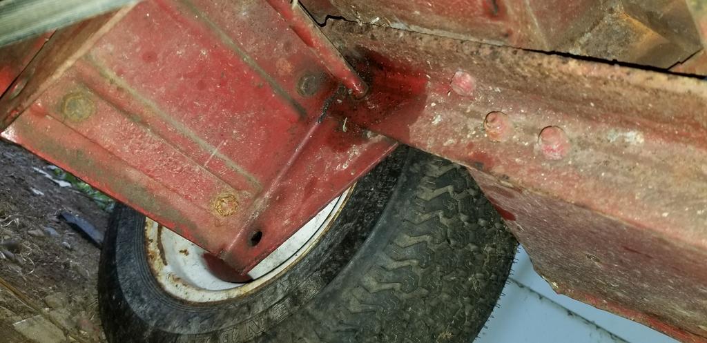

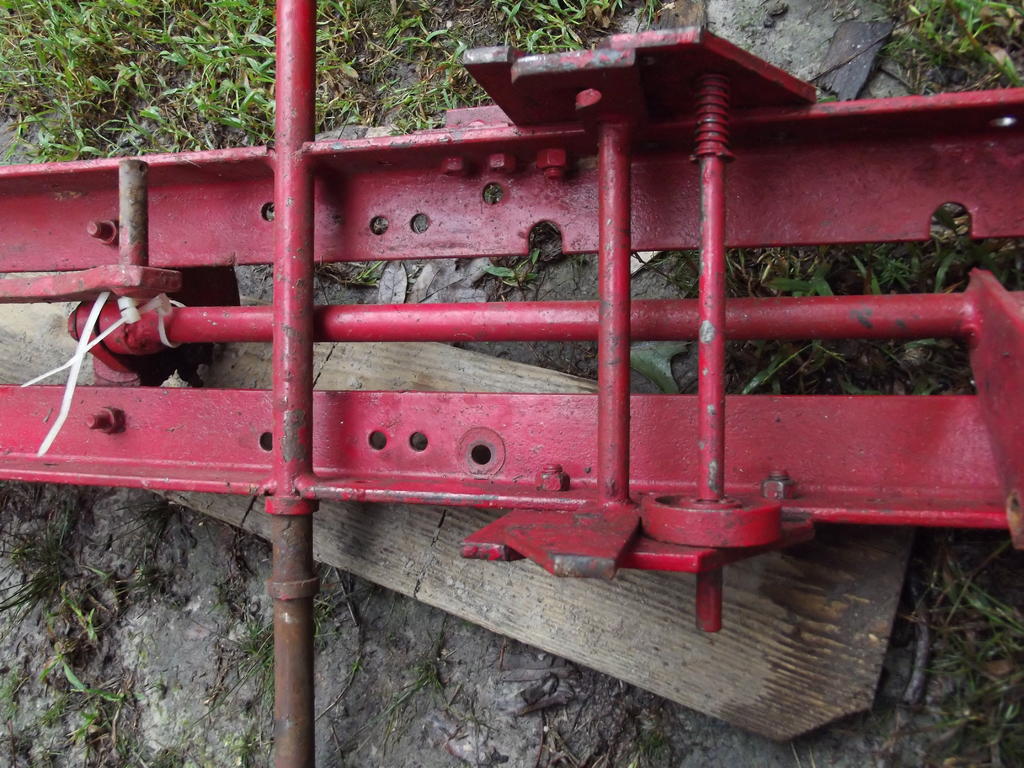

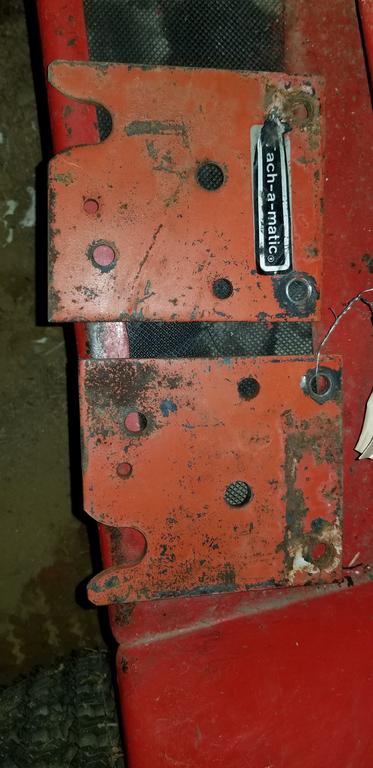

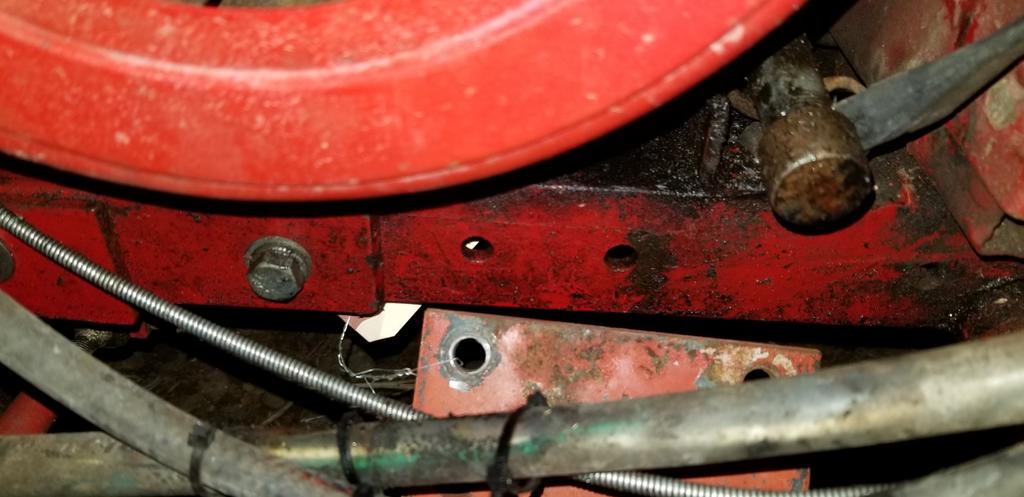

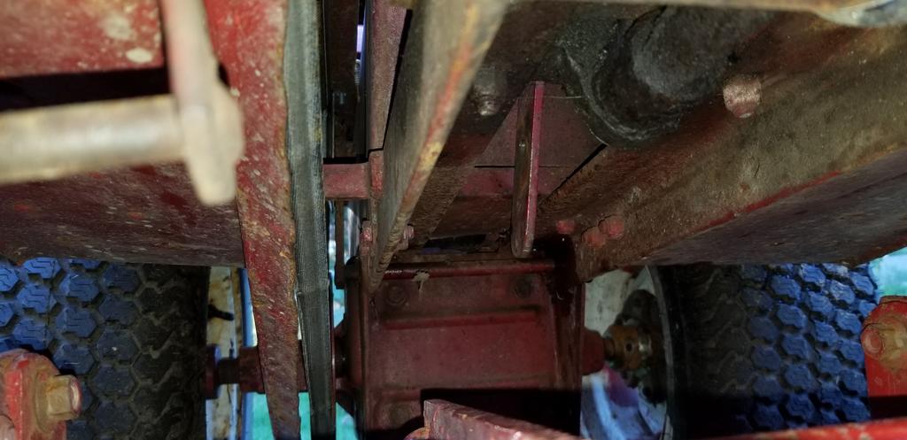

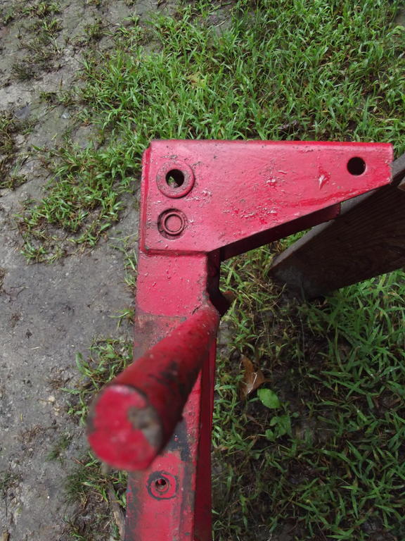

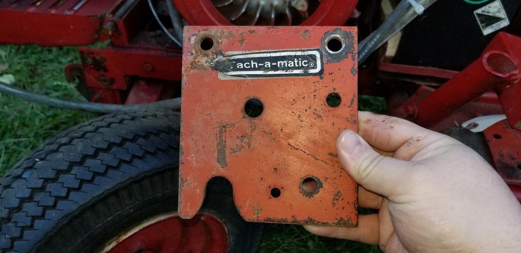

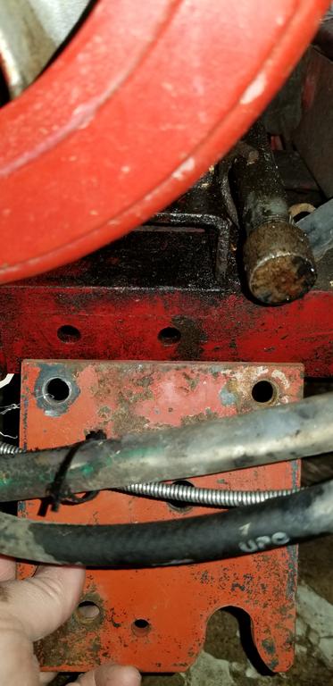

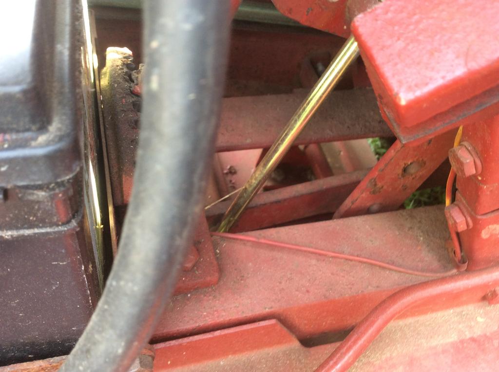

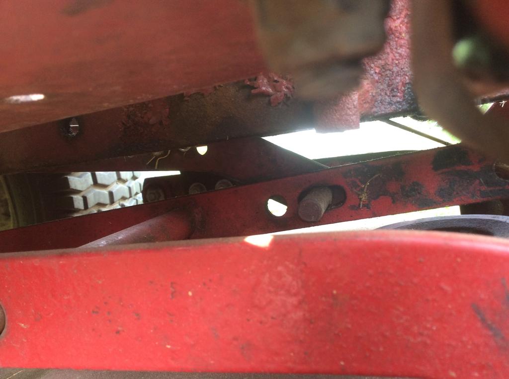

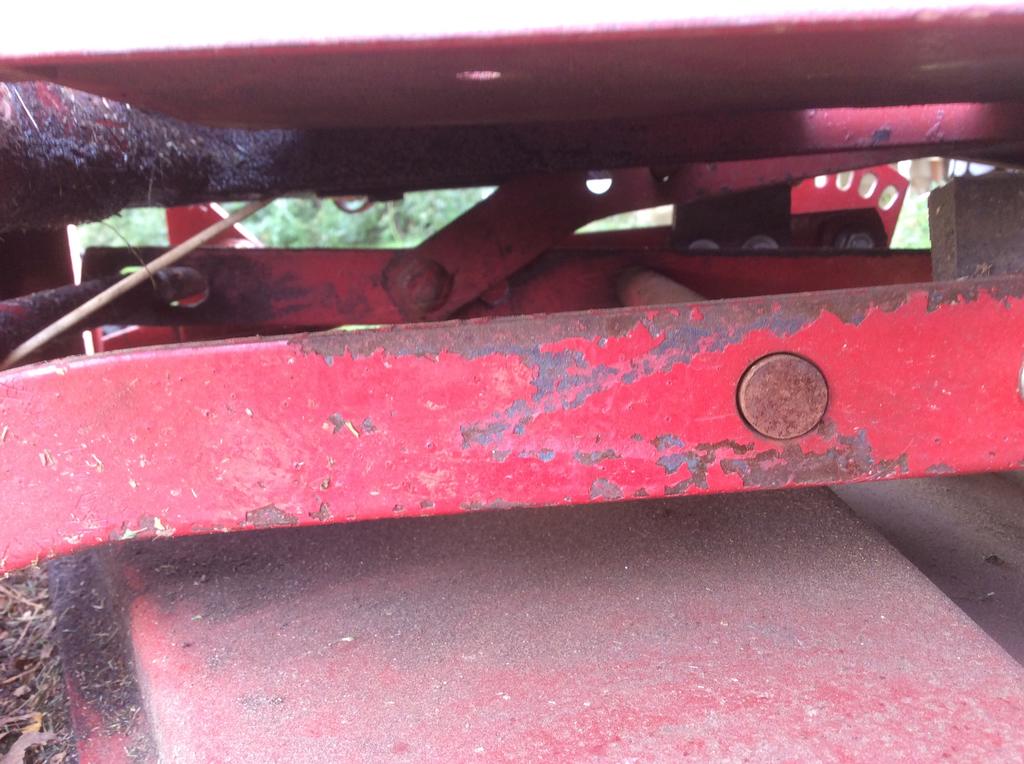

SimonC 35 #1 Posted September 23, 2018 Hi, I ordered and received the mid mount plate and other parts for my raider 10. I'm having two issues. First, in which holes does the plate need to be attached to on the frame, seems like the only ones that aligns properly are already used by the front part. See pictures. Second problem is the deck, I'm guessing that an arm is missing or something because I don't see how I'm supported to attach the lift arm to the deck. Also attached pics. Out of all the manual out there. None actually seems to show either the exploded parts for the mounting system or even a user manual how to use it that I could extrapolate from. Thanks Simon Share this post Link to post Share on other sites
JAinVA 4,619 #2 Posted September 23, 2018 (edited) First of all you seem to have some things bolted to the frame where the tachmactic bracket you show goes.If you don't need these things then unbolt them.You should see that the bolt holes line up.There should be an arm made of 3/8" metal that attaches to the frame just ahead of the transmission that the deck would lift by when attached to the lift mechanism by chain. Edited September 23, 2018 by JAinVA Share this post Link to post Share on other sites
SimonC 35 #3 Posted September 23, 2018 The exterior metal plate is there to attach another frame that goes above the front attach and was used for a winch to raise the blower. I can take that off easily. The other bracket on the inside is what the front attach o Matic is bolted to. Which is confusing to me. Someone has a picture of the side frame mounting hole that show the front and mid mounting point properly ? Share this post Link to post Share on other sites
SimonC 35 #4 Posted September 23, 2018 7 minutes ago, JAinVA said: There should be an arm made of 3/8" metal that attaches to the frame just ahead of the transmission that the deck would lift by when attached to the lift mechanism by chain. Any picture of that arm ? My snow blower was attached using a long lift bar connected to one of the two bracket that are part of the lift arm crossmember. Not sure I'm using the right terminology here but I hope it's clear enough Share this post Link to post Share on other sites
JAinVA 4,619 #5 Posted September 23, 2018 (edited) The tachmatic plate you have in your right hand bolts to the frame.Other than the bolts there in nothing else that holds the plate to the frame.Plate and frame contact each other period. Edited September 23, 2018 by JAinVA Share this post Link to post Share on other sites
JAinVA 4,619 #6 Posted September 23, 2018 You are .The snow blower lift system is lift arm with the holes,lift flag,lift tube and blower.The mower lift is lift arm chained to frame arm which has a rear pivot,pin through mower assembly. I don't have any pictures of what is missing on your machine and since it is 3 hours after dark it will be late tomorrow before I can provide photos of what you are missing. Share this post Link to post Share on other sites

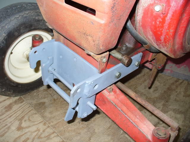

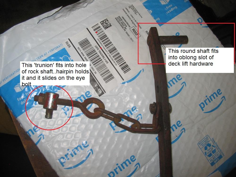

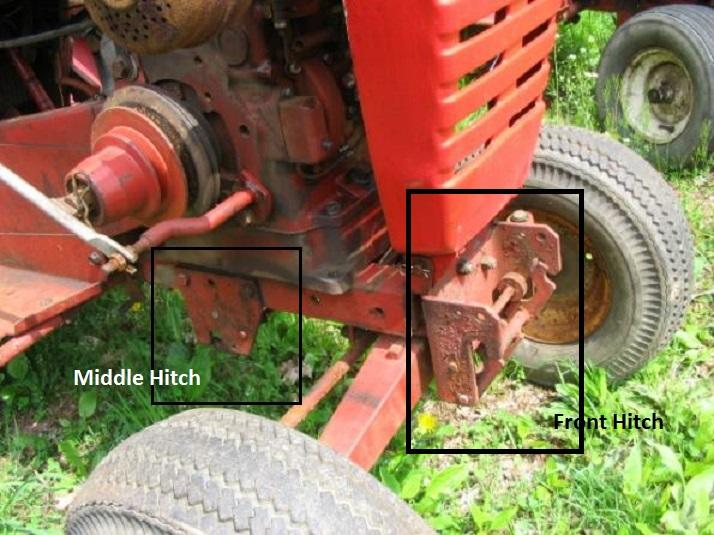

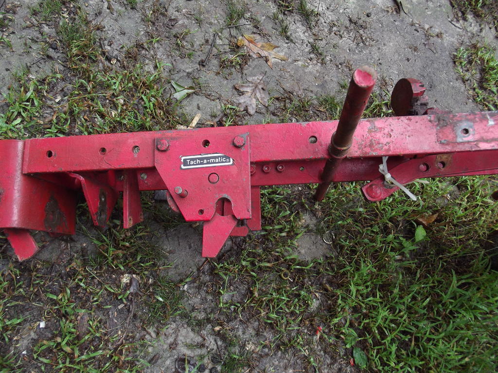

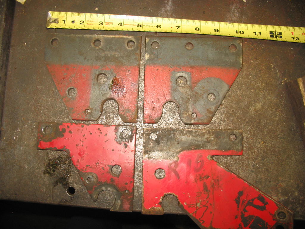

daveoman1966 3,745 #10 Posted September 23, 2018 This is the RIGHT side of the middle tach-o-matic side plate s/b located here: Your Front hitch bracket looks correctly mounted. Usually the mower decks hang from a 'T' bar that comes on B and C series..not stock on Raiders, but you can use a lift chain instead and hang that chain from the rock shaft in your 1st pic above. 2 Share this post Link to post Share on other sites
JAinVA 4,619 #11 Posted September 23, 2018 The gray bracket Daveoman shows only has 2 bolts to attach it and does not go back as far as the tachmatic bracket mounts.You still have something that needs to be removed to mount the tachmatic mounts.There is also more to mount the deck than just the two plates.There is a latch system and a spring loaded bar to lock everything in place. Share this post Link to post Share on other sites

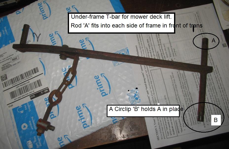

SimonC 35 #13 Posted September 23, 2018 Just re read, your saying that the whole T-bar doesn't come with raider. Will the T-bar work correctly on raider and does it have any advantages over just the chain hooked to the rock shaft ? Share this post Link to post Share on other sites

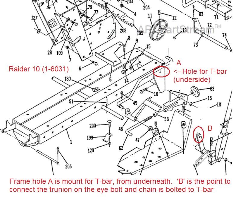

daveoman1966 3,745 #14 Posted September 23, 2018 Not having a Raider frame to go by, I cannot say whether the T bar would work for you or not...I'm just not sure, but look at your frame underneath, near where it is bolted to the transmission. If the T-bar will suit your tractor, you should see a thru-hole on the left side (point 'A' in pic), and a closed hole on the right exactly opposite of 'A' Here is a schematic of the 1971 Raider 10 model 1-0631. It does not answer the question though .http://www.psep1.biz/arinet.asp?aribrand=TO#/Toro_Consumer/1-6051%2c_Raider_10_Tractor%2c_1970/TRACTOR_PARTS_LIST_FOR_RAIDER_12_(1-6251)(1-6252)_%26_RAIDER_10_(1-6051)/1-6051-608-1970/A-5203-A|~520303-0001 Share this post Link to post Share on other sites

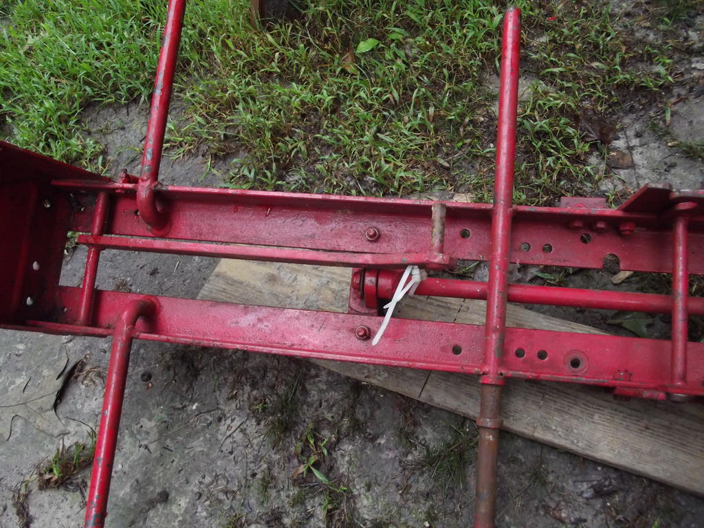

520hC-120 136 #18 Posted September 23, 2018 Here picture of how the rod for lifting and the t bar come into place. The rod is basically the same as the chain but solid, it still has the adjustable nut for height. This is on a 1976 C-120. 2 Share this post Link to post Share on other sites
JAinVA 4,619 #19 Posted September 23, 2018 (edited) The major advantage of the lift bar is that you can mount the deck without having to reach up under the tractor to attach the chain.If you look close at the picture 520c-120 posted you can see the lifting pin at the end of the t-bar.You just slide the deck on to and off this pin. Edited September 23, 2018 by JAinVA Share this post Link to post Share on other sites

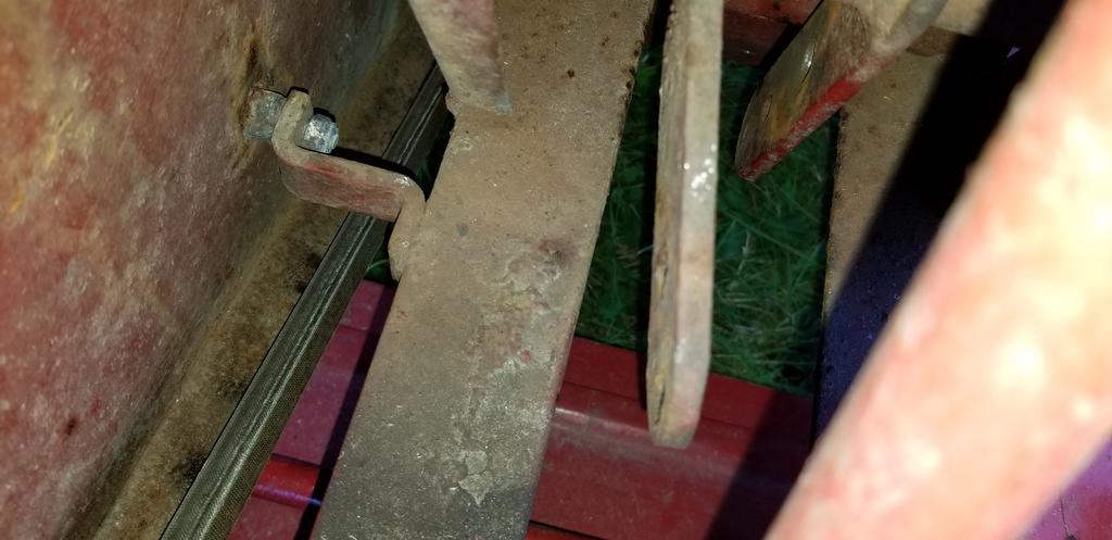

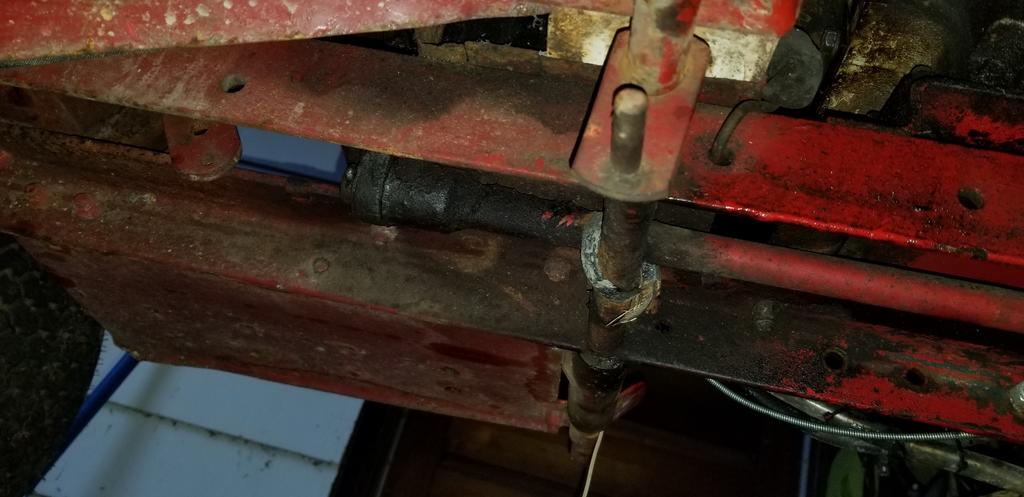

JAinVA 4,619 #20 Posted September 23, 2018 These may be redundant considering some of the other pictures posted but I hope they may help.The first shows where tachmatic plates mount to the frame.The second shows how all the assorted parts are located.The last 2 pictures are of the mounting the t-bar. 1 Share this post Link to post Share on other sites

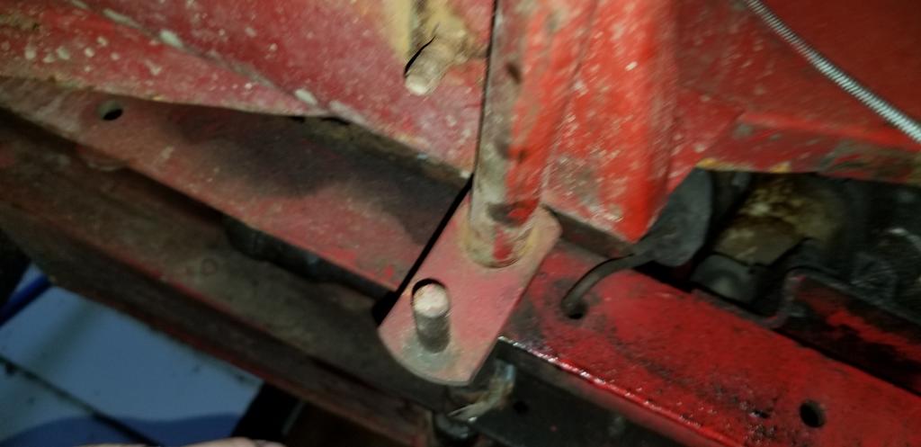

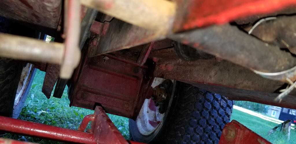

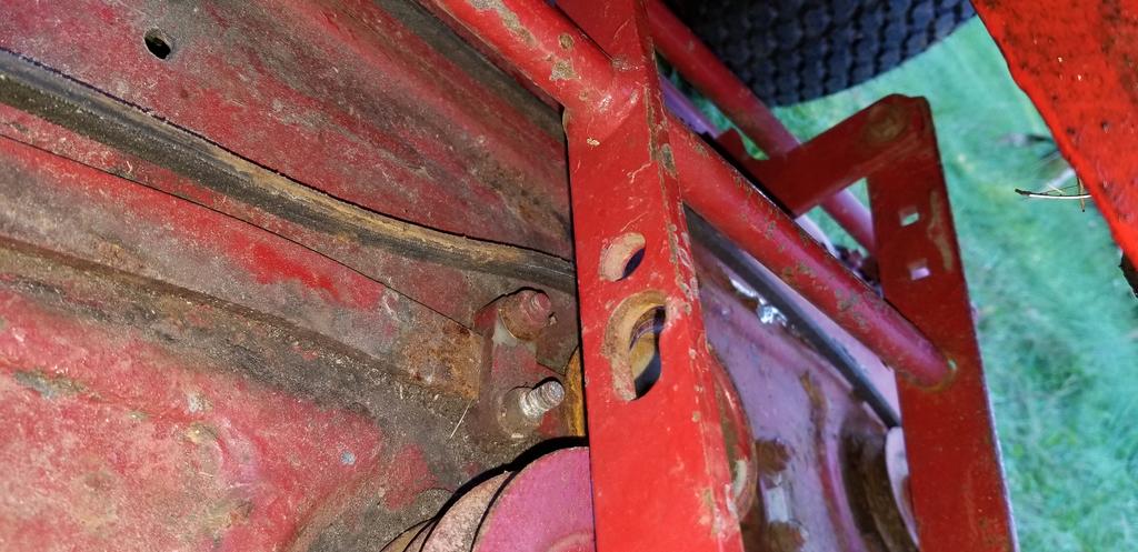

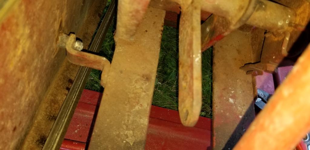

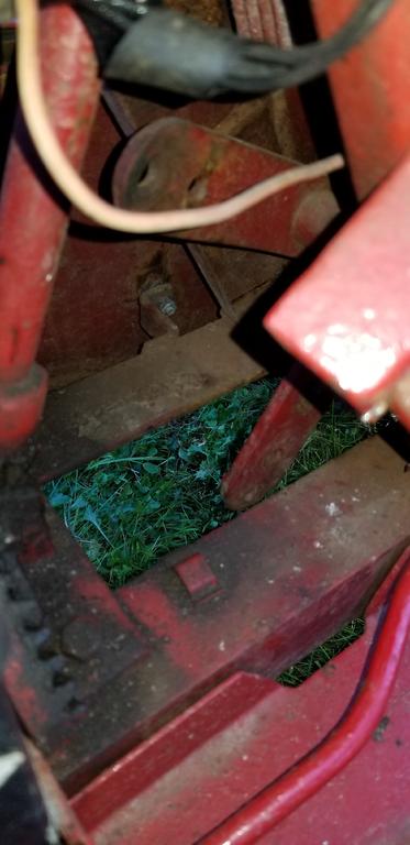

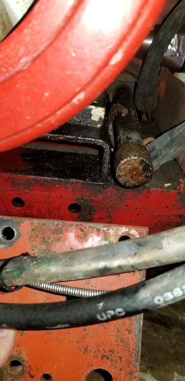

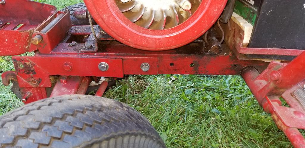

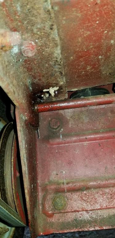

SimonC 35 #21 Posted September 23, 2018 Well, looks like I don't have the frame for the T-bar. Attaching pics, other than the brake/clutch pedal bar, not much else. If you guys confirm I'll move forward with the chain only installation method. On one of the picture, there is a small free to move plate with a pin, this is dangling off the lift lever horizontal bar. It's under the "passenger side" foot rest. Any clues as to what it is ? Thanks Share this post Link to post Share on other sites
SimonC 35 #22 Posted September 23, 2018 looking at the picture, it also looks like I have the wrong attach-o-matic plates for my frame pre-drilled holes. Share this post Link to post Share on other sites

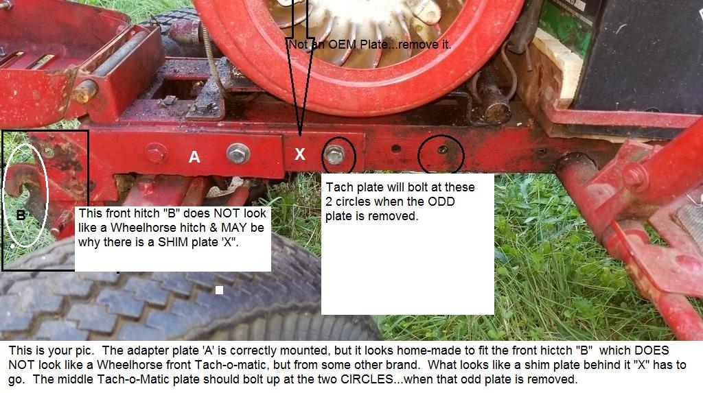

daveoman1966 3,745 #23 Posted September 24, 2018 I edited one of your pics and you have some issues here. First, the front hitch & adapter does NOT look like a Wheelhorse Front Tach-o-Matic hitch and appears to be homemade. Compare it to the GRAY hitch adapter in my earlier pics. and looks like the p.o. installed a shim plate "X" to make it fit. That shim plate is bolted on where the Middle Tach-o-Matic plate should be. As for the little 'dangly thing with a pin'... that is from the original side-mounted mule drive for the earlier Raider-mounted mower decks. It is an anchor point for a cumbersome cam / lever action of a belt tensioner. You can take it off if wanted...will only rattle if not. 1 Share this post Link to post Share on other sites

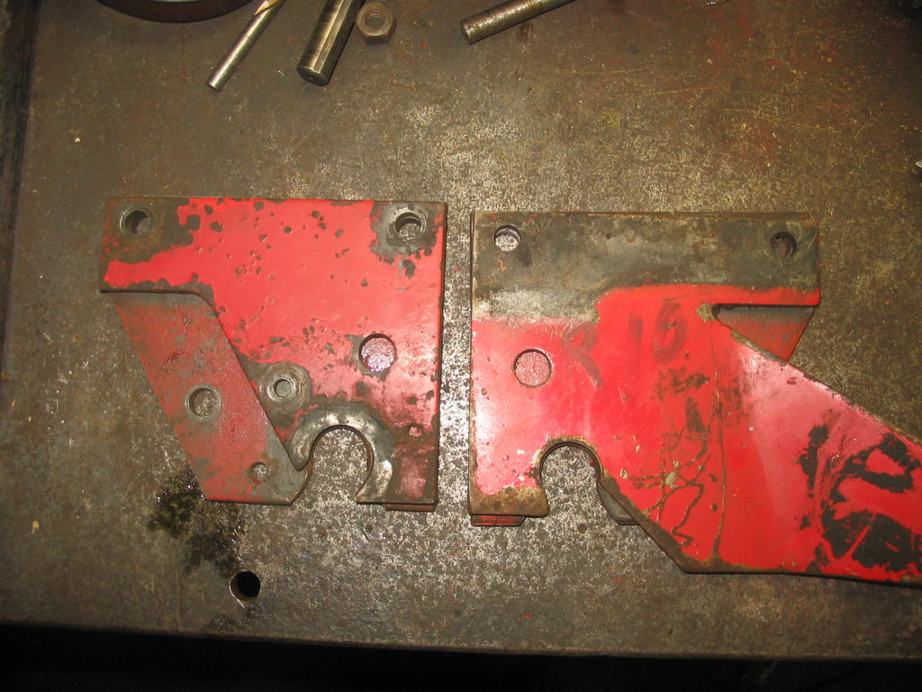

JAinVA 4,619 #24 Posted September 24, 2018 Dave I don't how much about any WH earlier than the c120.At first I thought that the tachmatic plate would bolt on once the X shim was removed.I looked again at the photos that SimonC posted and by comparing the tachmatic plate with the same frame screen shot the bolt pattern does not seem to match up.Since the Raider 10 tachmatic is very different than what followed is it possible the frame bolt pattern is different as well?/If so then the plates will need to be redrilled or the frame. Share this post Link to post Share on other sites
daveoman1966 3,745 #25 Posted September 24, 2018 (edited) I have the original style Raider 10 hitch plates and will size them against the newer TRach-o-Matic plates. The bolt pattern is the same...at about 4 inches on center. Take that 'X' plate completely off and you'll see the holes...they'll be n 4" center for the side plates. Edited September 24, 2018 by daveoman1966 Share this post Link to post Share on other sites
