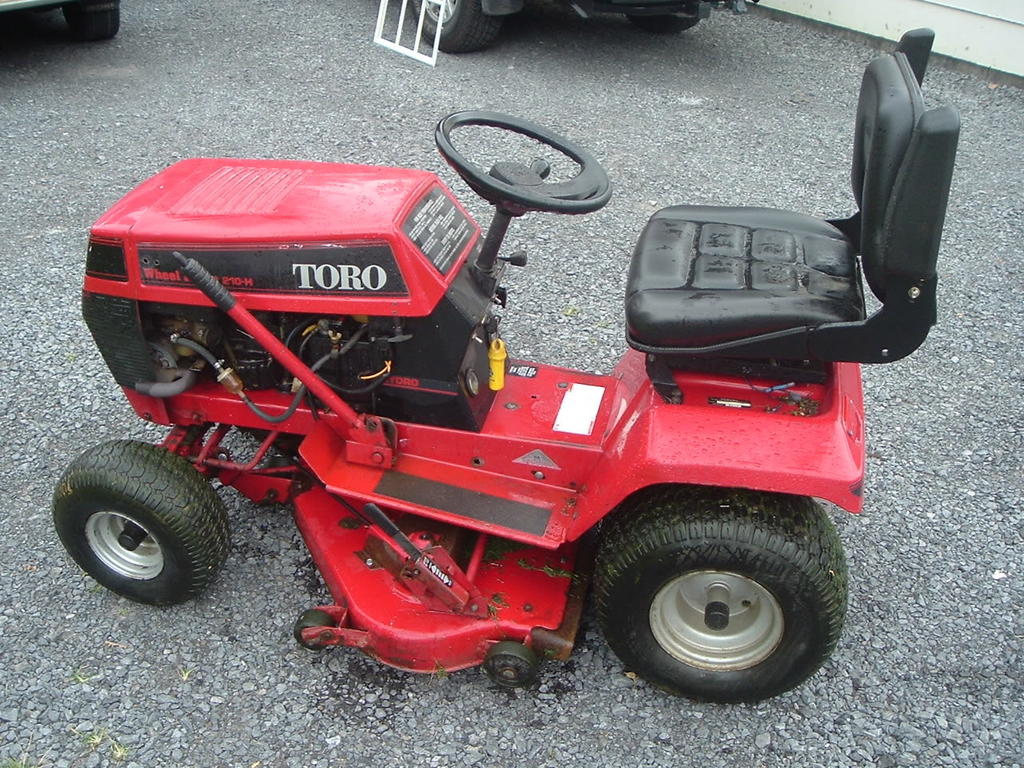

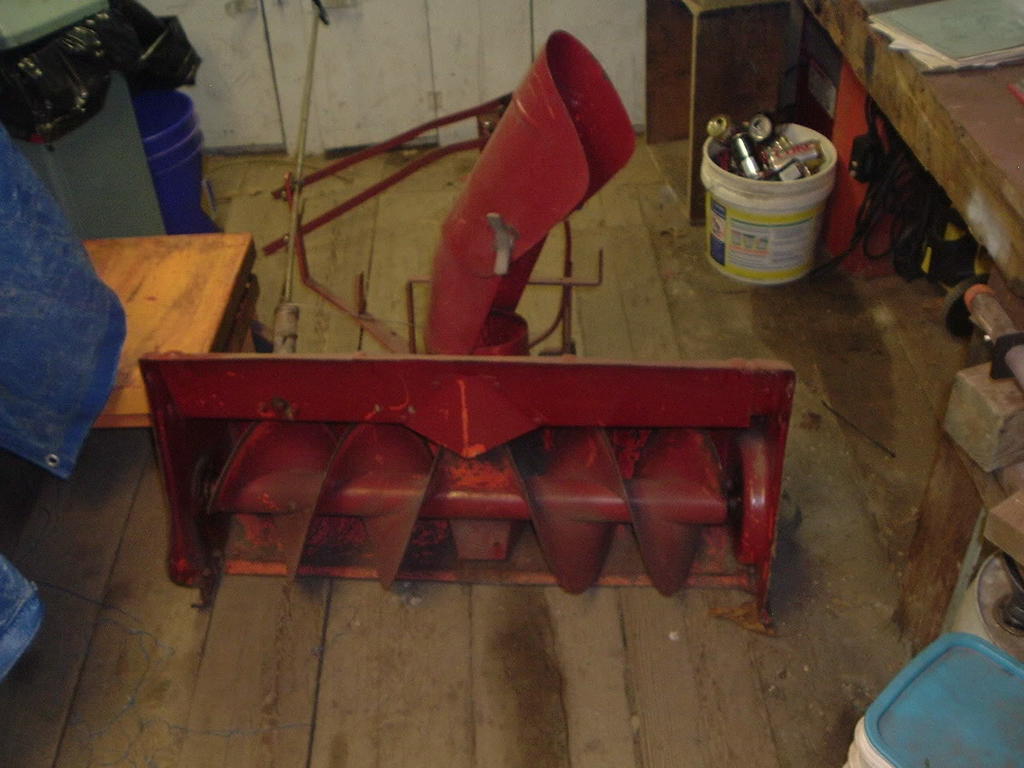

With enough time and effort you can make anything work. I mounted this horizontal shaft Allis- Chalmers snowblower onto this vertical shaft 200 series Horse.
