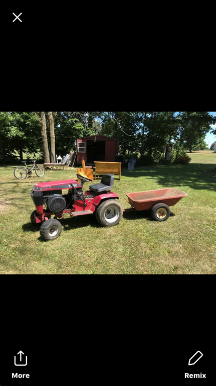

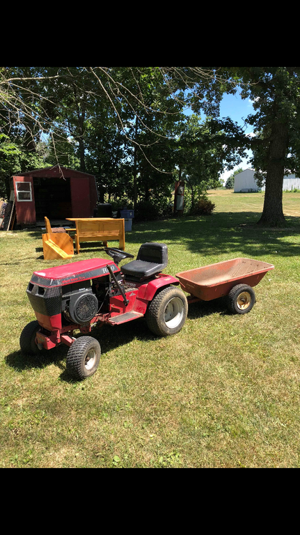

Dakota 70 #1 Posted September 19, 2018 So after selling my 73’ 8hp no name for $800 (I didn’t want to sell it but for that price I was happy too 😁), I bought a 310-8. I don’t know much about the newer ones so any info on it would be great. First off, how durable is the trans? I know it only has the 1in axle but I was hoping I could still tow some pretty heavy trailers with it, second it has the Kohler Magnum 10. What is the difference between the magnum and the older k241? And 3rd, it runs great at high rpms but when I lower the throttle it dies after idleing for about 25-30seconds. Over all I’m pretty happy with it so far and I noticed a HUGE difference between the 10hp and my previous 8hp. Using the 42in deck that came with it, it mowed great even in some pretty tall stuff. I’ll include a few pics that the previous owner had in his ad and add some more later when I get off work. 2 Share this post Link to post Share on other sites
