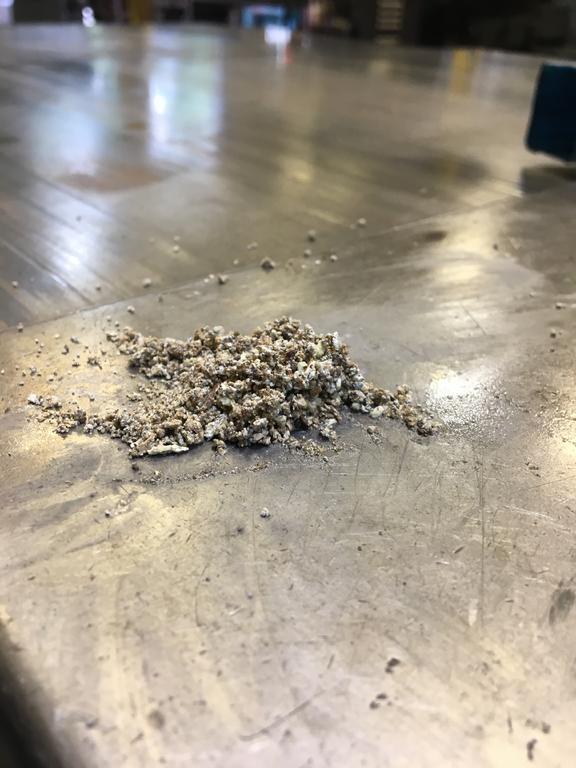

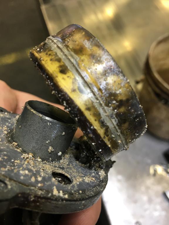

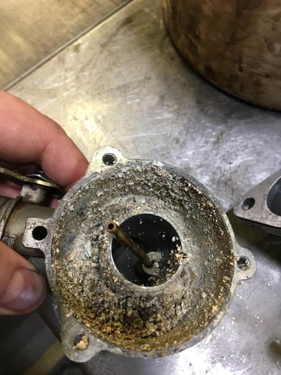

Machineguy 877 #1 Posted September 14, 2018 (edited) View the pictures and understand this could be your carb resting with ethanol in it! Edited September 14, 2018 by Machineguy 3 4 Share this post Link to post Share on other sites

JAinVA 4,619 #3 Posted September 14, 2018 Had a carb on a new Briggs ruined in less than two months because of ethanol.Never again.Ethanol free is all I use in the air cooled non computer engines.I'd run it in the truck but it's a flex fuel and should deal with the corn squeezings.Dumbest thing Uncle Whiskers ever forced on us. 1 1 Share this post Link to post Share on other sites

Machineguy 877 #10 Posted September 15, 2018 12 minutes ago, JAinVA said: My generator is on standby in the shop.One thing I do when it is time to put it up is drain the fuel tank.Start it up and let it run until the fuel is exhausted.If your FIL does this you shouldn't have any issues the next time he needs it.You probably would do that but he may need to be informed.Just show him this post if he doubts you. He said it was ran out of gas a couple years ago? No telling the actual time. The tank was spotless but the updraft carb was trashed from ethanol accumulating moisture. I got everything working correctly and it’s running great at a hefty load now. This has been a reality check about ethanol I suppose 1 Share this post Link to post Share on other sites
