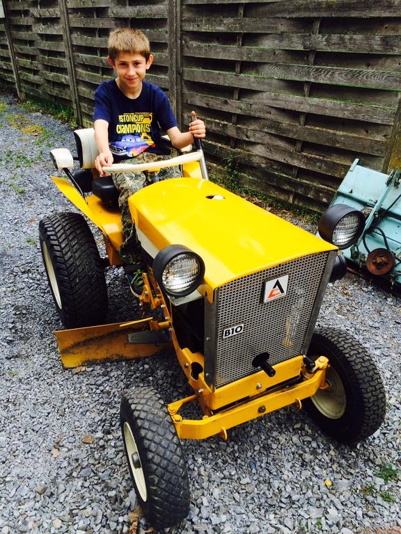

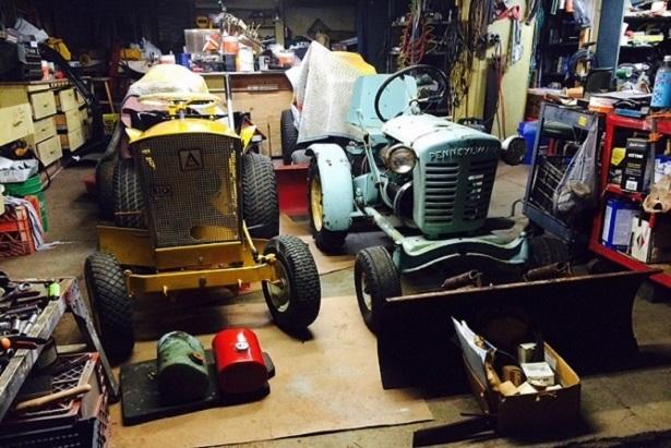

My AC has a heavy mid-mount grader. I often push the grader down with foot / leg power! Nice attachment, the blade is 1/2" thick!
The B-10 I upped to a 16hp. The B-10 is now on four ag donuts. The blue deck in the image is my Pennsylvania Panzer.
I have a spare 42" dozer blade, complete, that I don't use. Thinking of cutting the frame and blade, fab a mid-mount?
But then, the snow blade is only 16 (maybe 14) gauge CRS. Not beefy enough.
Think the mid-mount is best. Leg 'push' power is good. :handgestures-thumbupright:

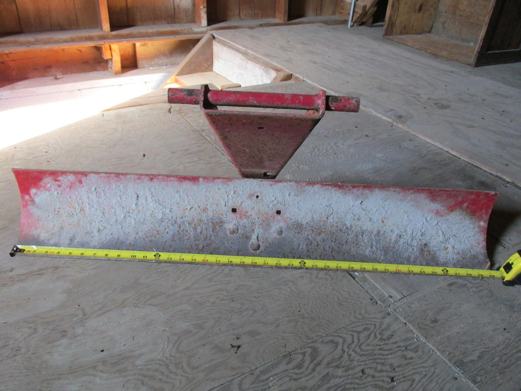

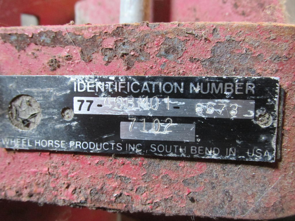

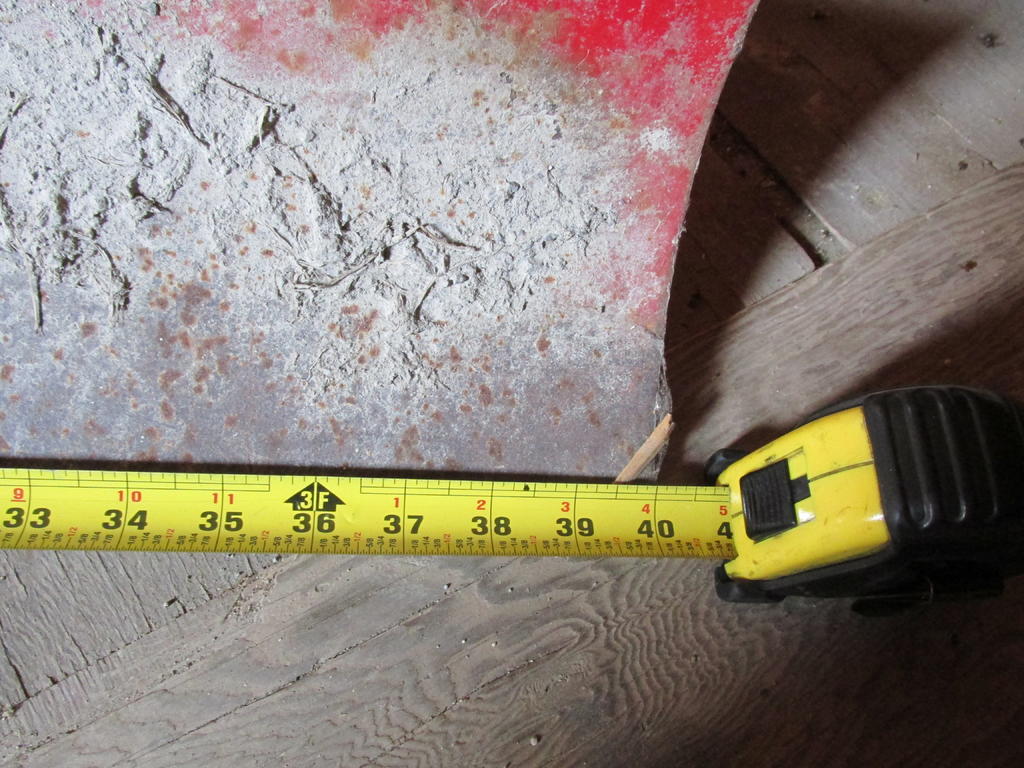

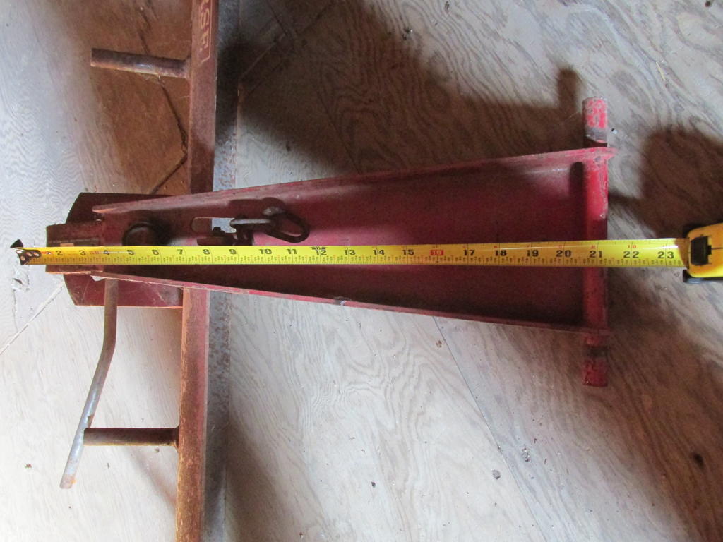

I have a mid-mount grader for my WH Model 1-7235 Charge Electro 12. If you will tell me what measurements you are looking for, I will drag the thing out of my shop loft, take measurements and send you some pictures.
