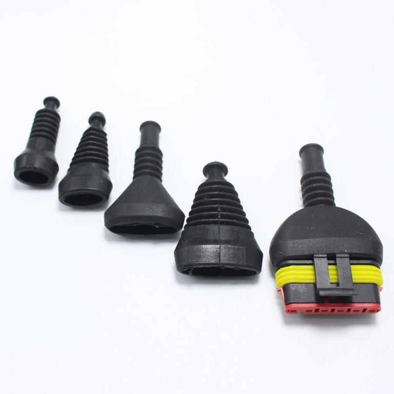

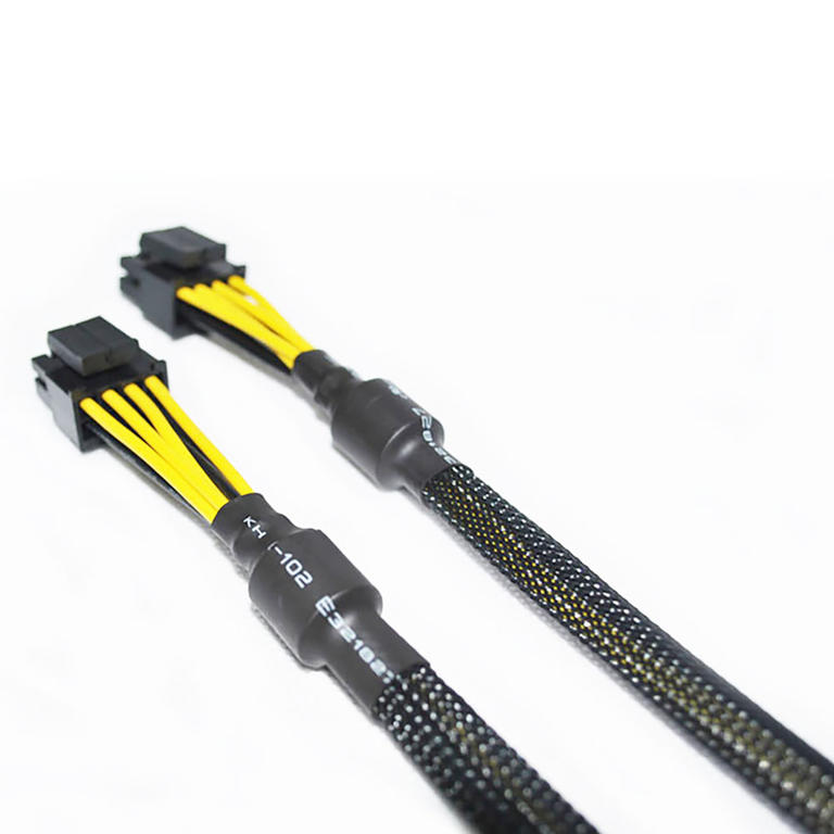

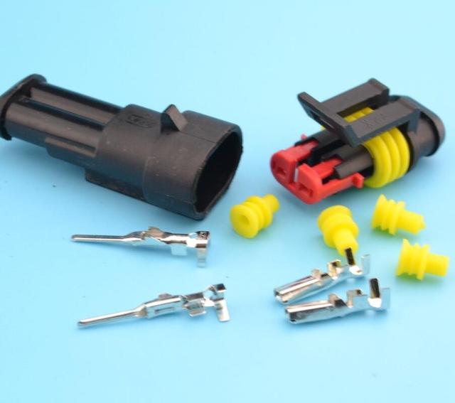

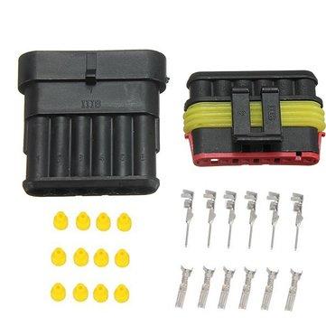

Skipper 1,789 #19 Posted September 14, 2018 (edited) You can get waterproof automotive connectors for the areas where you want to be able to take things apart again. You can get them to suit most any number of wires in a bundle, and they come rather cheap too. Chinaman whoflowdung sells them for almost free............. My rule of wirering is always to solder everything, and then glue type shrink wrap on everything that ain't getting watertight connectors. Get wires into self tightening automotive style wire sock, and do the ends with more shrink wrap. Corrosion proof the connectors inside before mating, and likewise on all the other connections. On the wire gauge side of it, only one rule applies in my shop. Smaller will hurt you, and bigger is always better. Go as big as you like, without it being ridiculous. Just don't ever under dimension wires. That's where bad stuff starts to happen. Things in general tends to be made from parts that is not exactly over dimensioned, but more likely juuuuust adequate. That most often also applies to the wirering of things too. No harm in stepping up the game a notch, quite the opposite in many cases. Edited September 14, 2018 by Skipper 2 1 Share this post Link to post Share on other sites

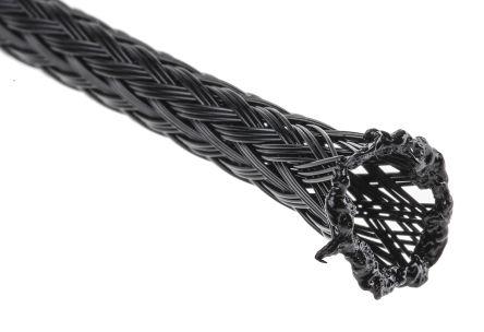

Skipper 1,789 #24 Posted September 16, 2018 (edited) Well I'm kind of going all the way on it, and some may feel it is overkill, but this way leaves very little room for failure, also over time. Just so you know. Let me see if I can show you and explain. Yes, every terminal, crimped or otherwise is soldered, then sealed with the glue type shrink wrap. Not the standard stuff. That's only good for the sock imo. Don't know if you are familiar with the glue type, but to clarify, it has an inner lining of glue, that melts when shrinking, sealing the wire end completely. Also the pins inside the connector terminals are soldered to the wire. The self tightening wire sock is the type I like to use, because it holds everything nice and tight. You may want to strengthen it with shrink wrap on rub on points. Self tightening may be a wrong word for it. It's called braided expandable wire sleeve i think. It works the way that it has a dimension in relaxed/tightened up state. then if you push it together, it will open up the diameter, and tighten around the wires when you slide it back again. It WILL come apart in the ends, so that is what the shrink wrap in the ends of the sleve does. Hold it together, and makes a nice finish. Burn the ends a bit before feeding wire to the sock. They come in many size and shapes, and they cost peanuts. All connectors, sleeve, wrap etc for an entire WH loom is max 10 buck (probably less), if you buy it the right places. Here's a few pix of some of what I use on wire loom jobs. The connector rubber boots gives a nice finished look to it. Shoot if you have questions Edited September 16, 2018 by Skipper 4 Share this post Link to post Share on other sites
ebinmaine 70,733 #25 Posted September 16, 2018 2 hours ago, Skipper said: self tightening wire sock is the type I like to use, because it holds everything nice and tight Great idea. What's your source and what size? That's why I use 7 conductor trailer wire harness. 7 different colors. All wrapped for their protection. If I need a separate piece or pieces I disassemble a couple feet. 1 Share this post Link to post Share on other sites
