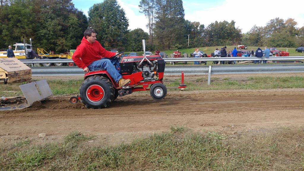

fast88pu 3,324 #15 Posted November 18, 2018 On November 4, 2018 at 1:32 PM, TonyToro said: Nice! I am really impressed what these tractors can do! We just trying something new and to get the edge on the competition. Lol We are trying to keep maximum strength and deliver the most power to the tires. These tractors were only meant to do limited work. Pulling is really pushing what the tractor was designed to do. The nice thing with Wheelhorse is that the weak link is either the belt or keyway in the axle. Our newest tractor is a 14hp engine with lots of engine work. I am going to do some more work to it before next season and have it dyno'd. We are thinking it should be around 22hp when dialed in. We pull in 3rd gear at 4000RPM. So we need to get those tires turning. About 50hp 3rd gear hi at 4500 rpms 1 2 Share this post Link to post Share on other sites
TonyToro 1,085 #16 Posted November 18, 2018 5 minutes ago, fast88pu said: About 50hp 3rd gear hi at 4500 rpms Awesome! Nice machine! I really like the sound of a twin and over 4000Rpm is even better!lol Are you running quick change pulleys? I need to get an assortment of those for my sons new tractor. Is that a transfer sled? Share this post Link to post Share on other sites
fast88pu 3,324 #17 Posted November 18, 2018 1 minute ago, TonyToro said: Awesome! Nice machine! I really like the sound of a twin and over 4000Rpm is even better!lol Are you running quick change pulleys? I need to get an assortment of those for my sons new tractor. Is that a transfer sled? Pulling a transfer sled. Running stock pulleys. Stock wheel horse belt and stock single spring. Leaving at 2500 rpms and no issues. 1 Share this post Link to post Share on other sites
